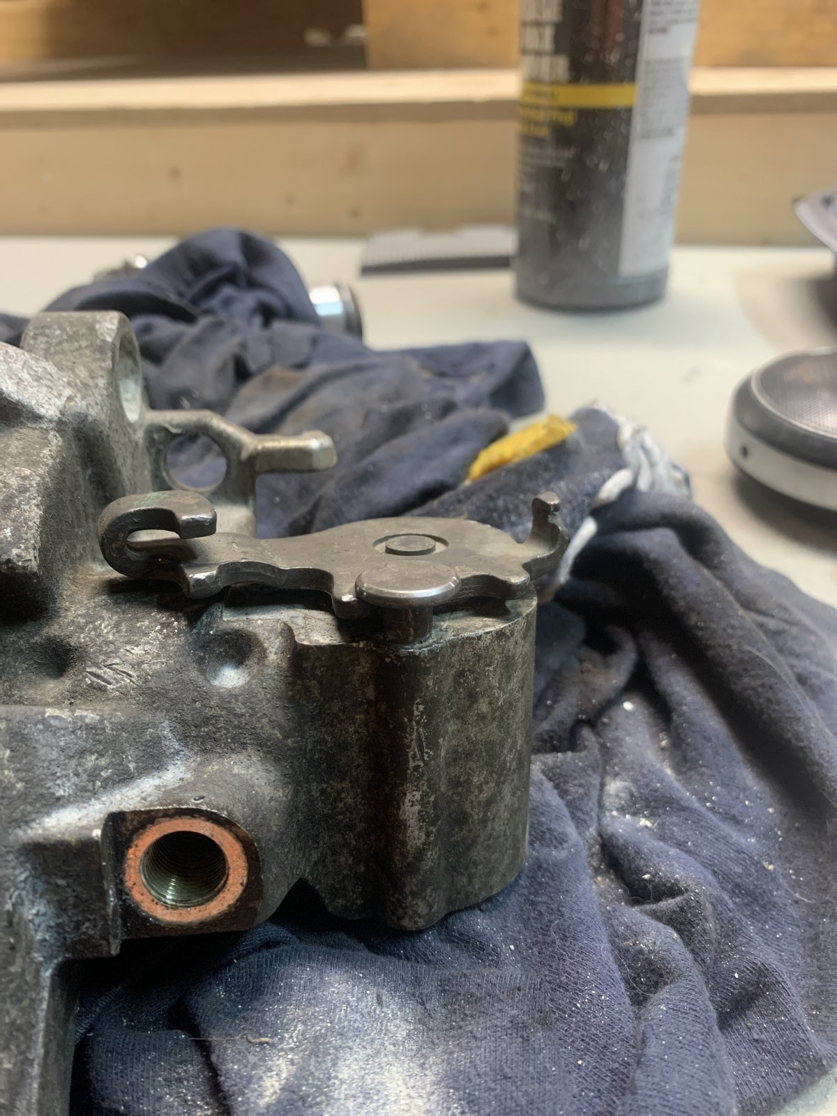

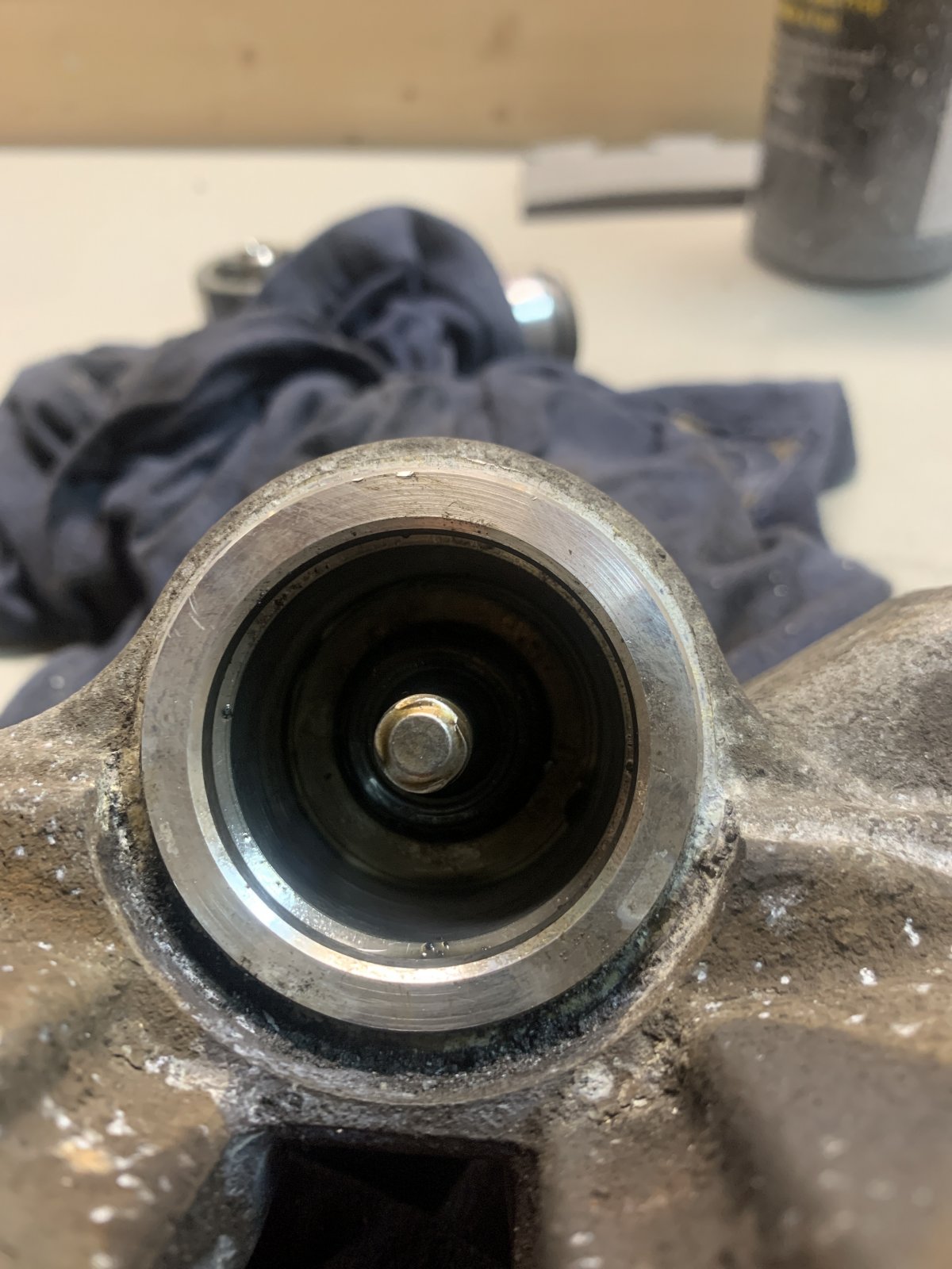

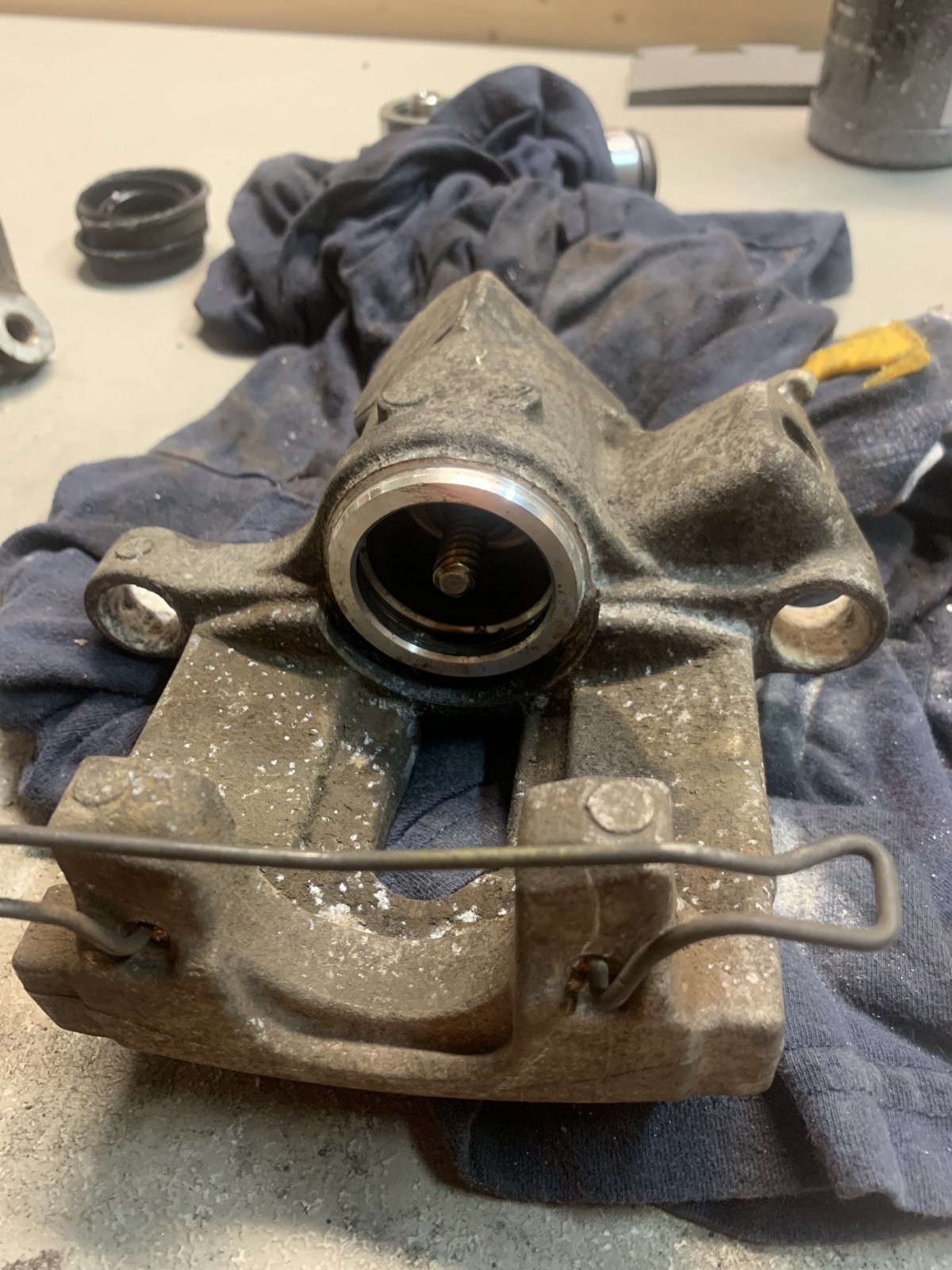

Hey guys I am trying to take apart my rear calipers and having some trouble on what to do next. With the pictures attached, I remove the piston, seal and dust boot. I have never attempted a caliper with the parking brake integrated into it and don’t know what other seals need to be removed before throwing it in the 400degree oven. Normally there is a nut on the bracket that holds the cable and can be removed the pull the parking brake inners. This seems like these calipers have them stamped in? Maybe powder coating is out of the question? Has anyone attempted this before? I know there is alternatives to power coating like G2 epoxy which I might look into but I have powder coated couple sets of calipers in the past on my old cars and just like the product. I wouldnt mind some feedback on someone that has used both power coating and g2 paint to see what they thought of it. Any help out be great. Thanks!
The calipers that we have had powder coated were done with the pistons still installed. The only thing we removed was the bleeder, banjo bolt and we separated the bracket from the caliper.
The powder coater can mask the piston and anything else that should not have powder coat on it.
There seals in the caliper are good to very high temperatures, we haven't had any problems with the seals being damaged by the baking process.
