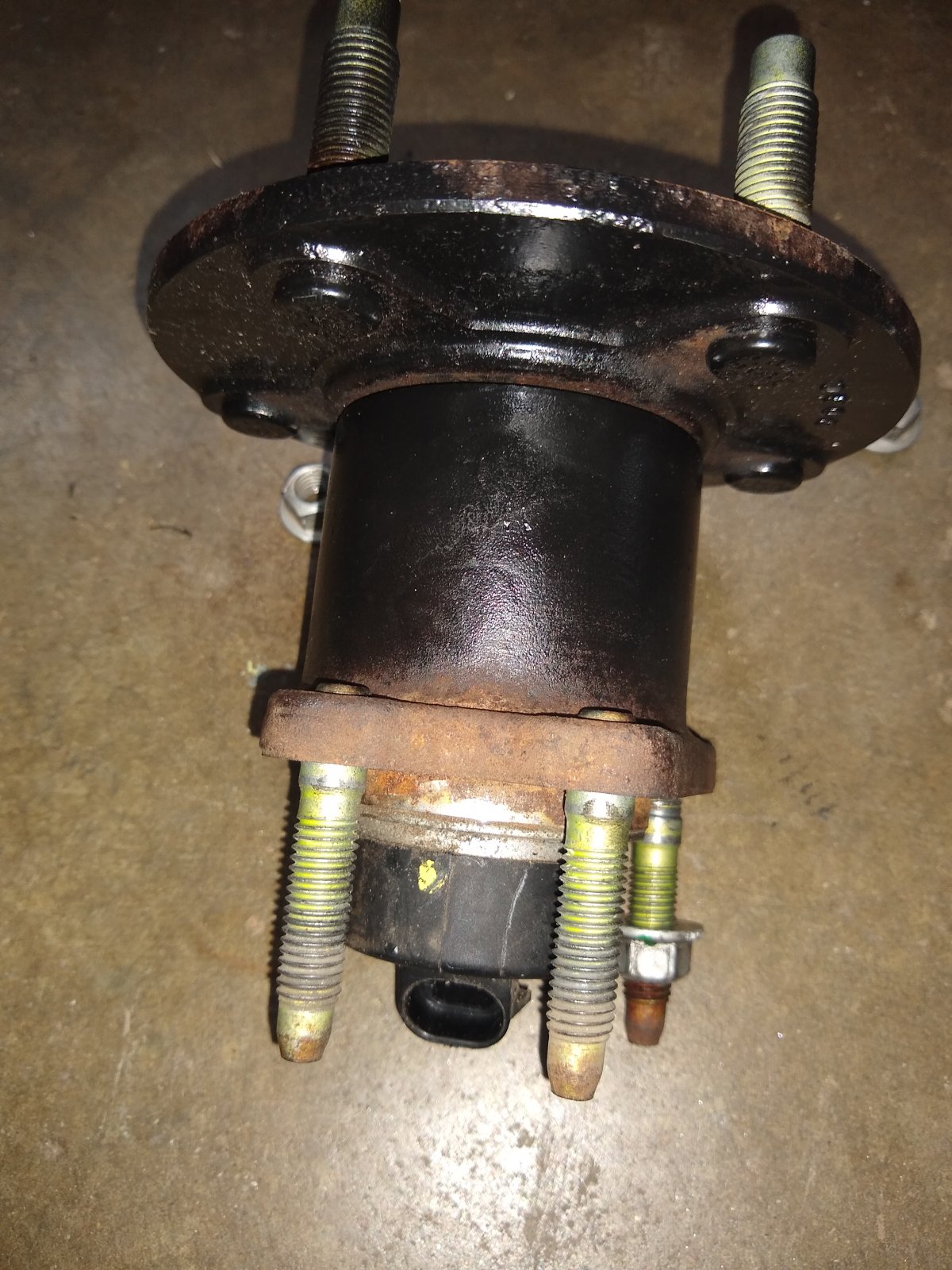

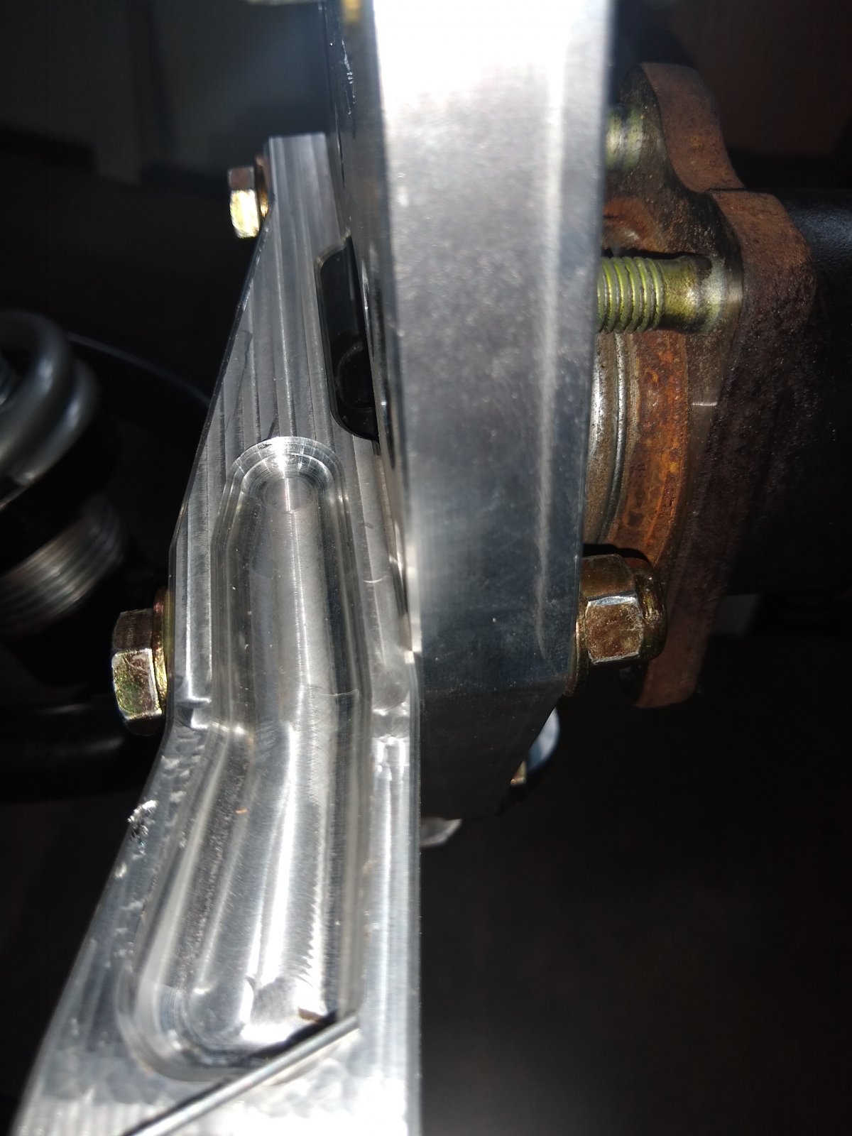

The donor hubs from the back for the front have some kind of sensor on them. Are they removable? They keep the hub from being installed on the uprights. 16073671230324141206605933731732.jpg

you have to remove that abs sensor and then cap the bearring, or order a set of hubs that don't have the abs sensor and use those. They're around $80-90 per hub from any autoparts store.
I used my sensored hubs. I had to cut the sensor off, but the hub still works as a bearing.
Adam can sell you some new caps so they don't interfer with the steering arm.
If you order new hubs, then get them without a sensor, but since you already have those hubs, you can modify them.
How did you cut them off? Just the sensor or the whole cap?
Also available are bearing hubs that don't have the sensor and have a nice steel cap that fits the hub uprights. Note, these are 5 lug hubs.
Where do I get such? I've been to O'reilly, NAPA, and Rock Auto. I can get 5 bolt with sensor or 4 bolt without.

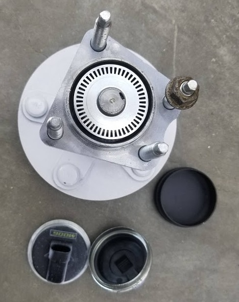

MOOG 512285 Wheel Bearing are 5x110mm hubs, just pop the ABS cover off, and put on the DF purchased cover on (lower right in image).
