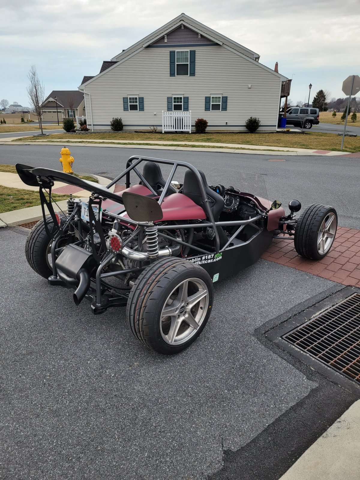

I used Flat Black rattle cans from Ace Hardware. Worked fine for me.
