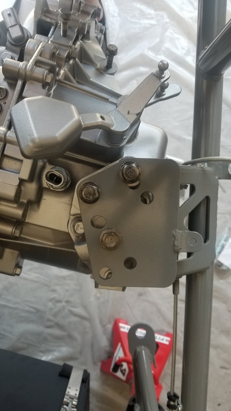

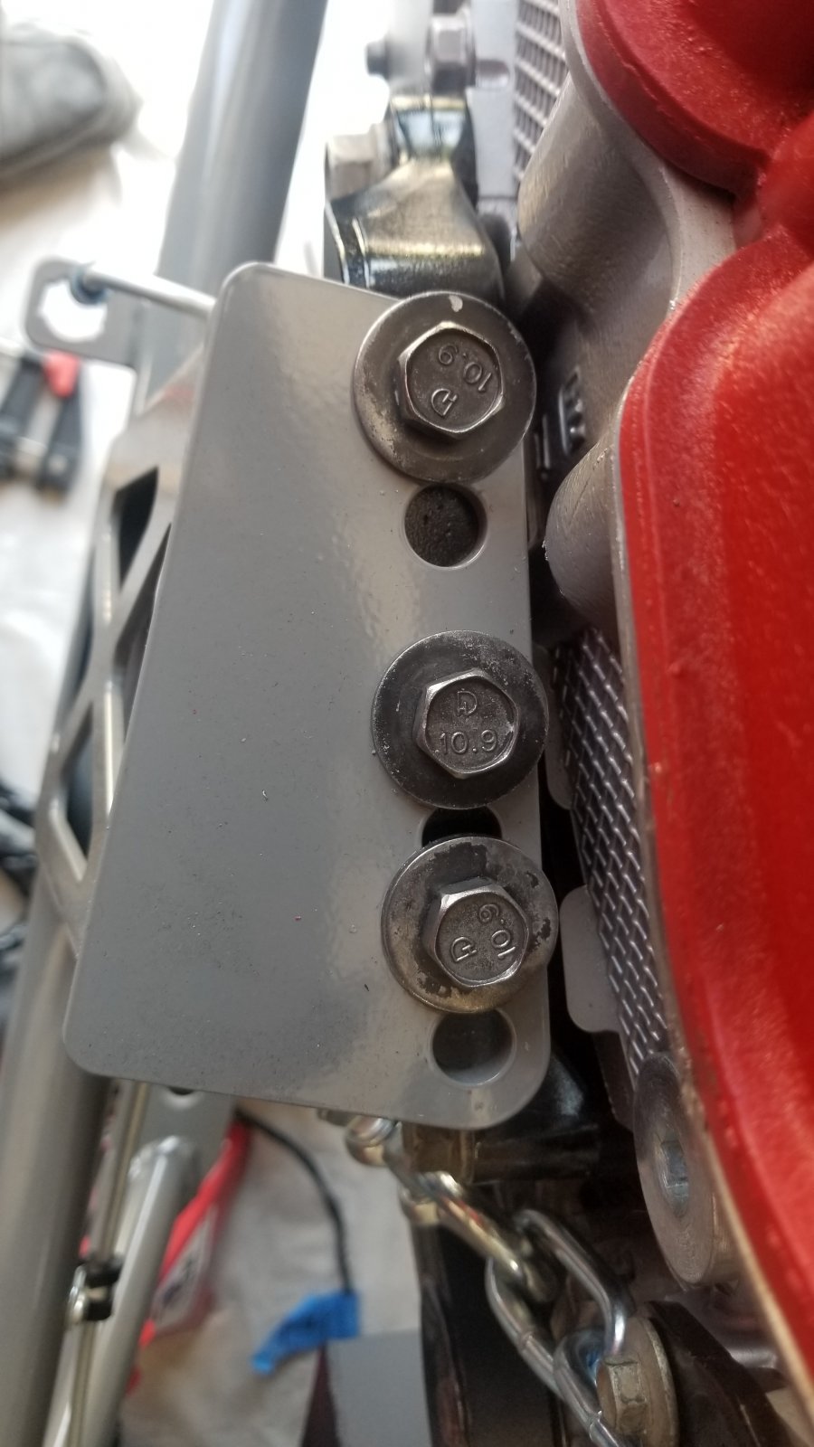

So question... why does the engine mount have so many holes? Also with a 2008 TC SS which holes do I use. I used the front 3 holes on the passenger side but just noticed the engine isn't straight. Can't find any info on correct mounting location.

In the grand scheme of things, the engine could be angled alittle, and as long as the spindles are square, the axles will even everything out right?
The stock axles seem to be particularly sensitive to operating angles, so getting the engine and transmission installed into the proper position - in the side mount holes - will keep everything aligned and happy. :)
