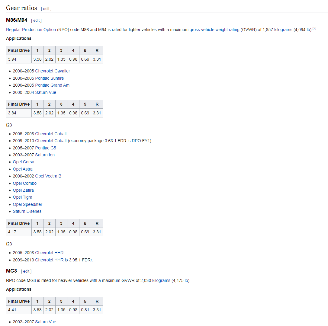

Picked up a Zero mile (new) F23 from DF while in TX last year. I cant seem to cross reference the bar code numbers on the trans to anything (61YEJ 08175961). What is the final drive ratio? Thanks !

I saw that but without a good number on the Trans that chart doesn't help. I believe I read somewhere it's 3.84 but can't find it anywhere. I need the trans ratio to set the speedometer properly.

Can you post a picture of the data plate from the transmission? The final drive ratio should be in the bottom right corner.
