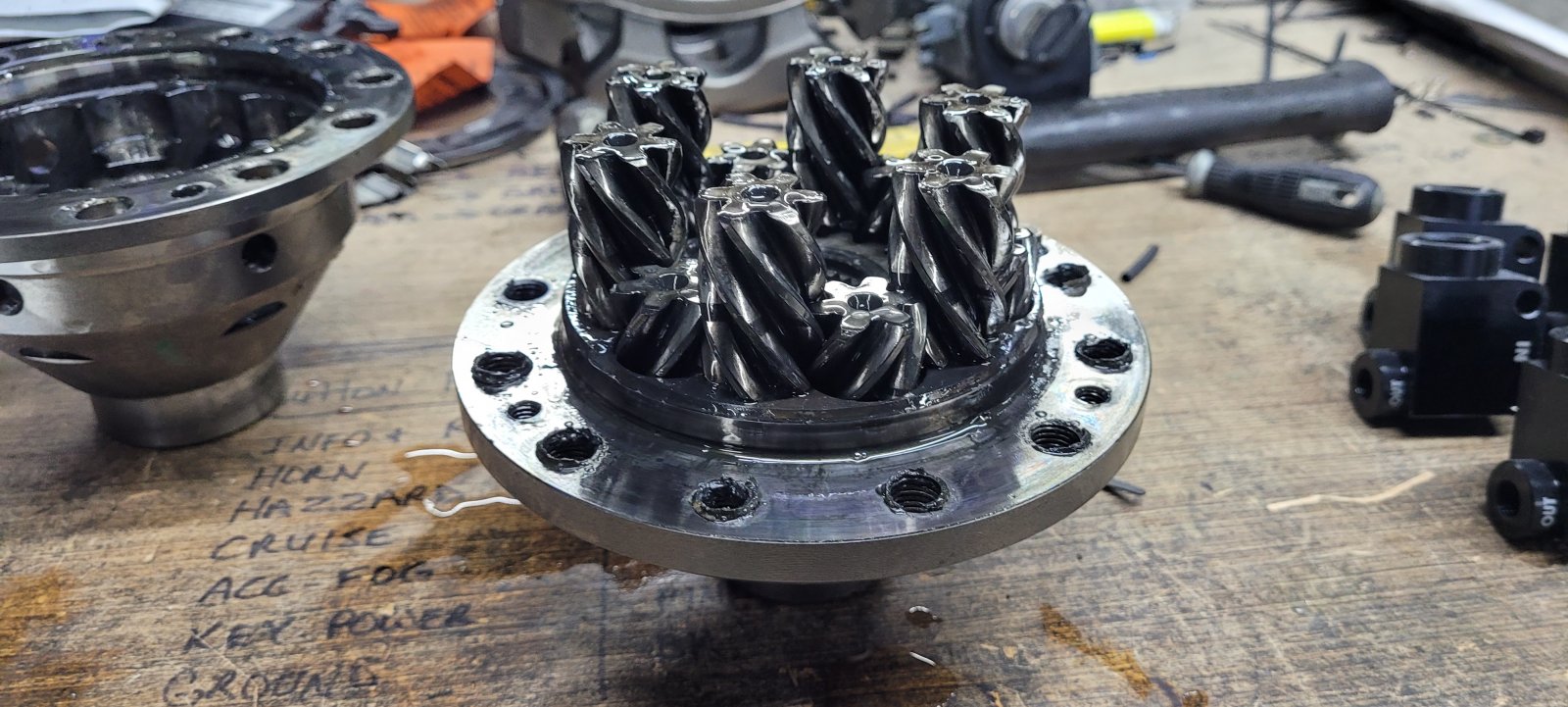

Really? I thought most GM LSDs have clutch packs, not helical cut gears. They work on different principles. Does someone know what kind of LSD is in the stock G85 equiped F35 transmission?
Well, ssyellow says you are correct:
The G85 is a ATB diff from quaife (ATB = Autmatic Torque-Bias)
I wonder if the G85 has the exact same differential that I can buy from Quaife, or if it was a custom version only made for GM?
Quaife differential from an F35.

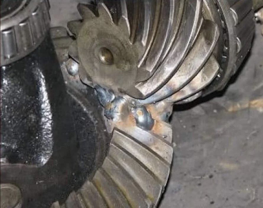

Turning with 100TW tires will likely tear up the axle CV joints, since those seem to be the most likely weak point in a (mostly) rigid drivetrain - if the spiders are welded. But great if you're only drag racing and not turning much. ;):cool:
