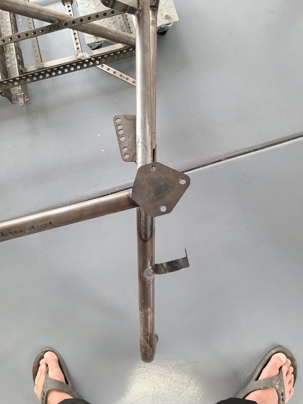

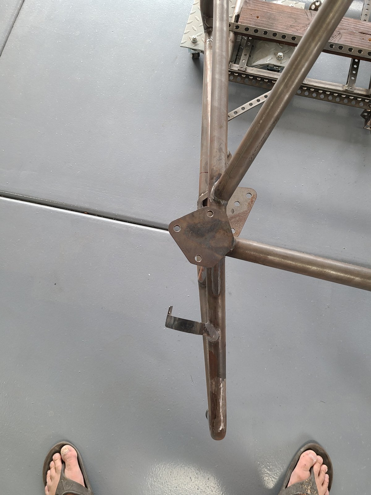

These 2 photos shows the change in angle of the passenger side (all tubes are straight and located directly above/below each other, versus the driver side showing how the top and bottom tubes have a 'kink' in them and the lower tube is actually further outboard than the upper tube.

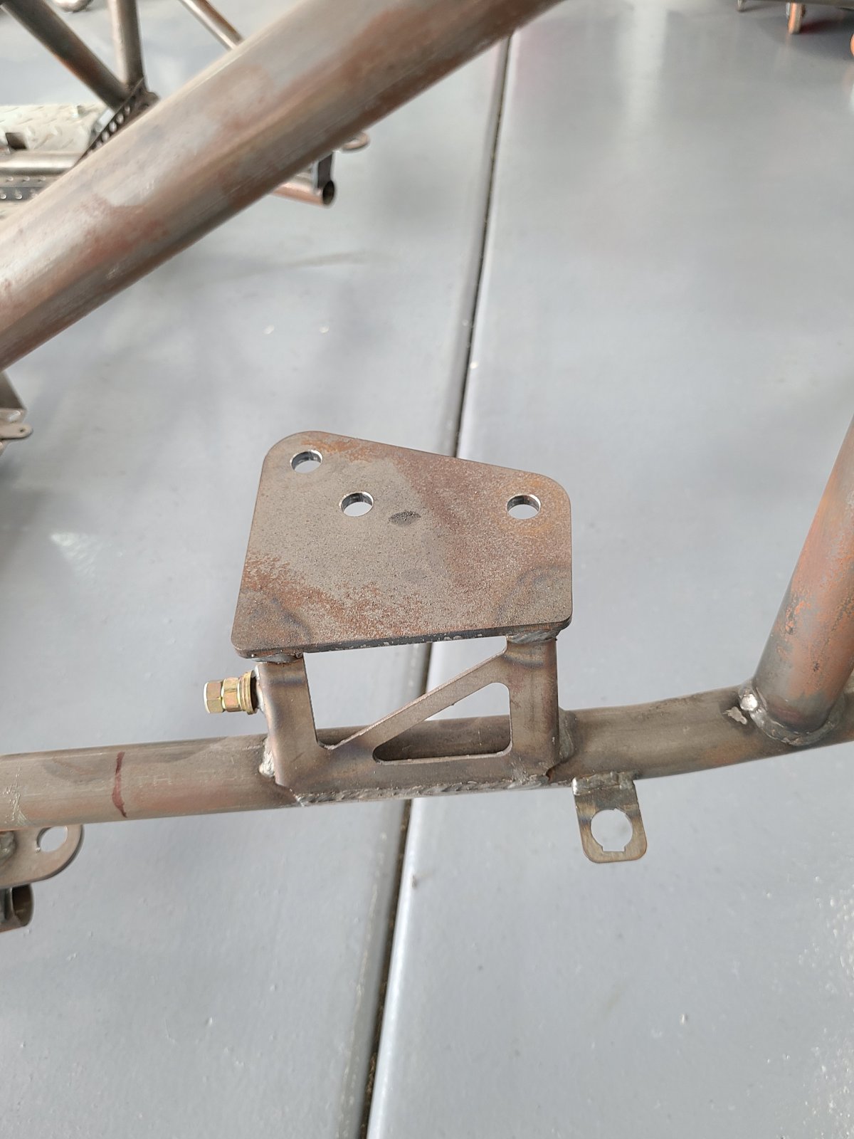

Also note the transmission mount is different than the F35/F23 mount. It sits a little lower and has a different bolt pattern.
