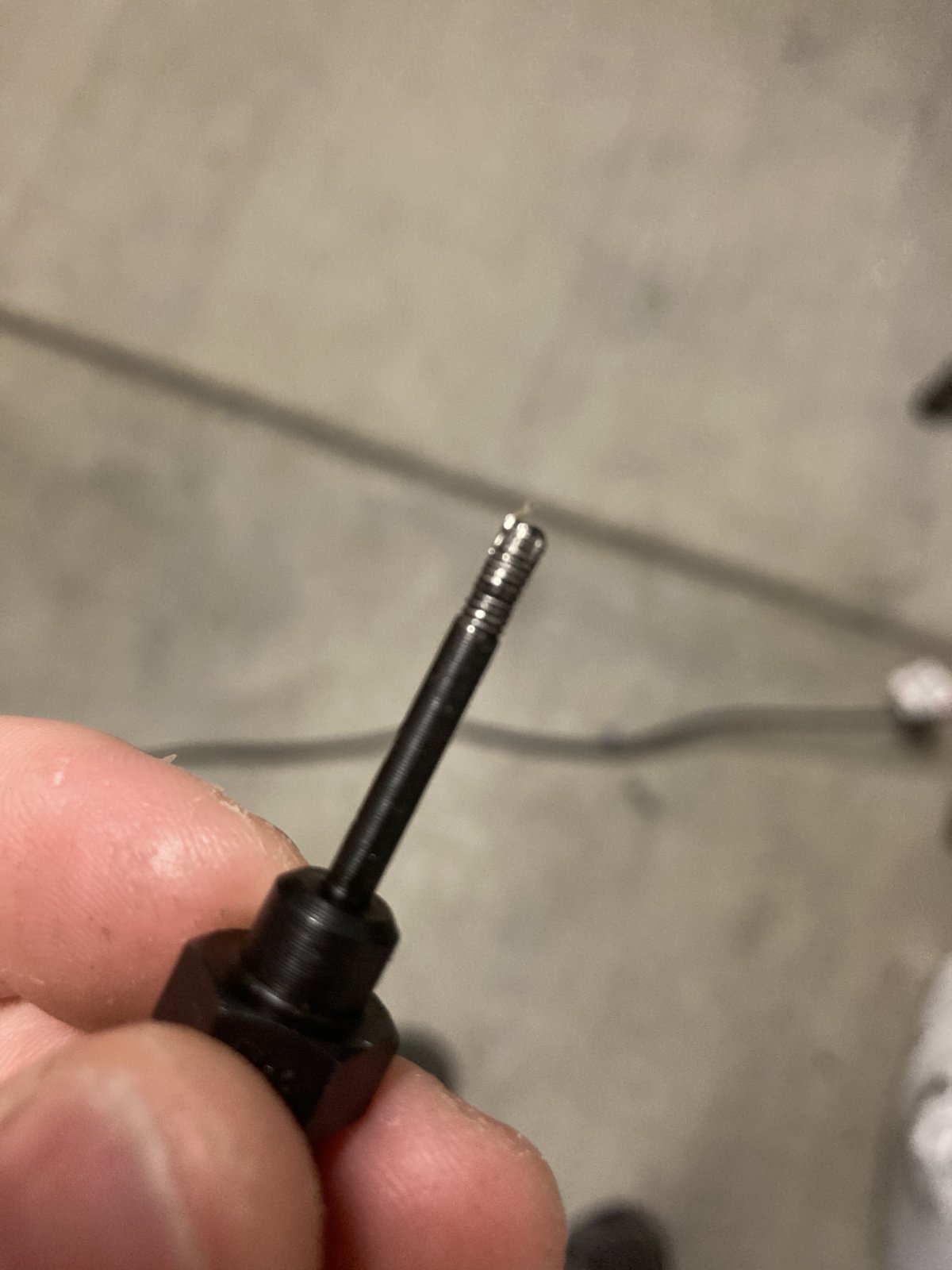

I didn’t want to have to enlarge the holes either. Only problem I’ve had is with the smaller steel rivnuts, is these cheap Chinese mandrels don’t get a good enough bite on the threads and end up pulling right through the rivnut. 3MM pictured.
