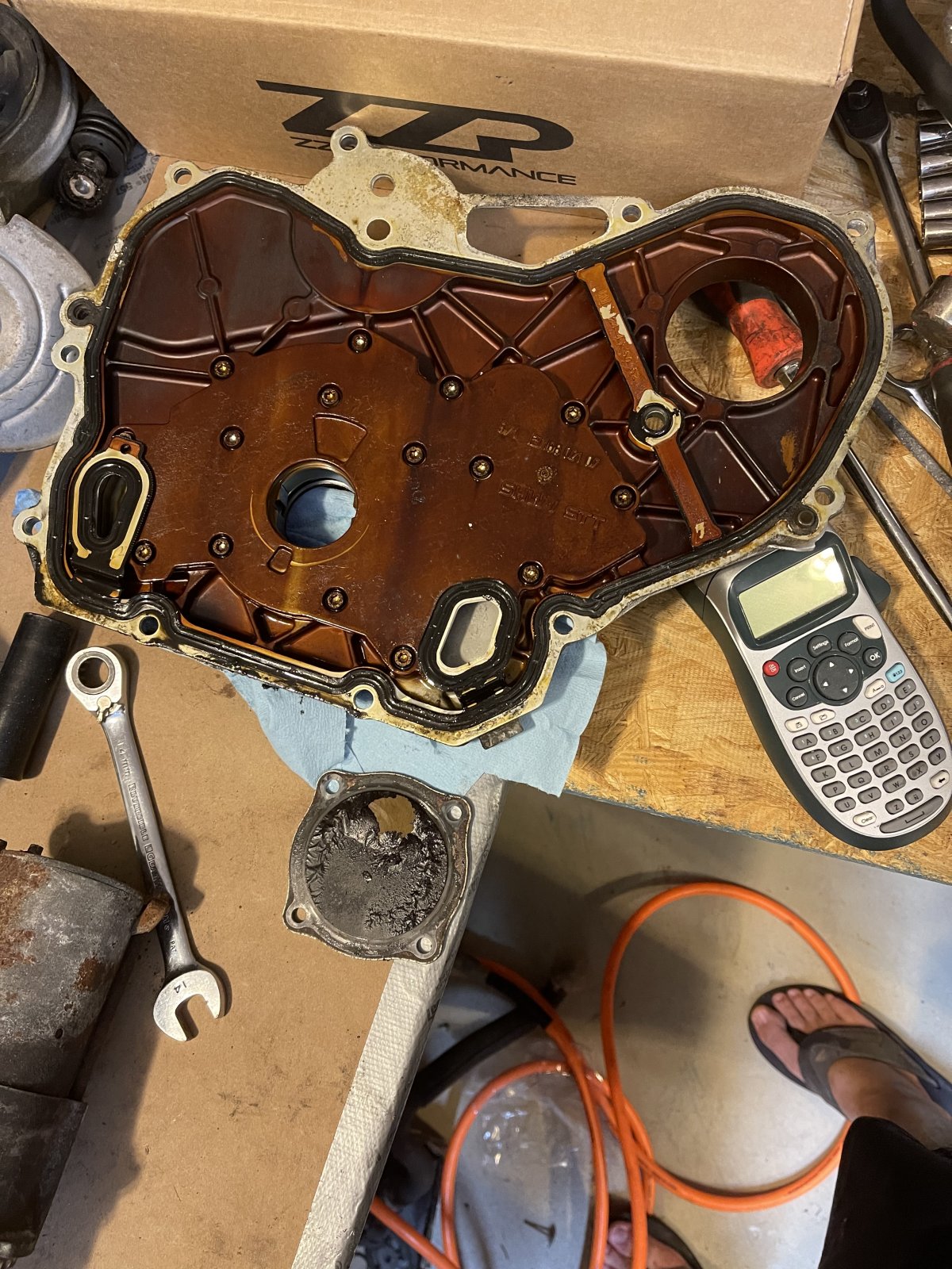

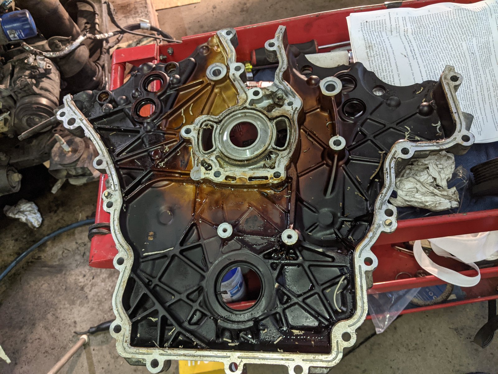

Pulled the front cover while cleaning up the engine. The cover looks like it has burnt on oil pretty good, same around the timing chain. Is that normal or something to be concerned about?

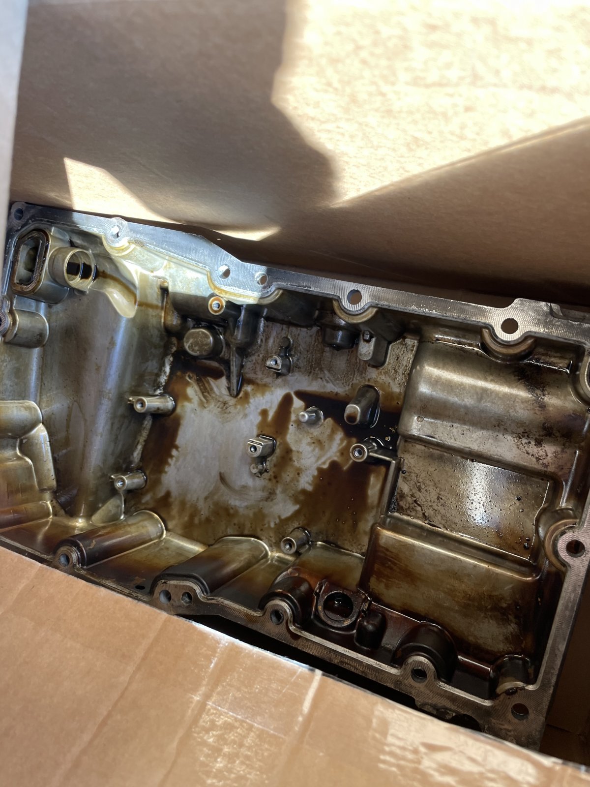

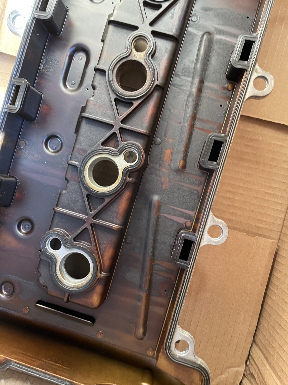

Pretty normal for a high mileage car to have an even layer of oil on it like it does. That cover though with it peeling like paint makes it look like it was neglected a few times on oil changes though.

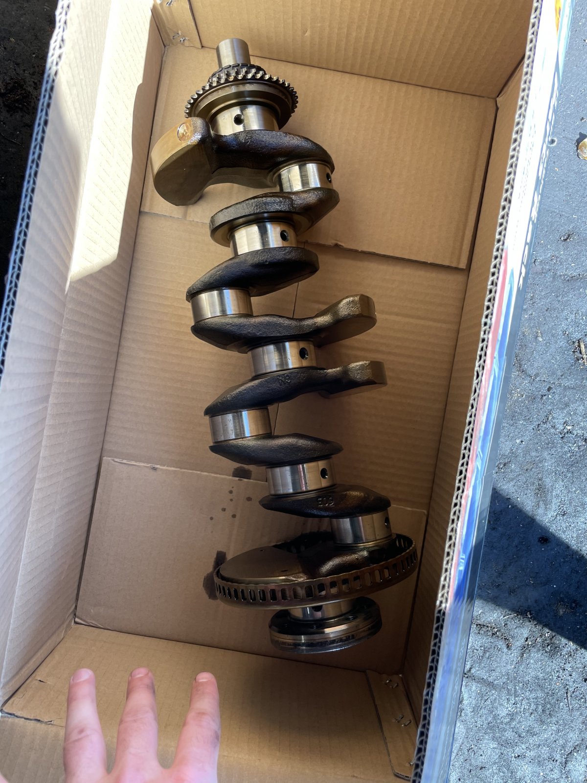

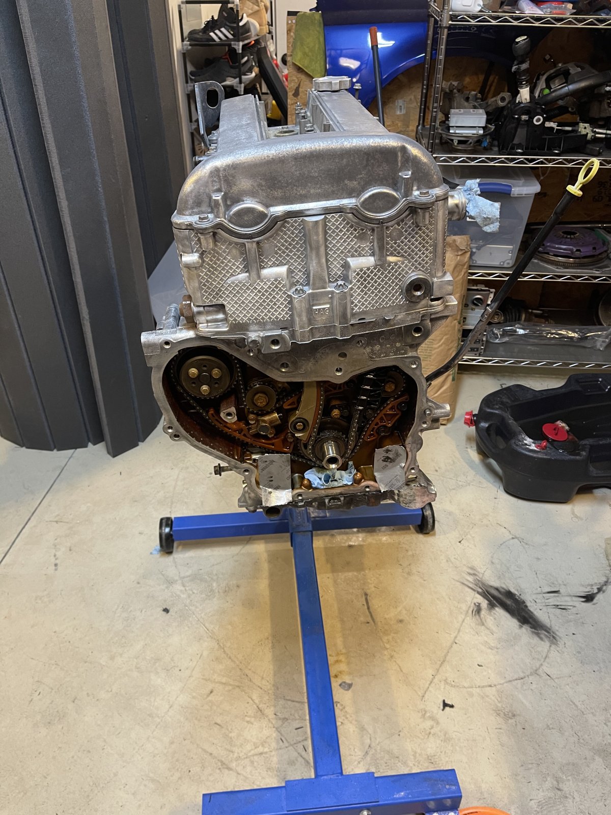

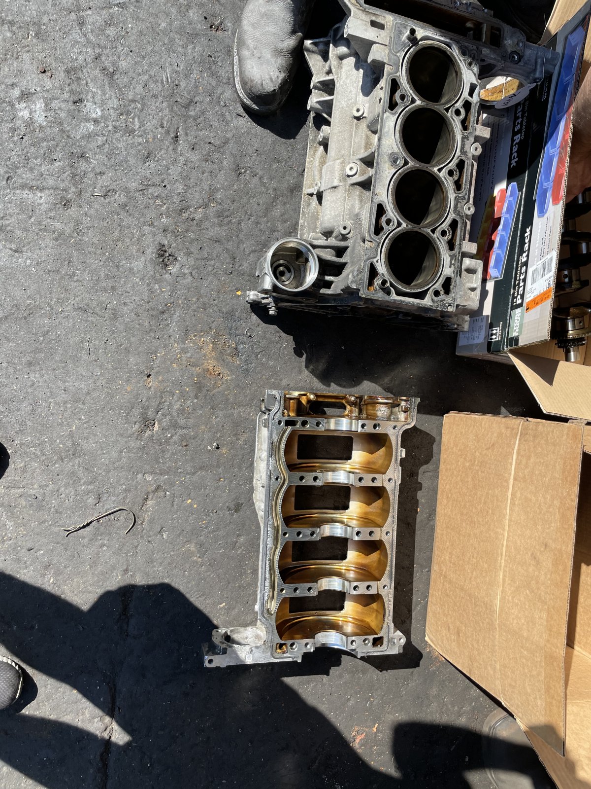

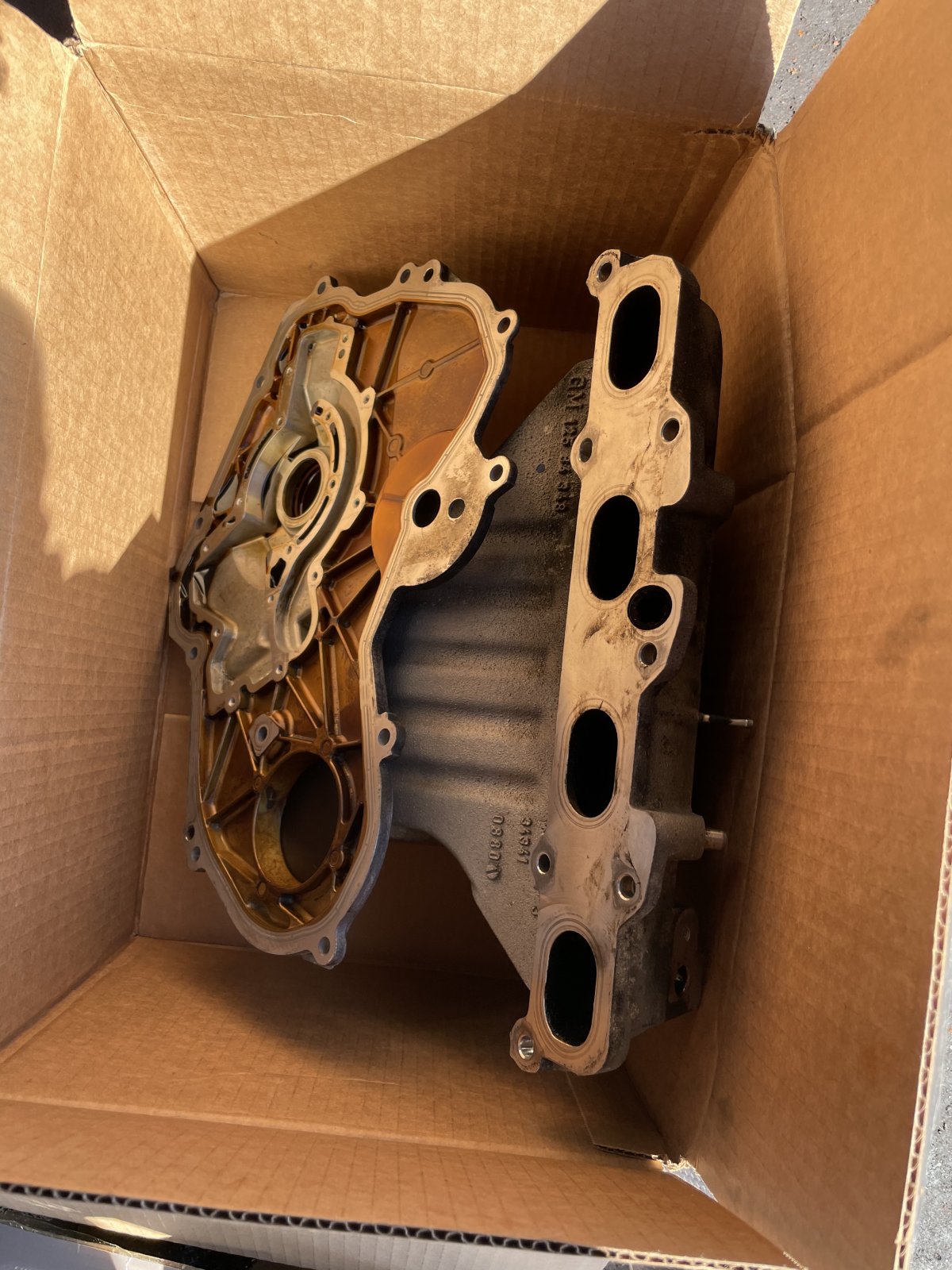

Here’s some pictures of my parts when I dropped them off at the machine shop to be hot tanked and jet washed. You can see the even layer of burnt on oil, but none of it is peeling like paint.

R
Yours should be fine none the less. If you don’t plan on doing a full rebuild, then it’s not worth the effort of a full tear down to clean the caked on oil.
jayrolls
Ok, not planning on a full tear down. I am going to replace the front cover and oil pump. The crispy part kinda had me worried. I think once it’s running again I will have the engine flushed or run some SeaFoam and try to clean it up some. Thanks.
TravMac
Compared to the gm high feature v6 i helped tear down last week, that cover looks spotless. Just make sure any of that flaking oil residue is wiped down before reinstall and you should be good. And keep running a good oil!
