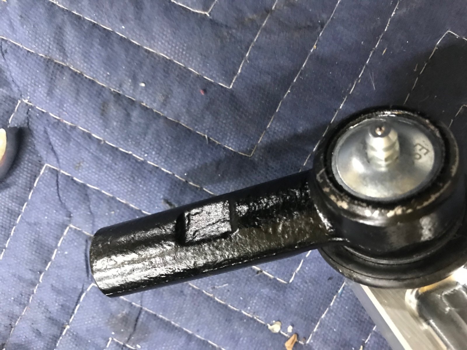

Went to torque the front Tie Rod Ends as per the video. It says 17mm to 50 Ft Lb's. Well it's not metric, it's sae, 3/4" I believe. It will do me NO GOOD to torque them down because the nut will not seat far enough to get the cotter pin in the hole. Unless I mixed something up these are the DF supplied "front" rod ends that came in the box in the picture. What am I doing wrong?

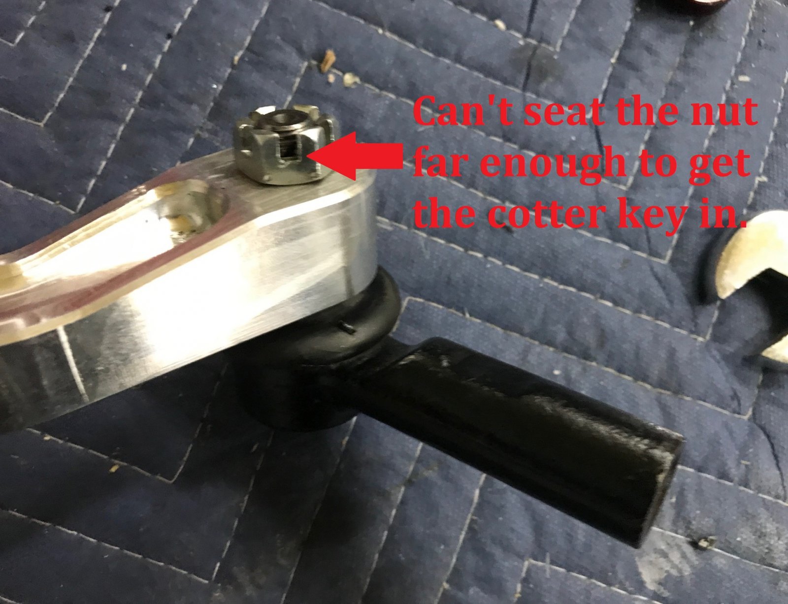

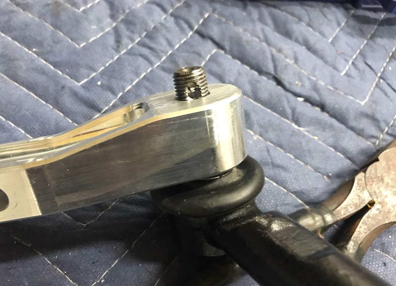

I snugged them up and started to torque them & realized the nut would not tighten enough to put in the cotter pin. Not even close. You might just try to put your rod end into the steering arm & see what you get. This is how mine look.
Note: If I put a donor rod end into the DF supplied steering arm it all fits fine.

Ooh I see what you're saying, it's not going in far enough... hmm not perfectly sure what's up there, unless you have the taper on the wrong side.
Edit: I do seem to have the same exact issue.
Edit-Edit: So, after speaking with Lonny just now over a different topic this came up. Any chance you got nylock nuts along with your outer tie rods? The intent is to use the nylock nuts instead of the castle nuts.

I had the same issue. In talking with DF, the consensus was that the supplier had changed something. I went to NAPA and got a set that works great.
CaptFrank2001
What I finally did was use a new set of Cobalt front tie rod ends (That I had in the shop). I took a cutoff wheel and cut app 3/8" off of the threaded end of the tie rod. There is still plenty of thread inside the rod end & it's turned about 16 turns onto the steering shaft. That still leaves me with about 1/2" of available adjustment.
