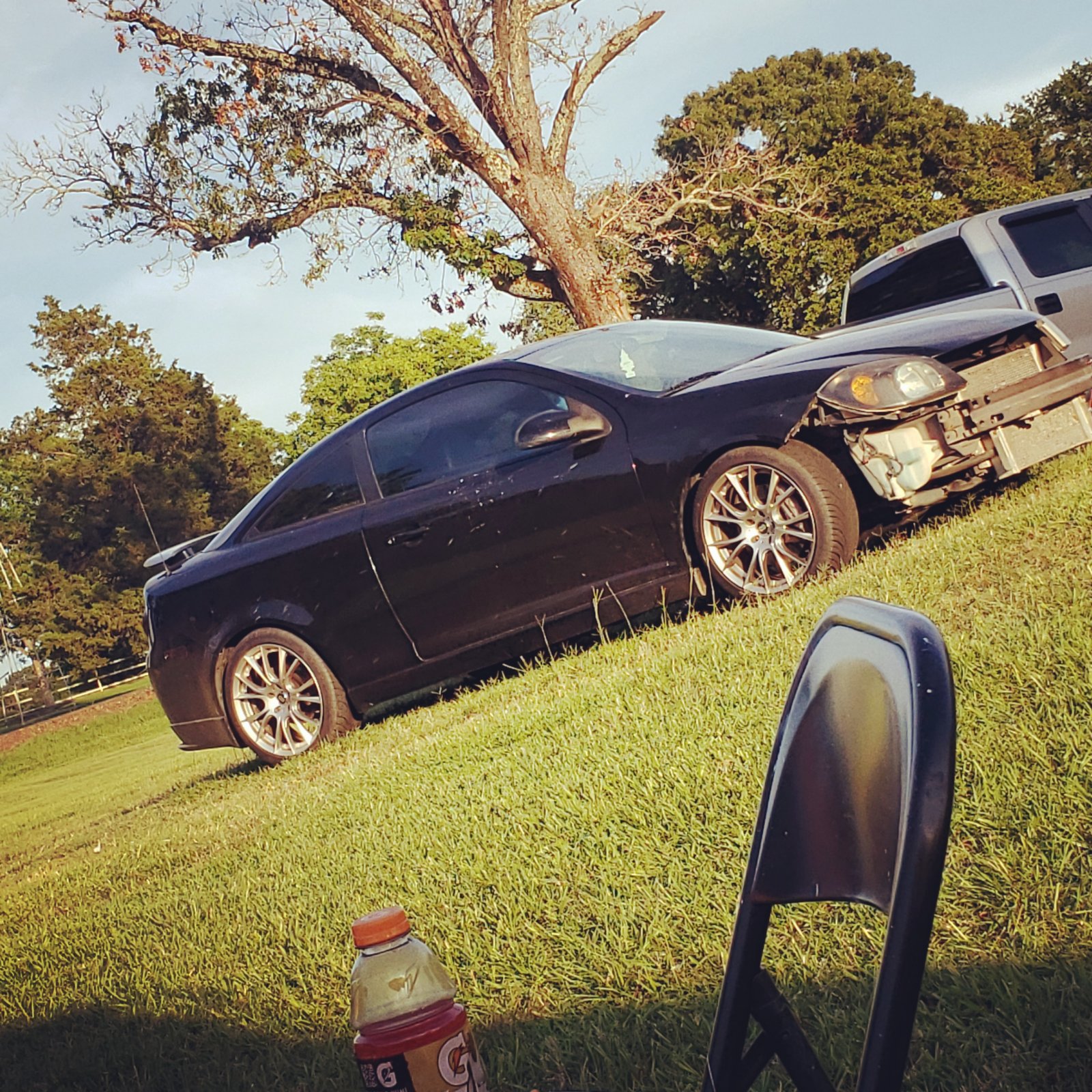

So I have a 2006 cobalt ss supercharged I want to eventually use as my donor. My problem is I want to do the A/T goblin but it's only offered for auto trans base models which is a bit of a buzz kill for me. I plan to drive it on a regular basis, highly prefer manual, and am kinda wondering if it's an "all-terrain" goblin, why is it seemingly setup only for what's best off road, without much consideration for on road? Why is it they ONLY make it for auto trans base/sport models? Any insight is appreciated, as well as if anyone knows how to make the LSJ setup and manual trans work in the A/T
