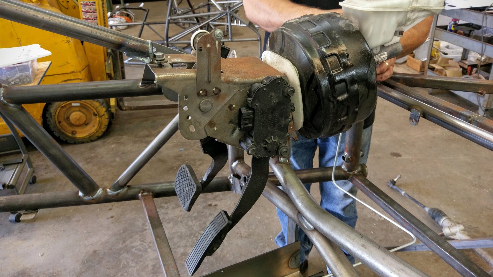

We started assembling the car on the rotisserie. First we installed the pedals, brake booster, master cylinder and brake fluid reservoir. The reservoir will later be relocated like on the street Goblin but for testing, we can leave it like it is.

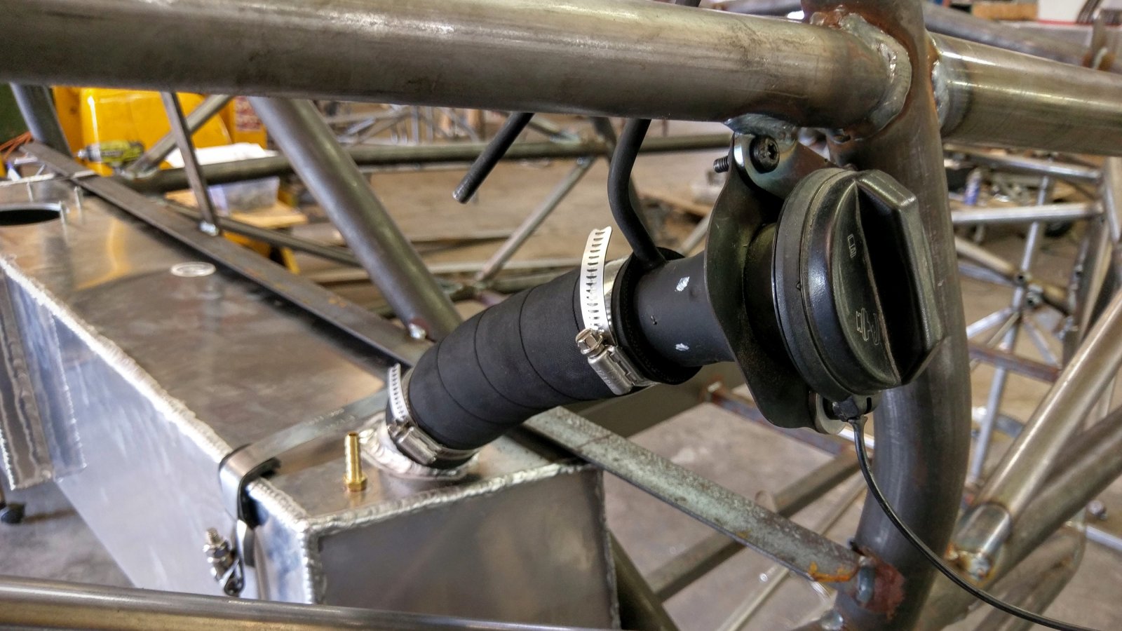

Then we installed the fuel tank and fuel filler.

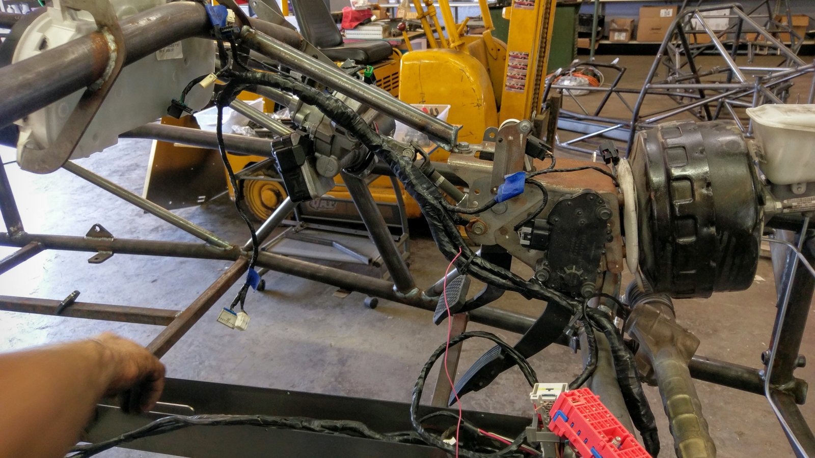

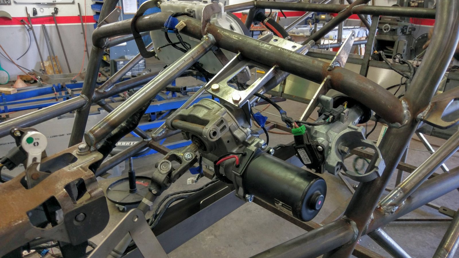

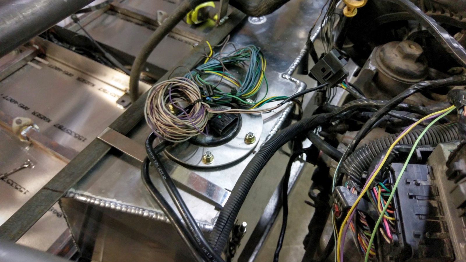

Back at the front we installed the steering rack, power steering unit, ignition switch and gauge panel. We dropped in the wiring harness we made earlier this year and connected it to everything we had installed.

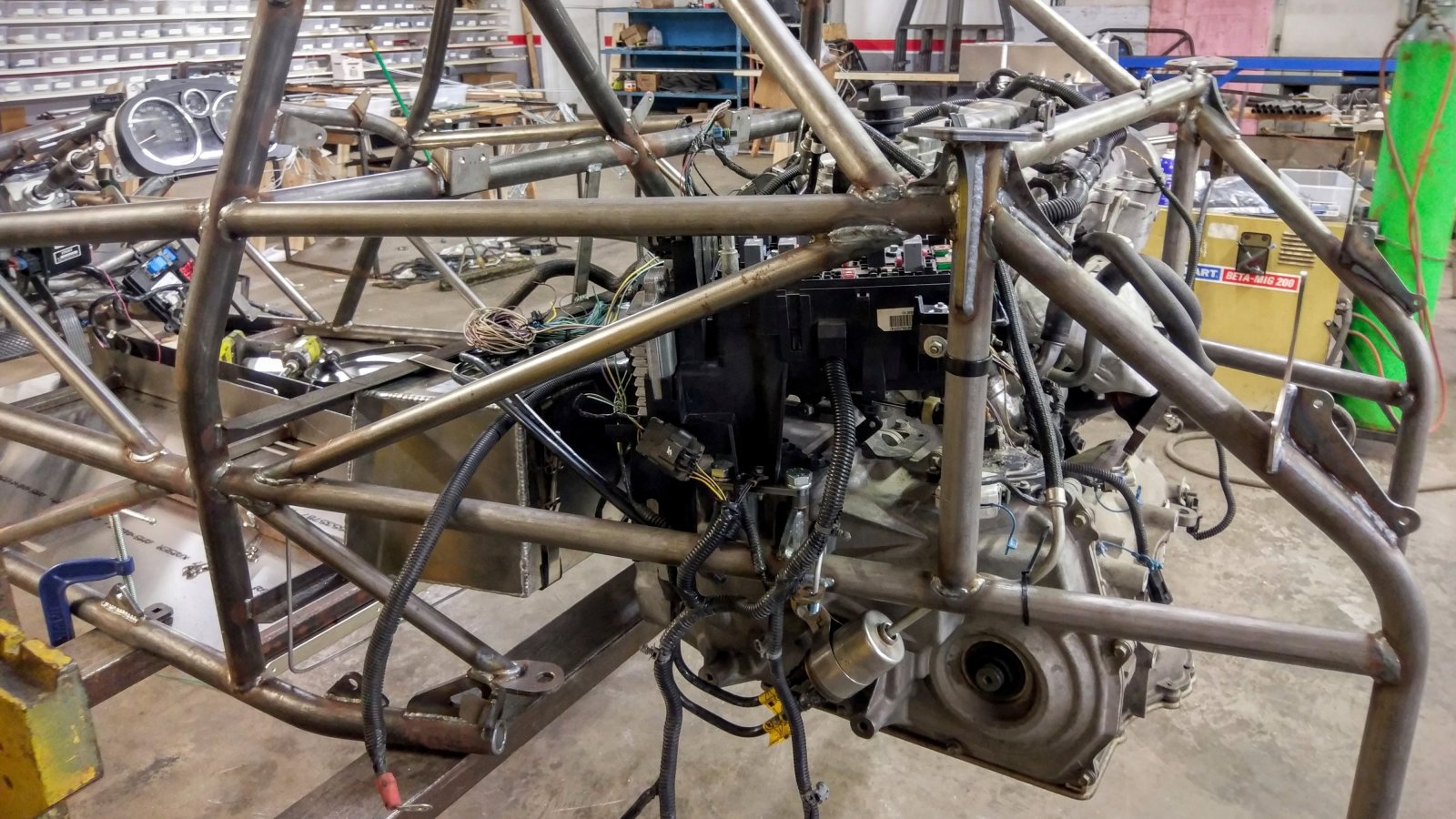

The engine and transmission were installed the same day we started assembling the car. I didn't get any photos until the next time we worked on it.
The fuel pump, fusebox, ECM and TCM went in after the powertrain.

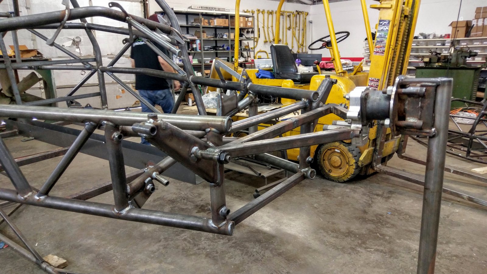

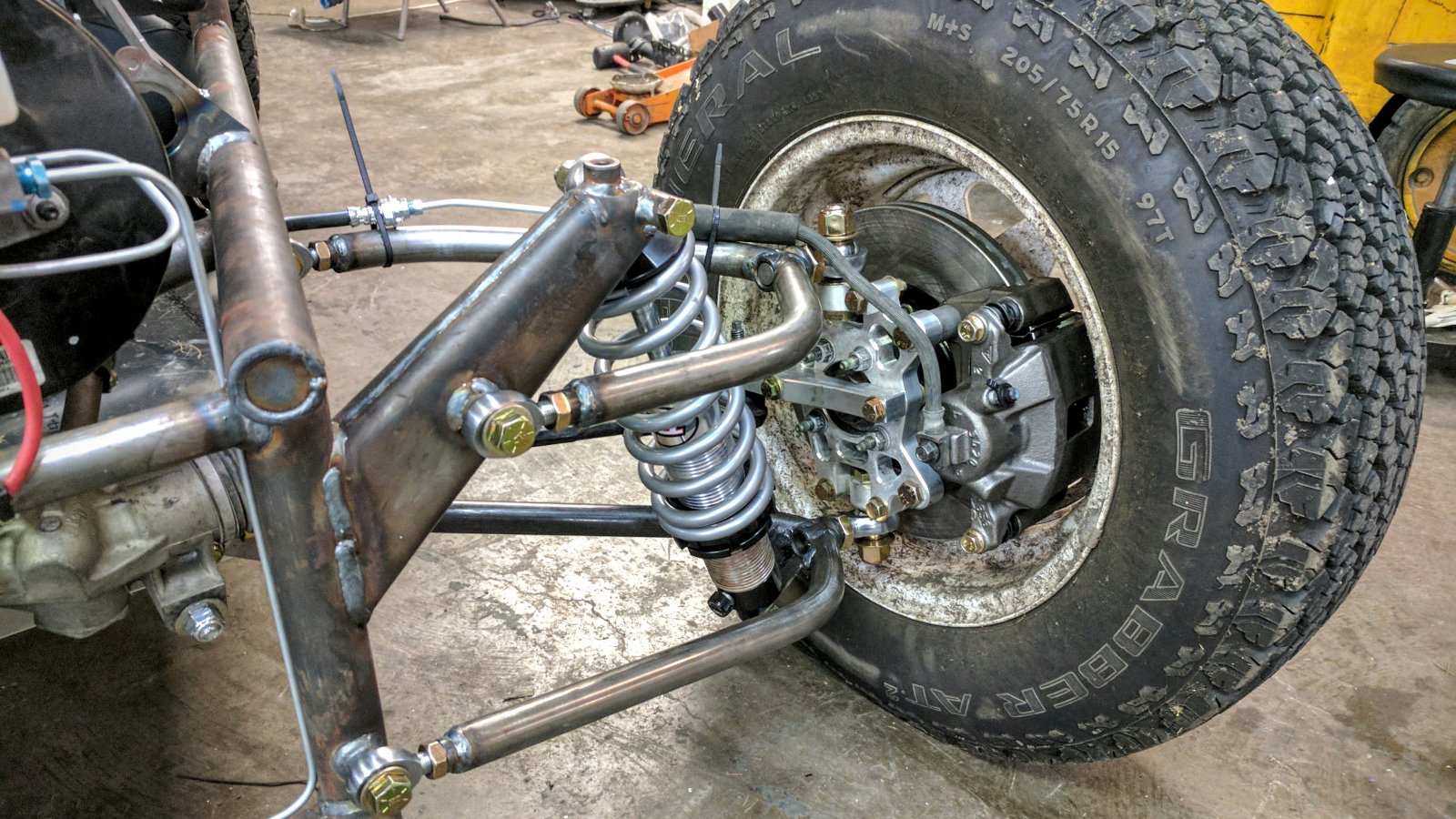

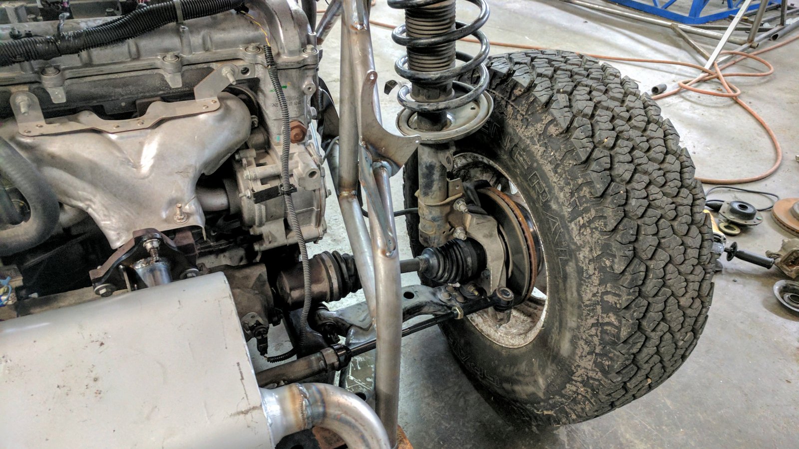

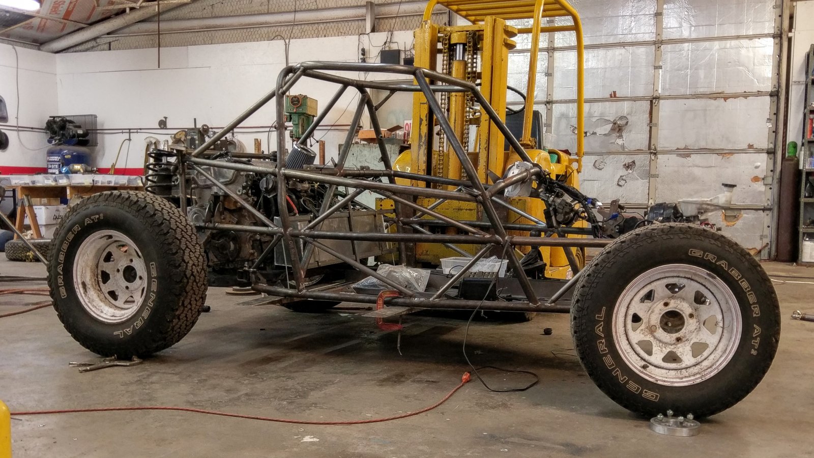

We built up the front and rear suspension and then stole my brother's tires from his Baja Bug for a mockup.
The VW beetle bolt pattern is very wide compared to the Cobalt: 4 x 130 compared to 4 x 100. We CNC machined adapters to bolt the bug's tires on the Goblin AT prototype.
Right now we are working on mounting a radiator above the engine. We are using the standard Goblin radiator but will probably upgrade to a larger radiator in the future. When you are bogged down in the mud working your way out you won't have any air flow besides what the fan can deliver. Having a larger radiator will help in that situation.

Some of the changes you will be able to make. Obviously you can put bigger tires on your street Goblin. We will be making a 1 inch lift front suspension upright that you could swap to. We'll be running a longer coilover in the front and a lower control arm with a deep shock mount. The rear suspension will need the top strut mount moved lower to allow for a little more droop.
The main change you can't make is the radiator location. Without serious modification, you will always have the radiator mount out in front of the car. If you are just taking dirt roads or other well developed paths you could be okay but if you start driving on rougher trails with more debris, you could end up hitting the mount or poking some debris up into your radiator. The Goblin AT will have a wider and shorter radiator mounted above the engine between the rear cage diagonal tubes (right now we are just using the street Goblin radiator on the prototype).

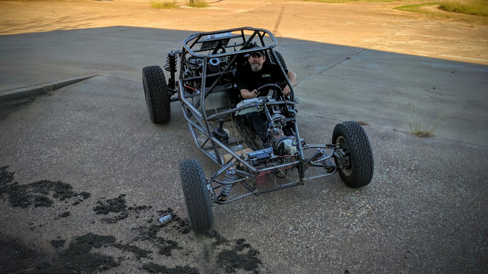

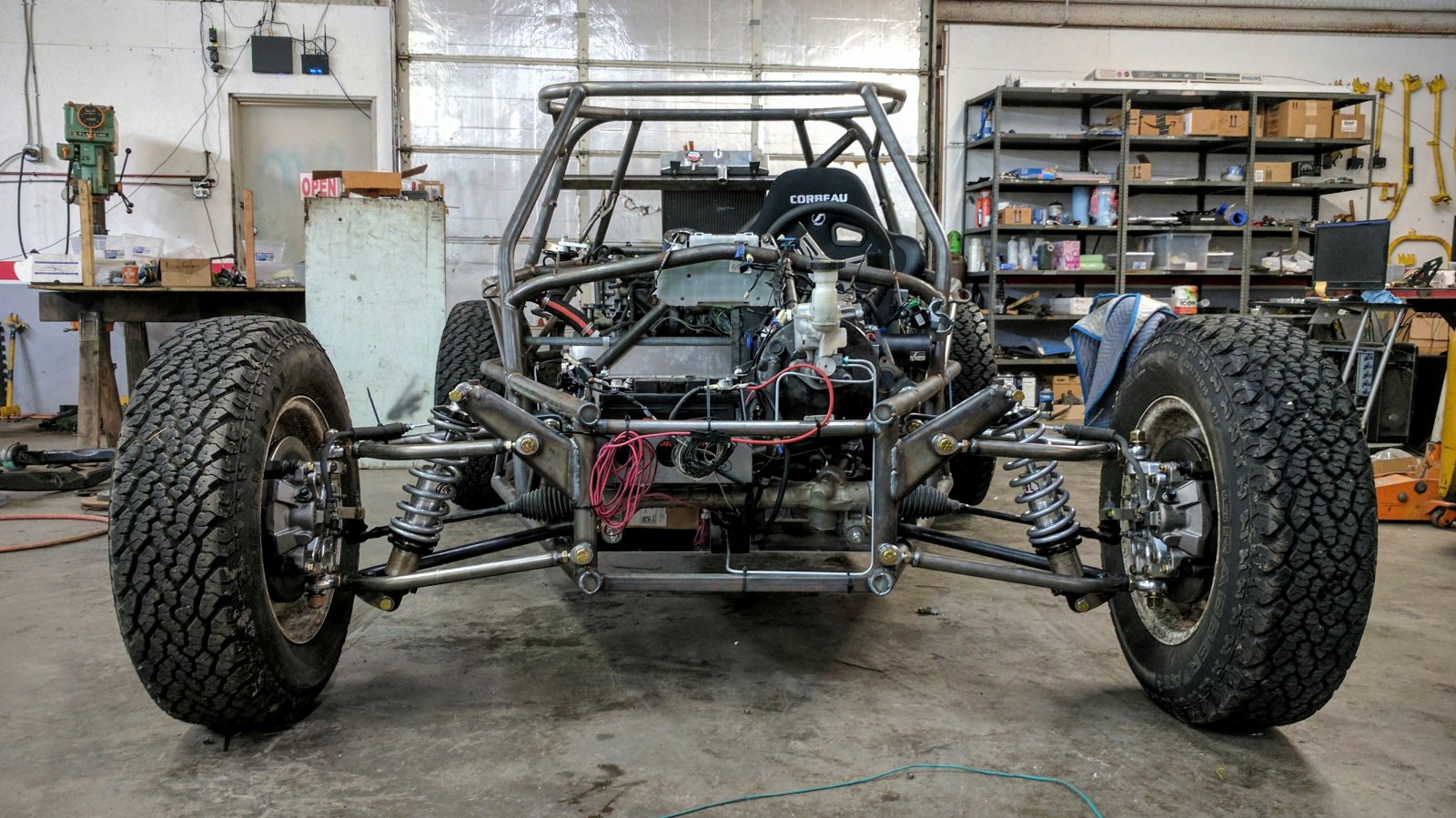

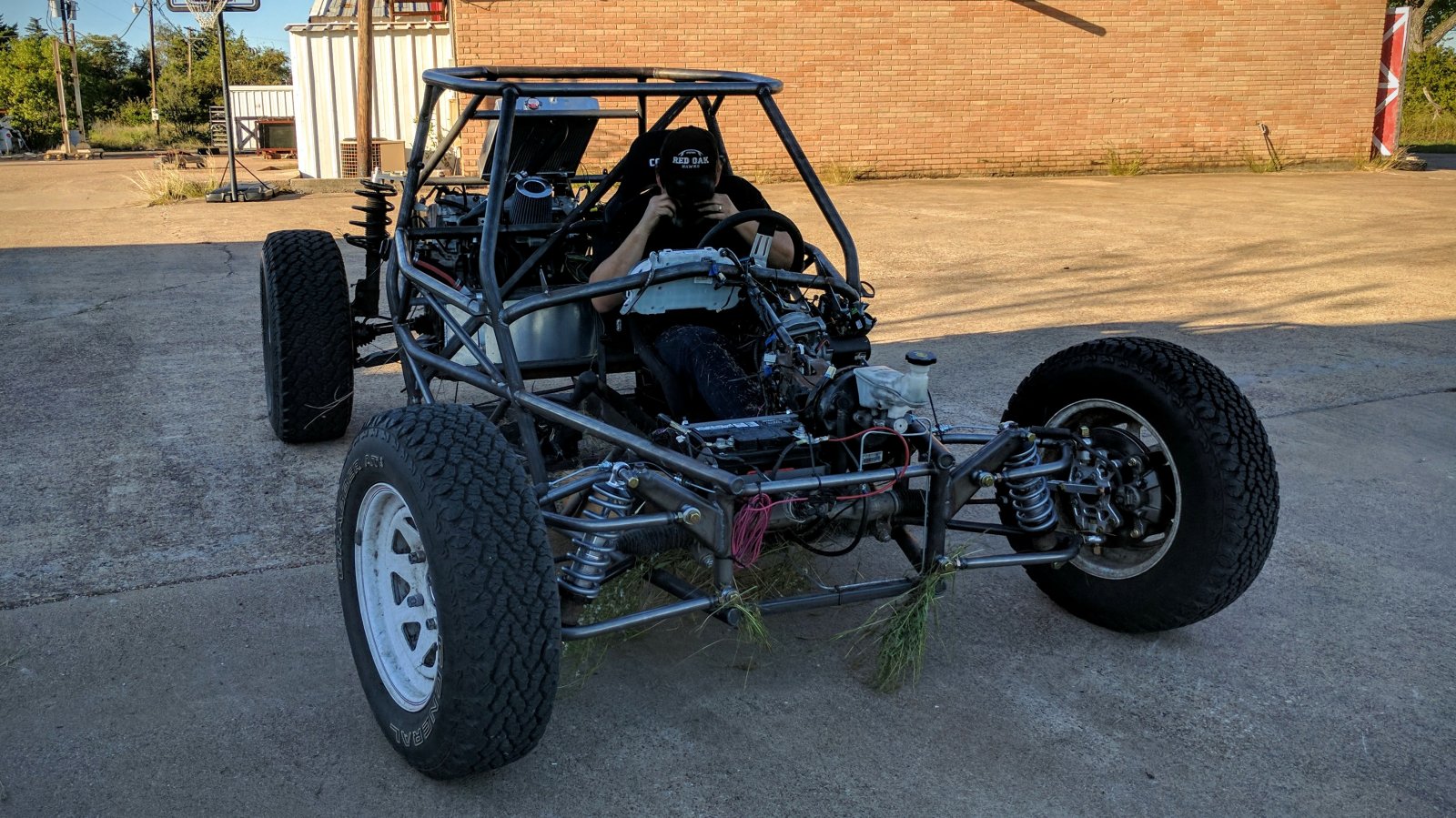

We did do a first drive on Saturday but our field is so overgrown at the moment that it didn't make for great videos. We are seeing about getting access to our neighbor's field where cattle have kept the weeds down. He also has a creek bed that we can climb on. I'll get some better videos then.
Until then, we've got this short video of the car sliding around the parking lot. Even with the base automatic transmission's open diff, it does a pretty good job of keeping both rear tires spinning.
And here are some photos:
