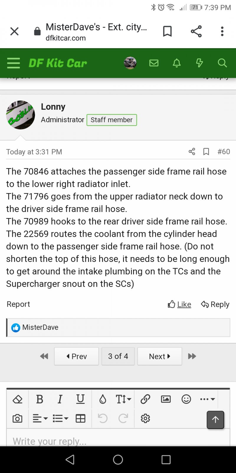

This help? Mine is set up 71796 both sides but this is the DF setup.

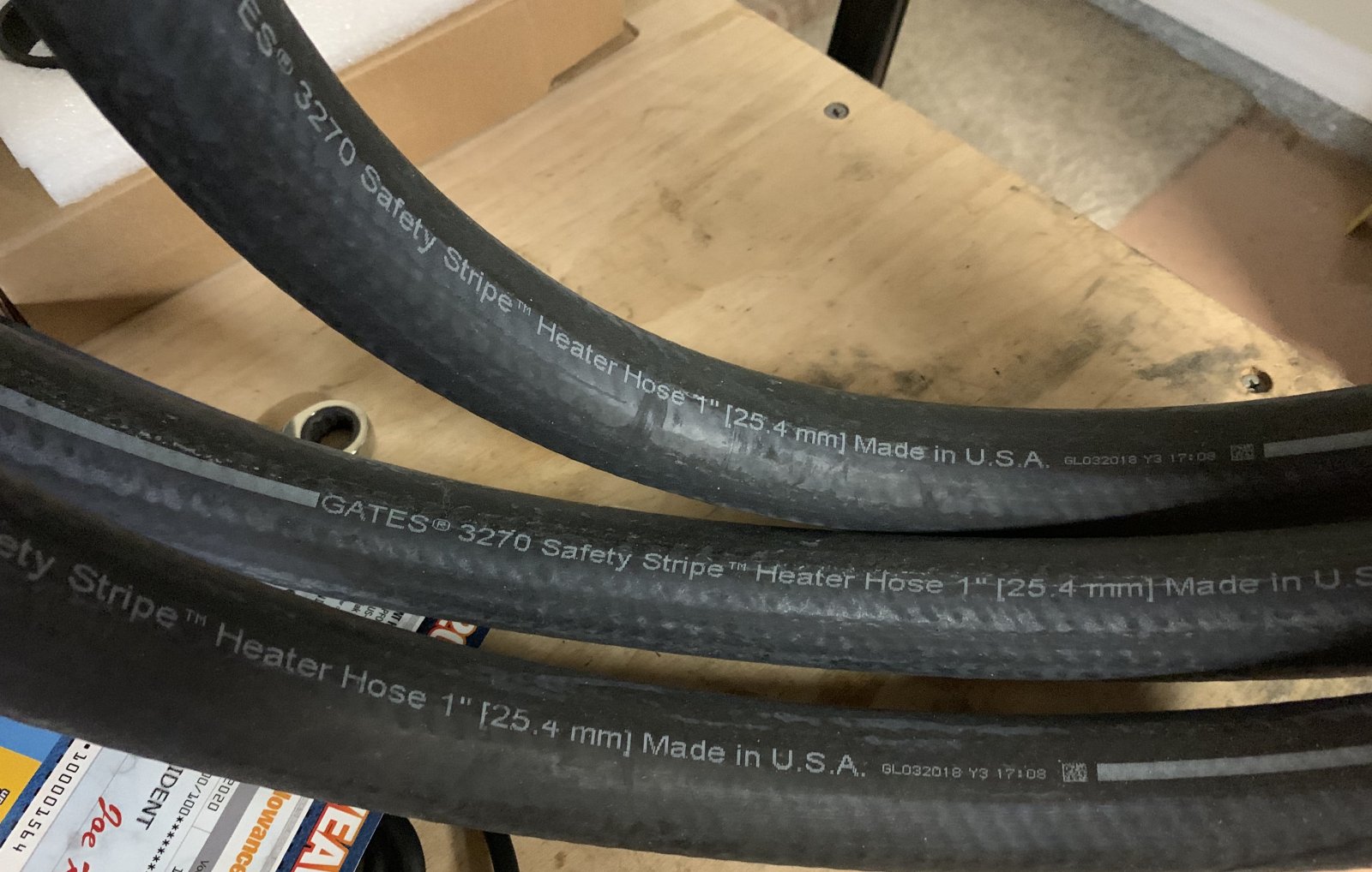

It is called 1" hose, but the OD probably is 1.25". I bought mine at the local auto store, and Adam reimbursed me. (It was missed). 8' each side. Red stripe hose was the original name. (update: it is called safety stripe... my memory was half right.)
JPas914
Gates Safety Stripe Hose is what’s used for the pulled through section in the frame. I have a coil of it in my garage that’s about 12’ long if Napa can’t hook you up.
