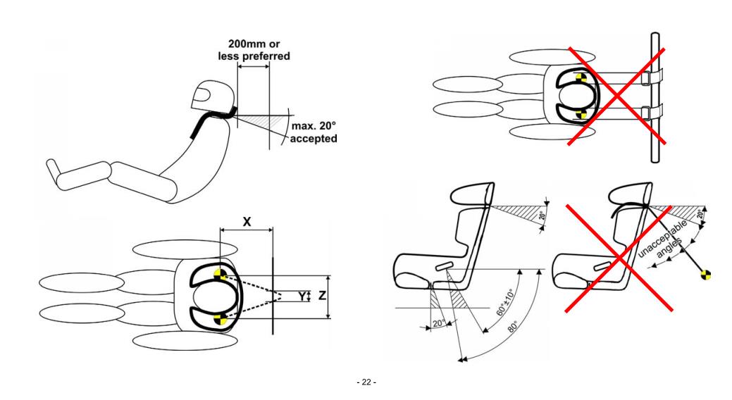

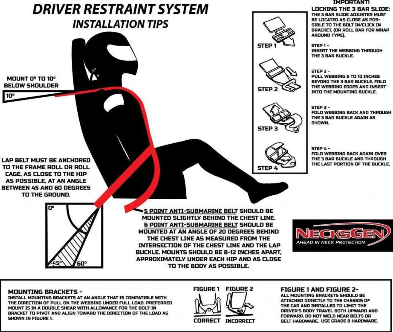

I’m going to be installing NRG seats. I know a lot of people have talked about the harness bar being too low. I’ve talked to DF about weld in one for me and they are willing too. My (and theirs) question is how much higher does the bar need to be. I.e 2-3” or more?

Depending on what product data you look at, the shoulder harness should be between 0 and 20 degrees below your shoulders.
So to determine where the harness bar needs to go is going to be dependent on your seats and how tall you are.
For that reason I am going to wait to get my frame, install the seats, then have a shop weld in a bar.
necksgen-2-inch-racing-harnesses-sfi-16-2-7.jpg seat-belt-fitting-information-2012.jpg
