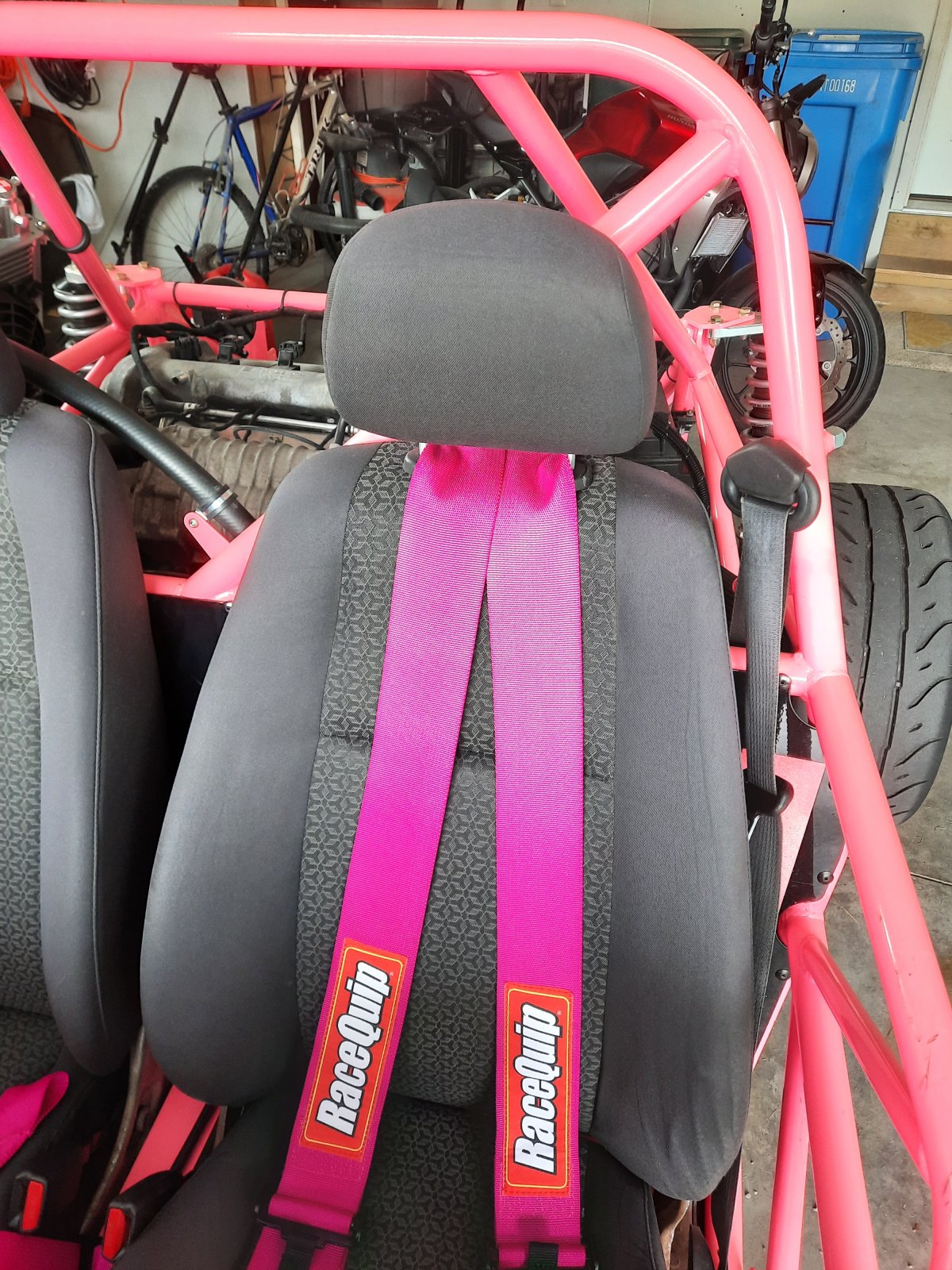

I bought a harness to try with stock seats. I mocked it up and wasn't crazy happy with it will probably finish mounting and try it when I have a free day. The straps on mine are super wide.

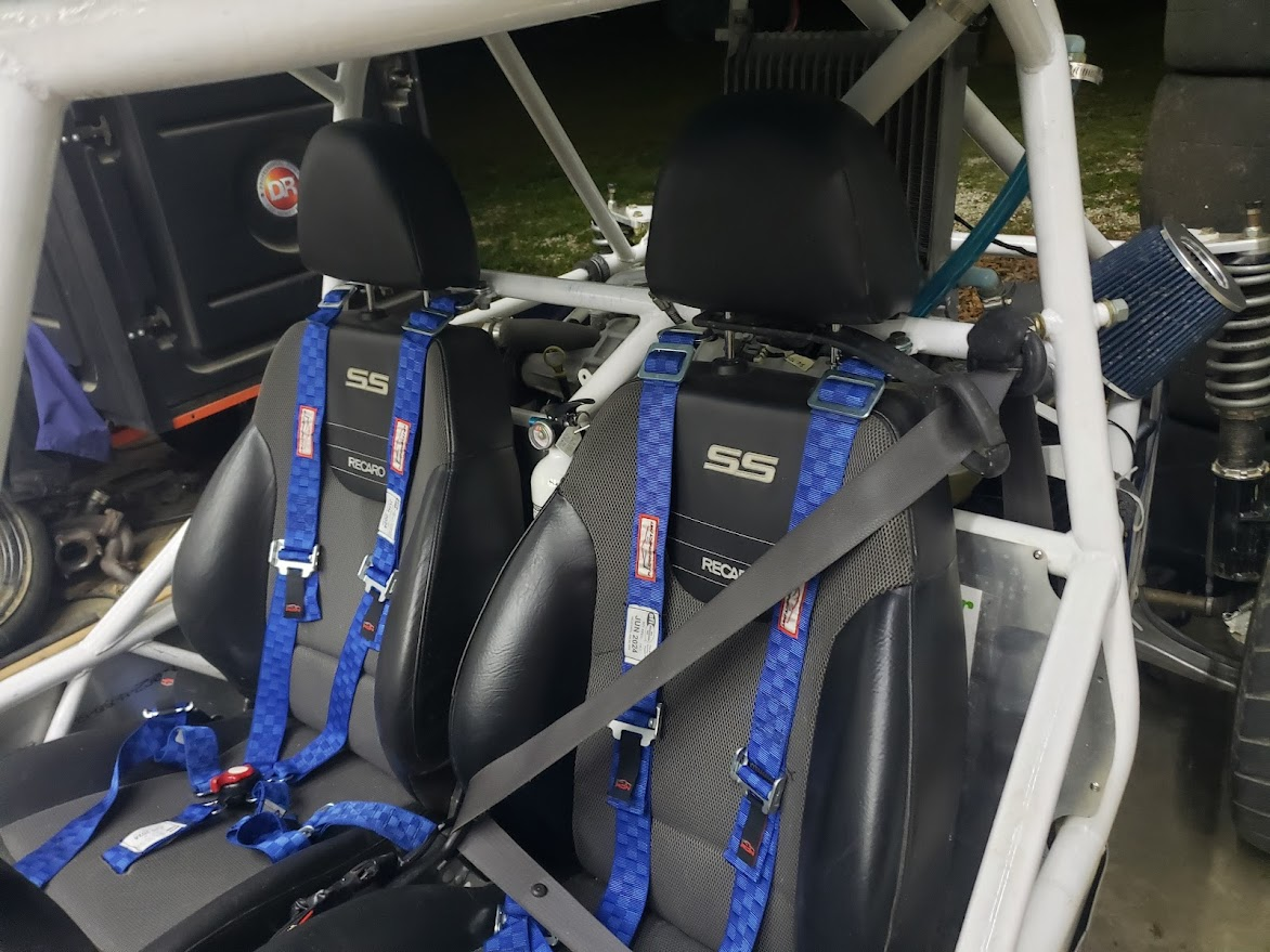

I have stock seats, and 5 way seat belts, also have the stock 3 way seat belt in the drivers seat.
I added a shoulder harness bar to my frame.

I would not run a harness without getting the upper connection points the correct height. If the harness has to run up to get over the top of the seat, you may end up with a lot of slack in them as the seat top breaks as the harness pulls down. I really think that DF needs to have an option for another horizontal bar higher than the current one.
If you are going to run these with the stock seats, I would suggest running them OUTSIDE the headrest supports rather than inside the supports. In an accident (god forbid it happens, but they do and that is why we install belts...) this configuration has the real potential to injure your neck. Those belts are made and work best when coming directly over your shoulder, not at an angle...
If they are attached to the stock cross bar, running them outside the headrest won't be much better, since they will slide off the edge of the seat and create a lot of slack.

Some folks use a U style hose clamp (can be found at Lowes or a hardware store) on their cross bars to old the seatbelts in place and from sliding on the cross bar. The seatbelt webbing is wrapped normally on the crossbar, and this simply holds it in place. Yes, running the belts inside of the head rest bars will potentially cut your neck and we certainly don't want that happening.
These clamps can be bolted or welded to the crossbars.
