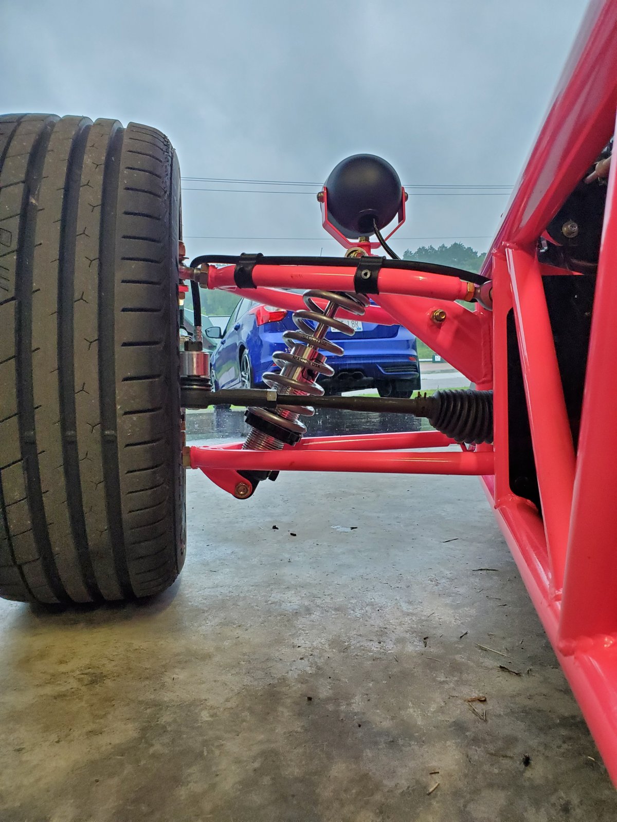

I would think leveling the tie rods with the steering rack would have a positive effect on bumpsteer. Right now, my tie rods angle up nearly an inch over their length, which would cause toe-out during shock compression.

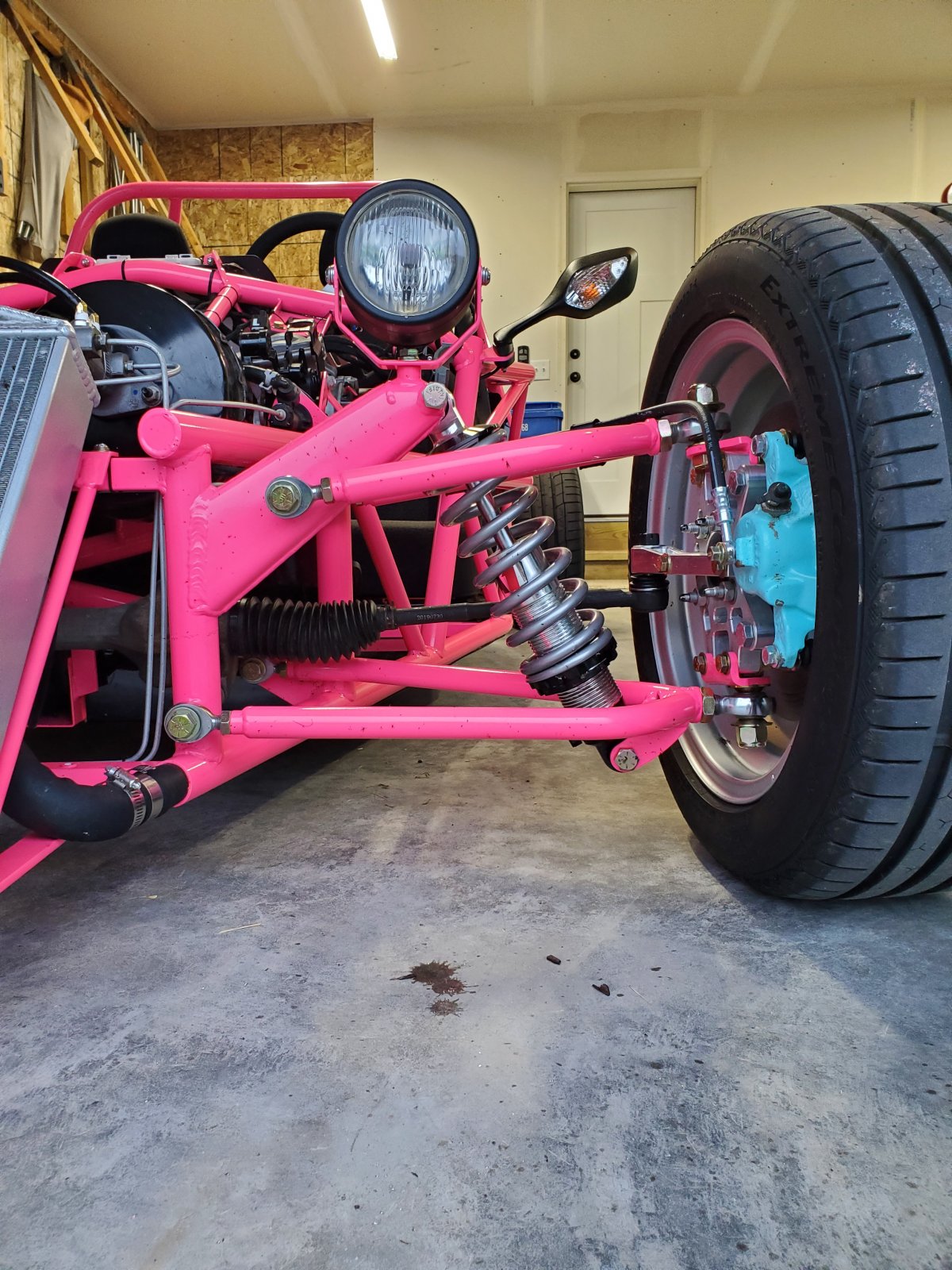

This is a straight shot of the front end arm angles. The lower CA is just past level. This picture may be slightly deceiving. The frame end of the CA is about 1/8" higher than the knucke end.
From the rear. Shows the steering tie rods angle up to the knuckle from the rack about 1" from end to end.

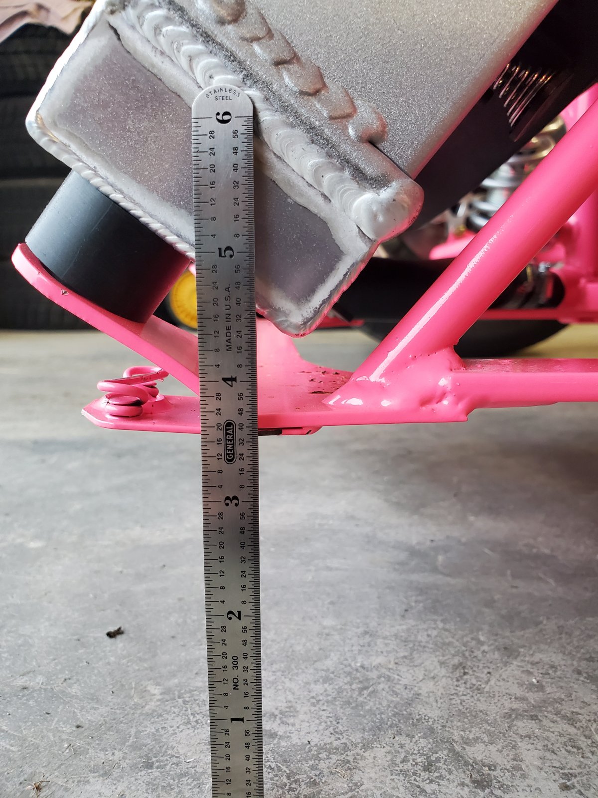

Shows clearance of 3.5" at lowest and furthest forward point.

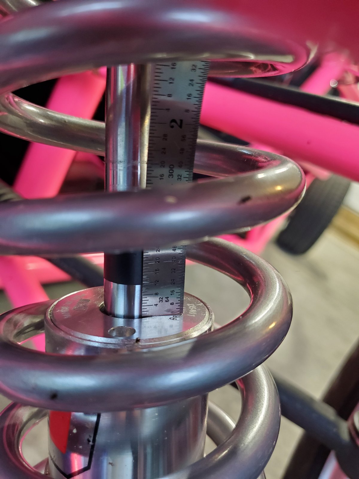

In this picture, I taped the rod where it met the body when static, then lifted it up with a jack and shoved a rule in. Shows 3/8" extension travel left when sitting static without load. Gains about 1/8" with driver and passenger weight.

Hmm, this one is a head scratcher. The lower arms appear to be close to level, maybe slightly upward at the wheel. But you have almost fully extended the supplied shocks in their travel in the current configuration. Visually the geometry looks correct, but you have 3.5 inches of ground clearance, not desirable unless you have a track only car.
I'm thinking that putting on longer shocks can help get more piston travel in the shock and some slight adjustment to the lower control arm to go slightly higher in ride height. Not sure you will get more than 3/4 inch clearance increase without pushing the control arm down too far.
Sorry but I keep coming back to your wheel and tire combination. A 205/50-15 is only 23 inches in diameter - a full 2 inches shorter than the 'stock' tires (25 inches) which makes for 1 inch less ground clearance, all things being equal. On my car I have 25 inch tires that should get me 4.5 to 5 inches of ground clearance, which aligns with many other builders measurements. I'm not sure the 5 inches of ground clearance you desire can be achieved with this combination. The suspension geometry may be compromised trying to get there.

Seeing your steering arm not level means that you have some room to increase the ride height before it negatively affects your bump steer. In fact, making that level will help reduce it. And I'm with Desert, you have small tires compared to most. Going up a couple of sizes will give you an additional inch or so. Both might get you to the 5 inches.
