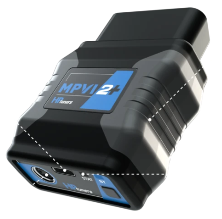

I already had the MPVI2 plugged into the OBDII port on the car, and a USB cord from it to my laptop. The car key was turned on, but the engine wasn't started. The key on will power up the car's ECU and OBDII port so the MPVI2 can communicate with it. The green LED light on the MPVI was turned on.

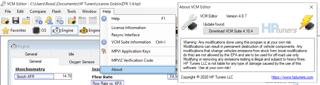

1. In VCM Editor, go to Help, then About. See if there is any updates found, and download the latest software.

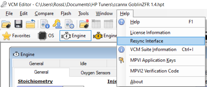

2. Go to Help, Resync the shop laptop to the interface. (I sometimes tune with my Windows 10 laptop, which necessitates a Resync )

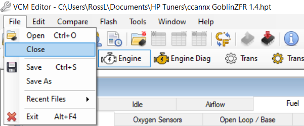

4. Go to File, Close. You can't have a file open in VCM Editor if you want to download the tune from the car.

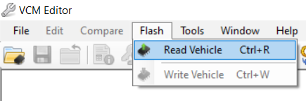

5. Go to Flash, Read Vehicle.
