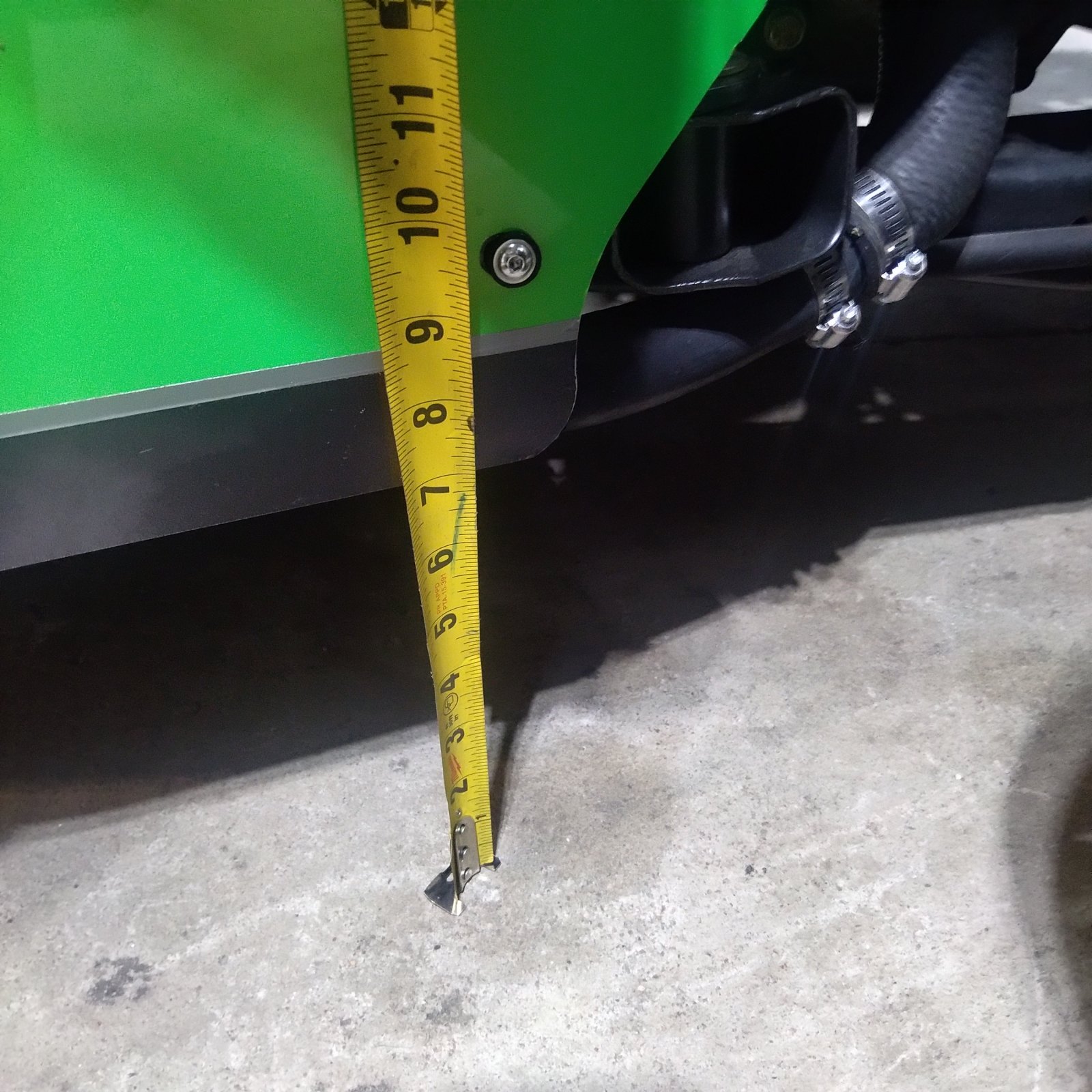

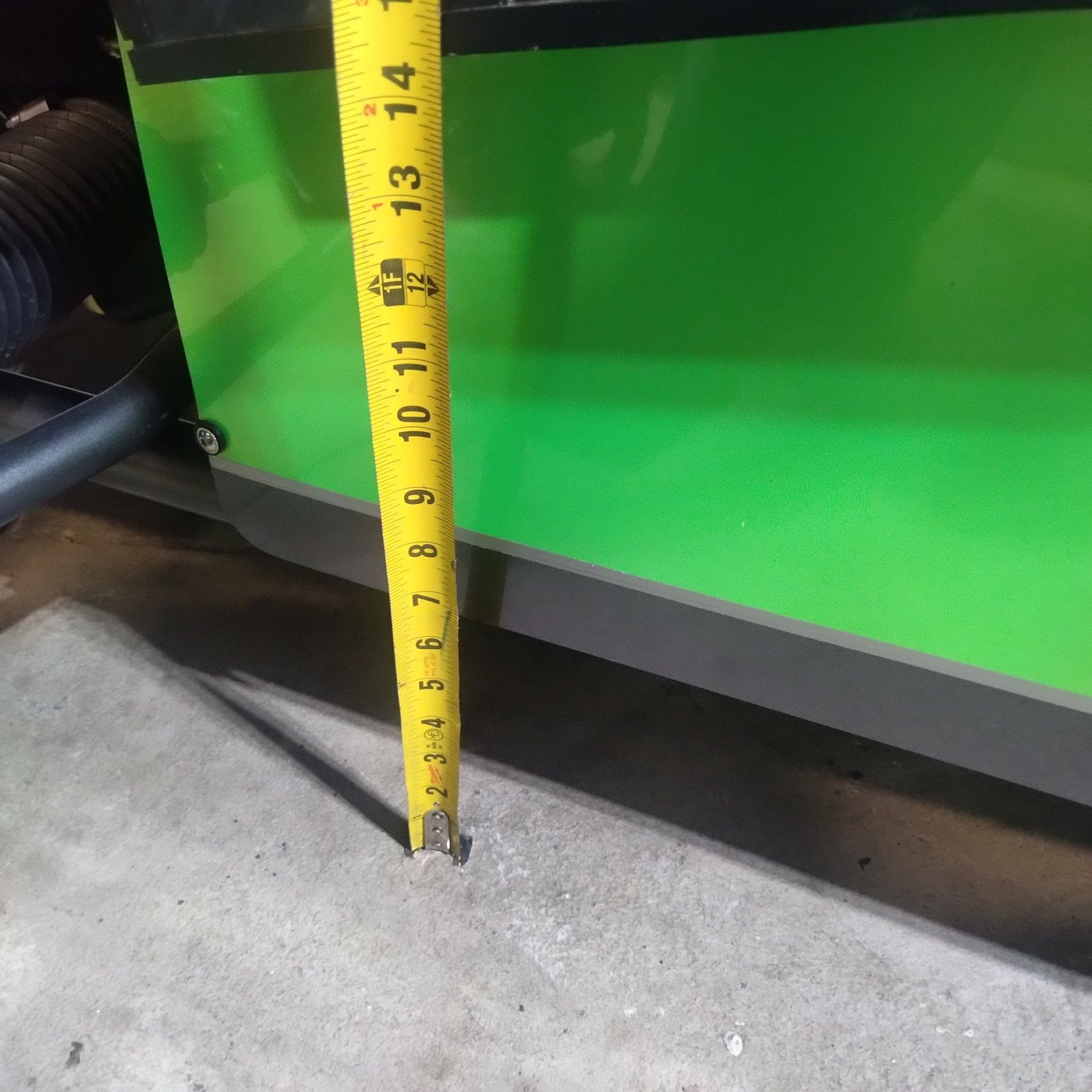

What is everyone running for ride height. for me right now its...
Front: 6.5"
Rear: 7.0"
I feel like I am too high but I don't want to get ruined by pot holes and speed bumps.
