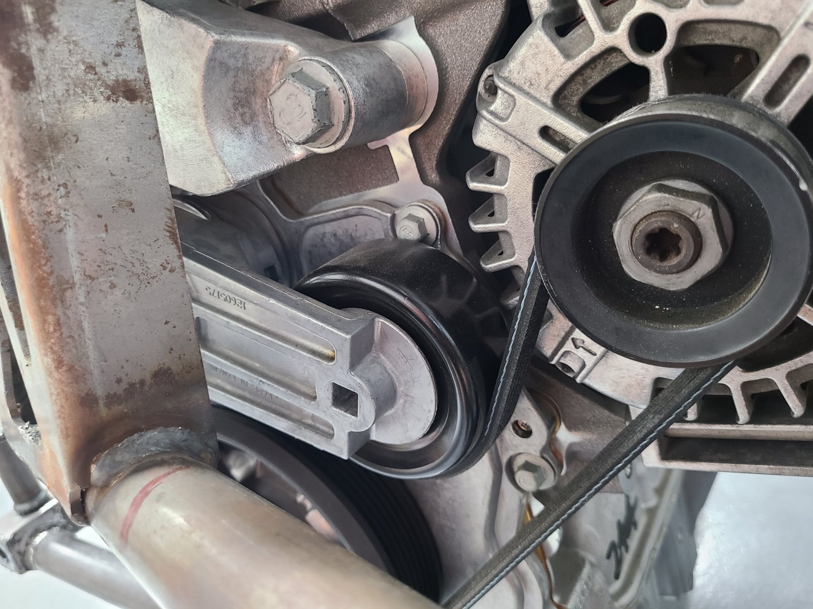

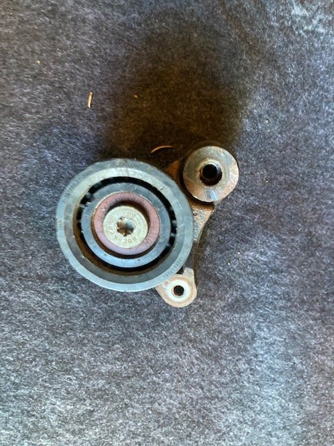

So yesterday I had to completely remove the idler wheel from the 2.4l ecotec that I have. This was due to the fact that it was stripped and I could not use a T50 socket because it would keep slipping.
Here is the part I am referring to:
35496
I was wondering if anyone knew where to buy this. I found one but it cost 240 dollars which seems far too expensive for a little wheel. If it is so expensive is there any way to remove the bolt? Is it even a bolt? If it is a bolt I would guess I would need to extract it.

Do you think it is possible to post a link? If this is the one you are referring to it is not this part. It is the assembly just to the right of it in the diagram that is in the picture if that makes any sense.

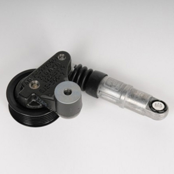

That is the idler pulley, not the tensioner pulley which looks like this:

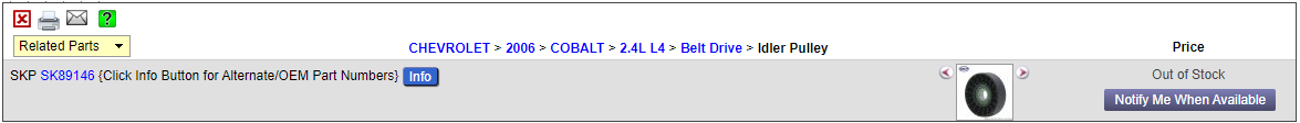

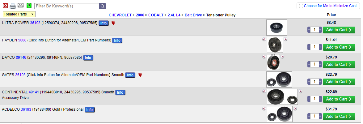

As @ctuinstra indicated, the idler pulley (wheel and bearing) is available on Rockauto for cheap. The left hand treaded bolt just needs to be removed - righty-loosey not lefty-loosey. Looks like someone cranked on it lefty-loosey and stripped out the T50.

At this point I’m not sure what part he is looking for. The link in post 3 would indicate it’s part of the tensioner assembly from an LSJ. But since he has an aftermarket supercharger assembly, it’s hard to say exactly what he needs.
