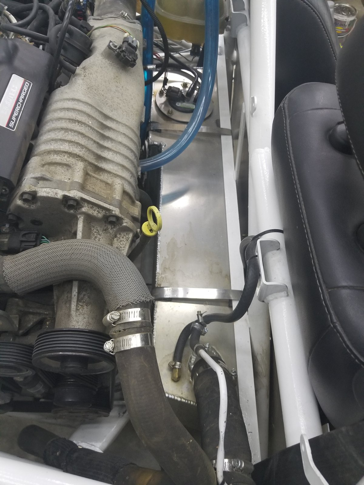

While my Goblin is still at the fab shop I am wondering if there is enough room to have them build a larger fuel tank. So if anyone would share some pictures of the clearance around their fuel tank I'd appreciate it. Top, bottom, next to the engine.

I can take some pics of my supercharged ecotec... but that might not apply to your engine bay.

With the supercharger on there, there is not much more room for a larger tank. They really maximized that area as much as possible.
The blue hoses aren't stock, as I put my intercooler below the roll bar rather than behind the front radiator.
TheNuker
I will say that the tank is SUPER tight with the fittings coming out of a dual pass setup unless you thread them and put 90s on right away. So I would not consider going thicker towards the engine on an SS/SC setup.

If the tank was taller, and the angle iron on the frame moved up, it might work.
The fuel pump probably has to stay low in order to get the gas off the bottom, so if you went up, the pump would be in an indented hole.

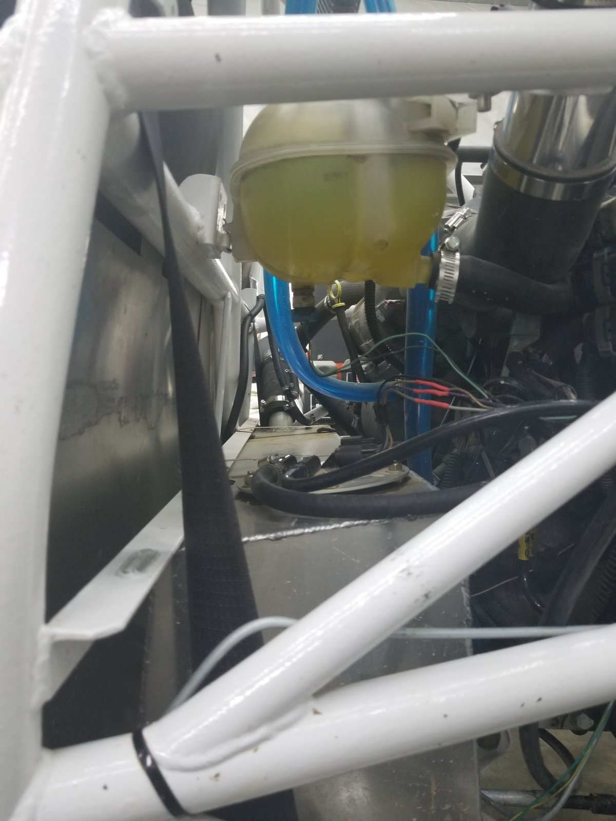

From Ross's pictures it looks like I can add at least 2" on both ends and 3-4" in height safely. Might have to move the coolant bottle. But it does look possible to make the fuel tank larger so I won't be wasting my time trying to do it. Thanks.
