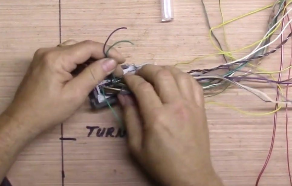

The video shows the Purple & Green dimmer switch wires to be soldered together. This has been done so I assume this is setting it for max brightness which I do not have.

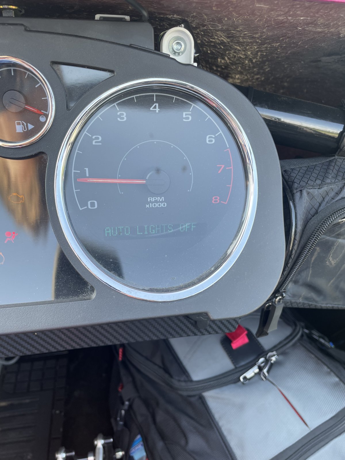

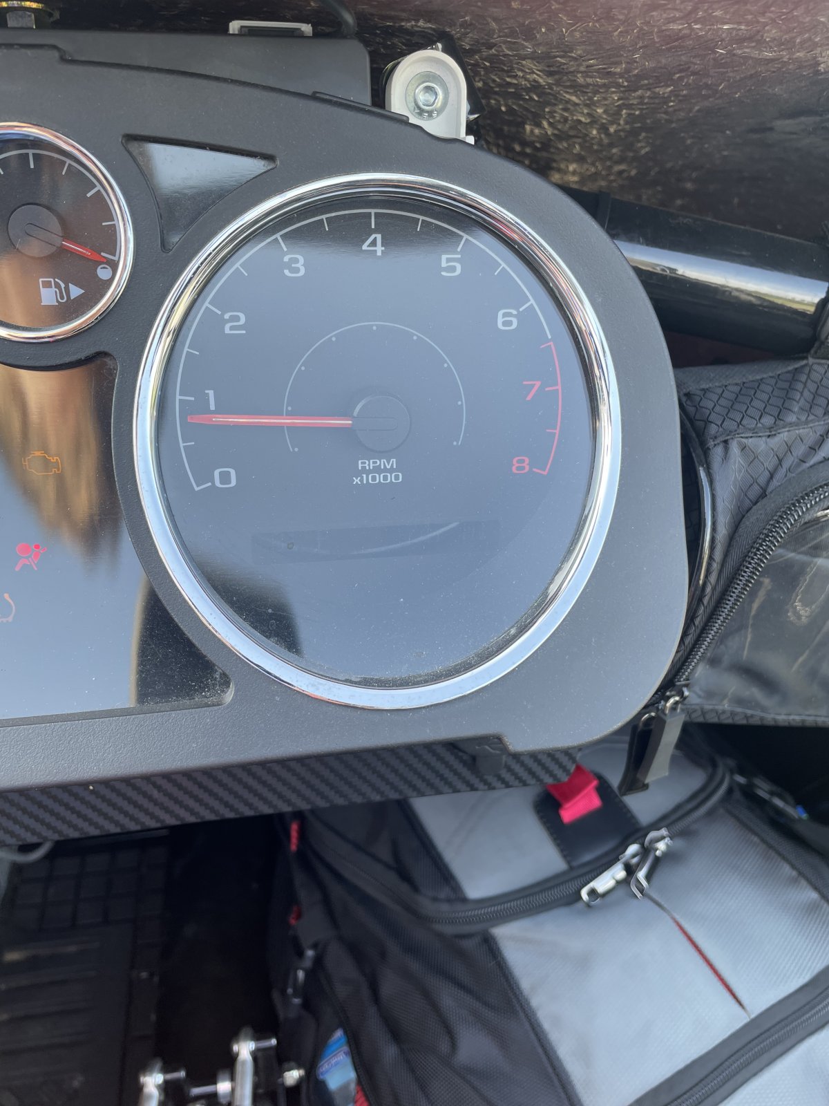

I went back to my "soon to be" turbo donor (stock cobalt). When I turn on the key (at dusk) without touching the light control the lights are dimmed. Manually changing the headlight control has no effect on the brightness of the lights. When i put my phone flashlight over the ambient light sensor... it takes 10-15 seconds, and the lighting goes to daytime brightness, again, changing the headlight control has no effect on the light intensity.
I can't attest to the wiring, just what the factory functions are. Obviously the dash lights dim when the dimmer switch is used. Thought it might be of some help.
W
And that is screen brighter than night time?
Affirmative. Now the way my goblin is wired doesn’t seem to matter with the light sensor…. But when turning the auto lights to “Off” it goes to daylight mode; as shown.
for reference, i believe the dim one is reading "71 F 741 MI" but it's entirely non-readable.
