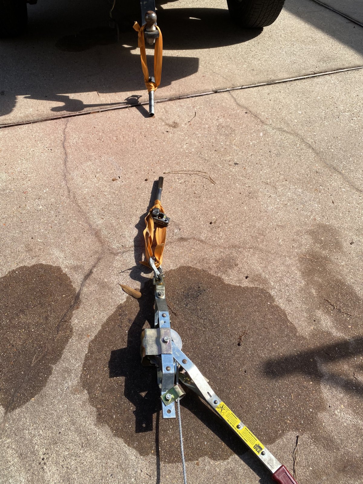

Used a come along to free up the intermediate steering shaft. One end tied to jeep hitch, the other end tied to come along. I stretched it as far as I dared, then put heat on it. Popped apart within 3 seconds of applying the heat.
