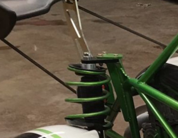

What you are doing is very cool. Right now on P2 I've got a standard sized coil spring resting on the stock spring perch. It functions well enough for testing but doesn't look nearly as good as your coilover sleeve and height adjustment hardware.

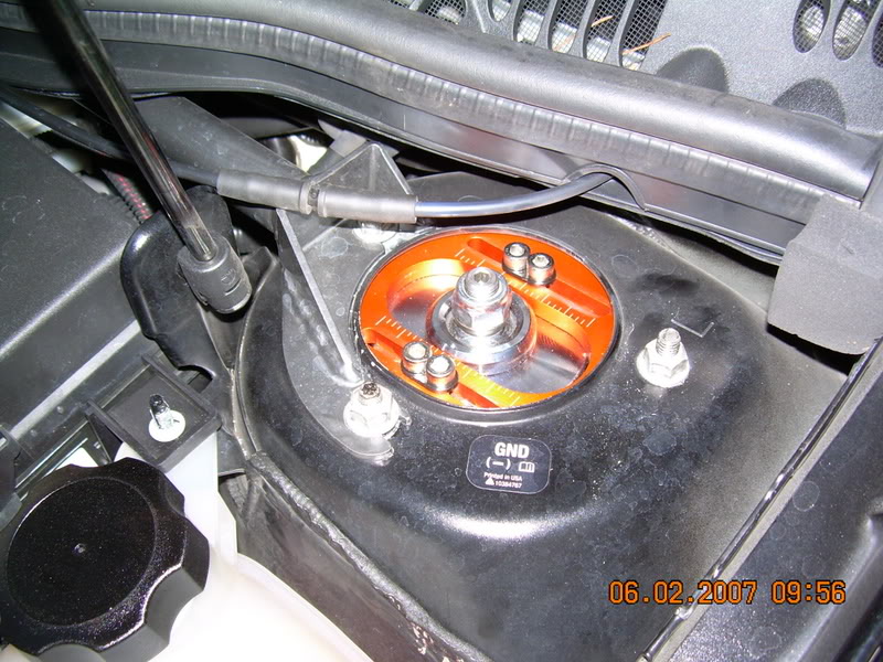

Adam I want to install some KSport coilovers in the back, the problem is they use the three bolts around the strut to mount up. Can the little plates you make for the goblin be unbolted and a different plate bolted in, one that is made more like the stock mount? I like the idea of the adjustable camber plates.
JSATX
And by plate I mean the bracket bolted to the frame at the top of the strut.
Johvans
You SHOULD be able to run the KSport coil overs assuming they are separate from the toe adjustment plate. It SHOULD mount like the standard shock after the plate is removed. Might be worth finding some pictures of the KSport unit out of the car.
