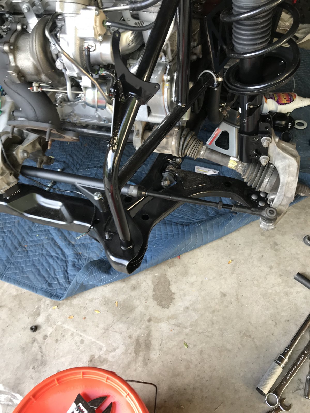

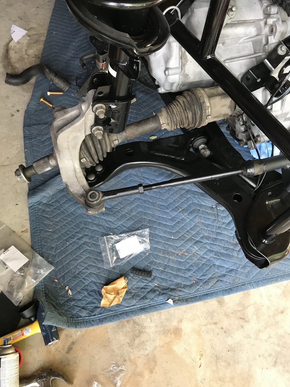

I installed the toe link kit today and it looks like when the adjustment bottoms out the hub is still tilted inward. If I cut about 1” of threads off the rod I would be able to get the back wheels straight.
Is anyone else having to do this or is something wrong with my setup?

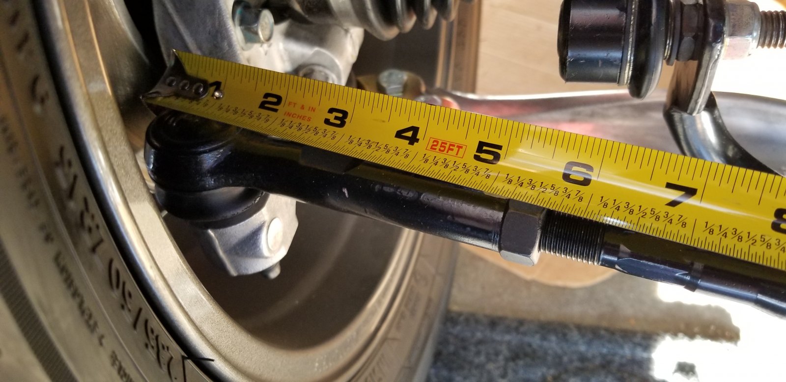

How long is that rear tie rod end?
My rear tie rod end measures, end to end: 5 1/4in.
Front: roughly 3 3/4in.
Thank you big help, I figured it out. when i got my donor one of my tie rods were ripped out due to the accident i feel like something was left inside not allowing me to screw on all the way. the side im having trouble still has over 1" of exposed threads and the driver side which looks great only has around 7/8" threads left. im just going to get fresh tie rod ends and i think that will do the trick. looking at your photo you you have your sway bar attached? if so would you be able to take a few photos showing how you attached the sway bar?

I did get the black stamped control arms due to my old ones being damaged. I held them together and couldn’t find a difference. I did however fix my problem. About half way down the threads were a little bit rusty causing the block. I added a rust bust spray and worked the threads and was able to get where I needed. Thank u all. Now time to figure out the shifter layout :)
