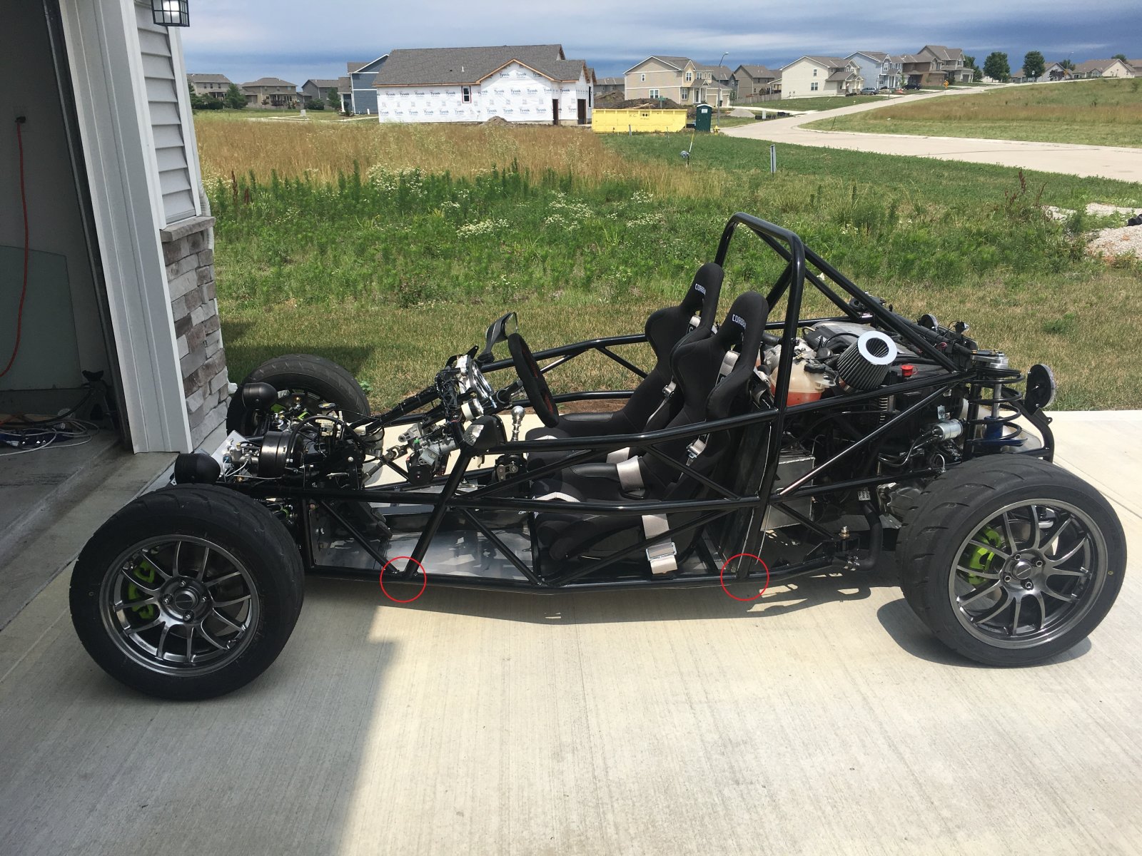

A question came to mind today ... those of you with finished Goblins, what point(s) on the frame do you use when you jack the car up? Inquiring minds want to know!
TheNuker
This is where I always used for mine.
Nuker-
13328
R
I've been a little woried about where the balance point is in the back with the cantilevering engine, so I've been jacking it up from the center rear of the subframe. Rubber pad on jack and pieces of left over 3/4" heater hose that were split open covering the stands.
