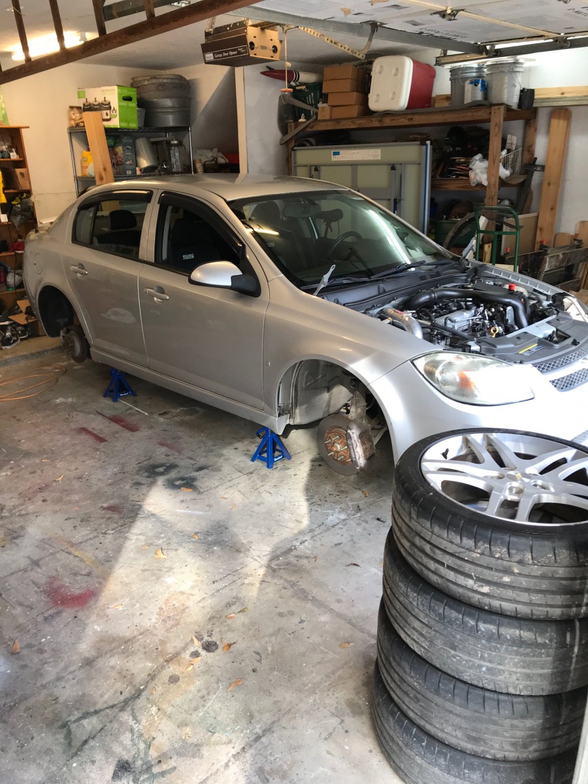

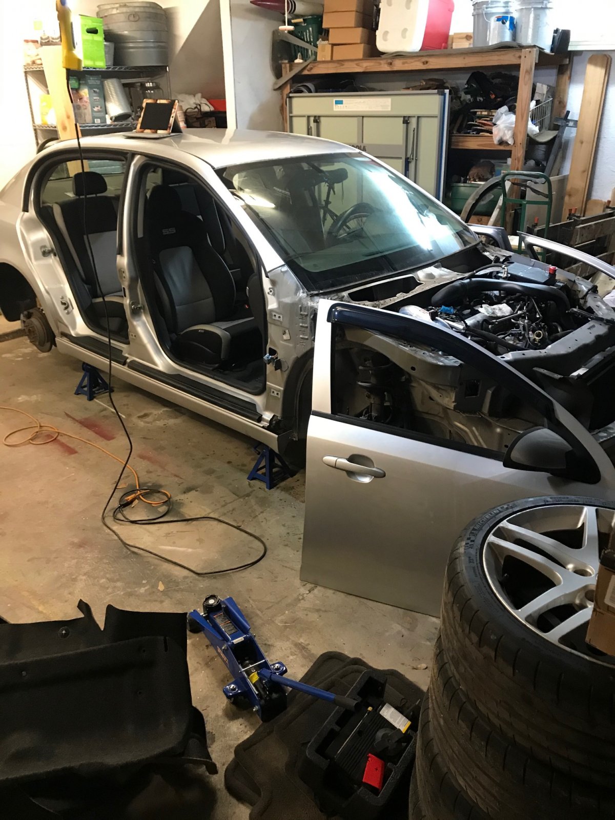

Day one today.
Had a local guy vacuum the refrigerant out of the AC system.
82k on the car. Everything is working well. Really good shape donor. Except the stupid turn signal switch. Hope they fired the engineer who designed it. Oh well, Rock Auto will like to sell me one surely.

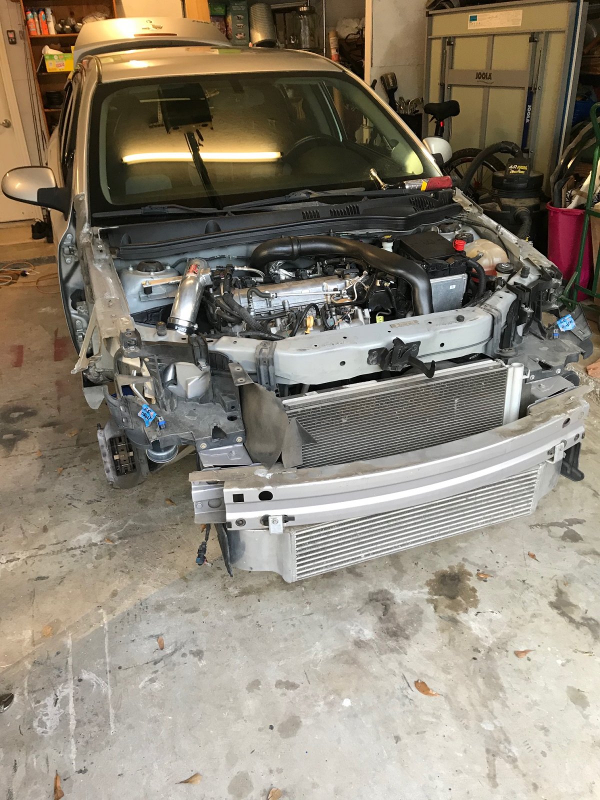

Spent a few hours removing some of the big parts. Small steps......
I see your four legged house alarm is keeping an eye on what is happening. ;) Great progress. I see some tape labels on the electrical connectors, make sure they don't fall off. Door beams and the glass make the doors pretty heavy, the 2 door is even heavier. You have almost an entire car of good parts to sell off, don't see any corrosion so that should help offset your donor cost pretty well.

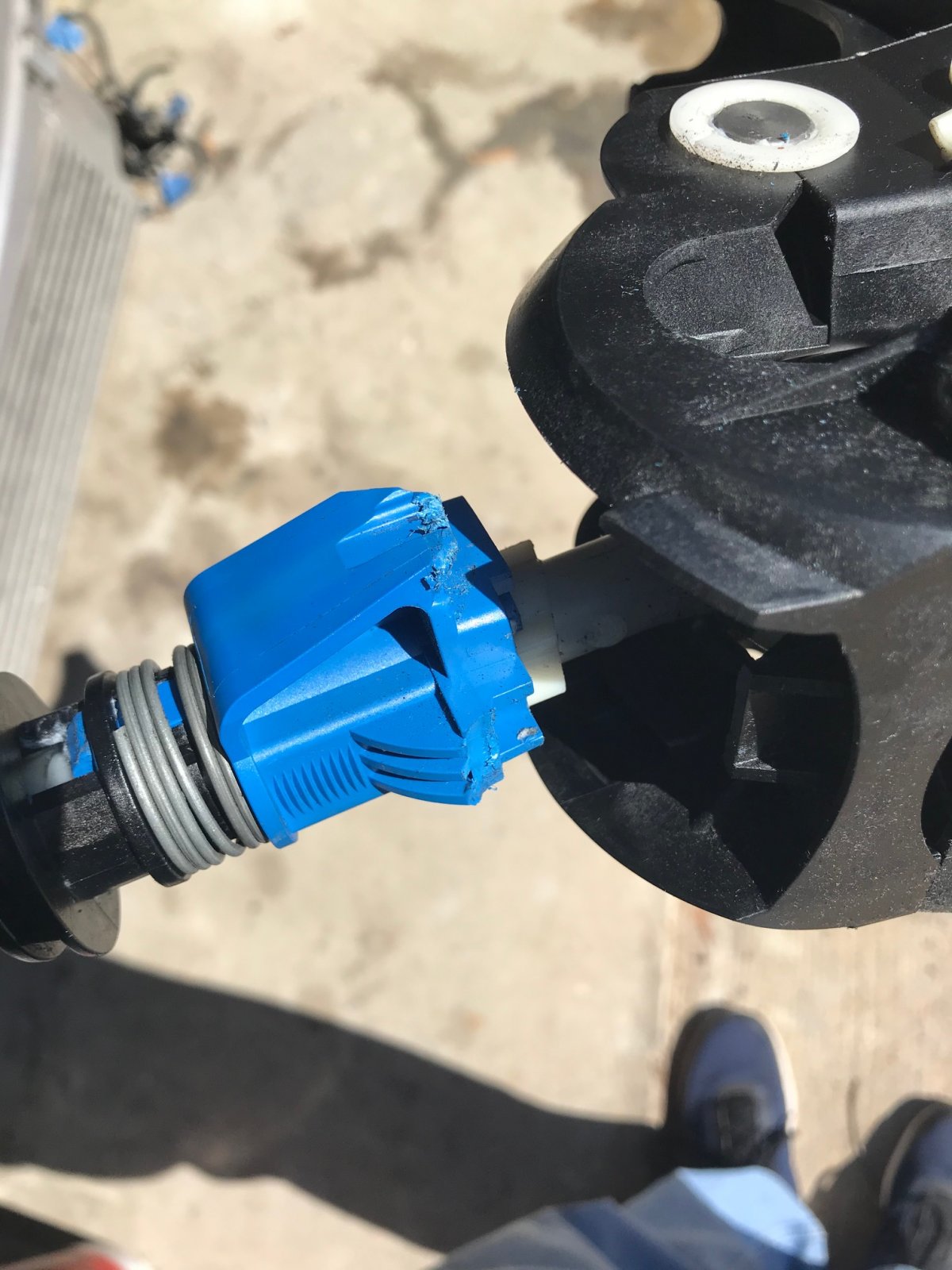

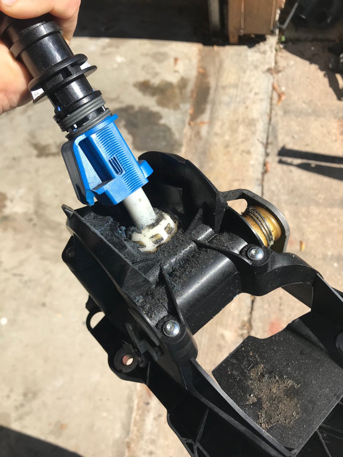

I have read a thread on the forum about someone developing a better replacement for the manual shifter. I can see why. Mine only has 82k. The plastic used does not look very good. Chevy engineers choosing materials that will last "long enough". Except they don't.
So are most of you reusing the shifter? Or, is there a consensus to upgrade it?
Only a few of us have swapped out the shifter... myself included.
I think someone put gravel or sand in your shifter, as mine was in much better shape than yours.
I can box up my old one and send it to you if you want to it. Just pay for shipping.
Or fabricate your own new shifter, like I did.
Ross: Thanks for the offer. I will consider it. Will do a little more research on options.

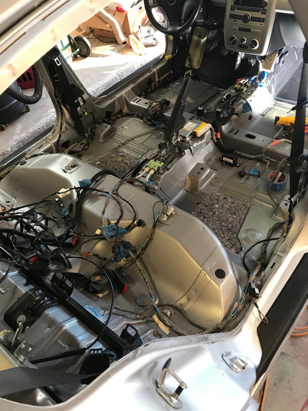

Worked around the lack of some specific tools (Prime delivery tomorrow hopefully). The two dash screws either side of the vent - holy cow they were hard to remove......
Made some good progress inside the vehicle, regardless.
Ross: Did you and Justin end up with the same solution on the shifter? How easy to duplicate?
Each of us did something slightly different. You can watch mine on YouTube.
Mine was a fair bit of fabricating, as I added a 5" moving arm that sits in the tunnel to reduce cable left/right stress.
JSATX (Justin) just left the cable to swing left/right. It might be fine. Ask him.
DC Money (Andrew) tried to make one that is less fabricating, he probably can procure some of his specialty parts.

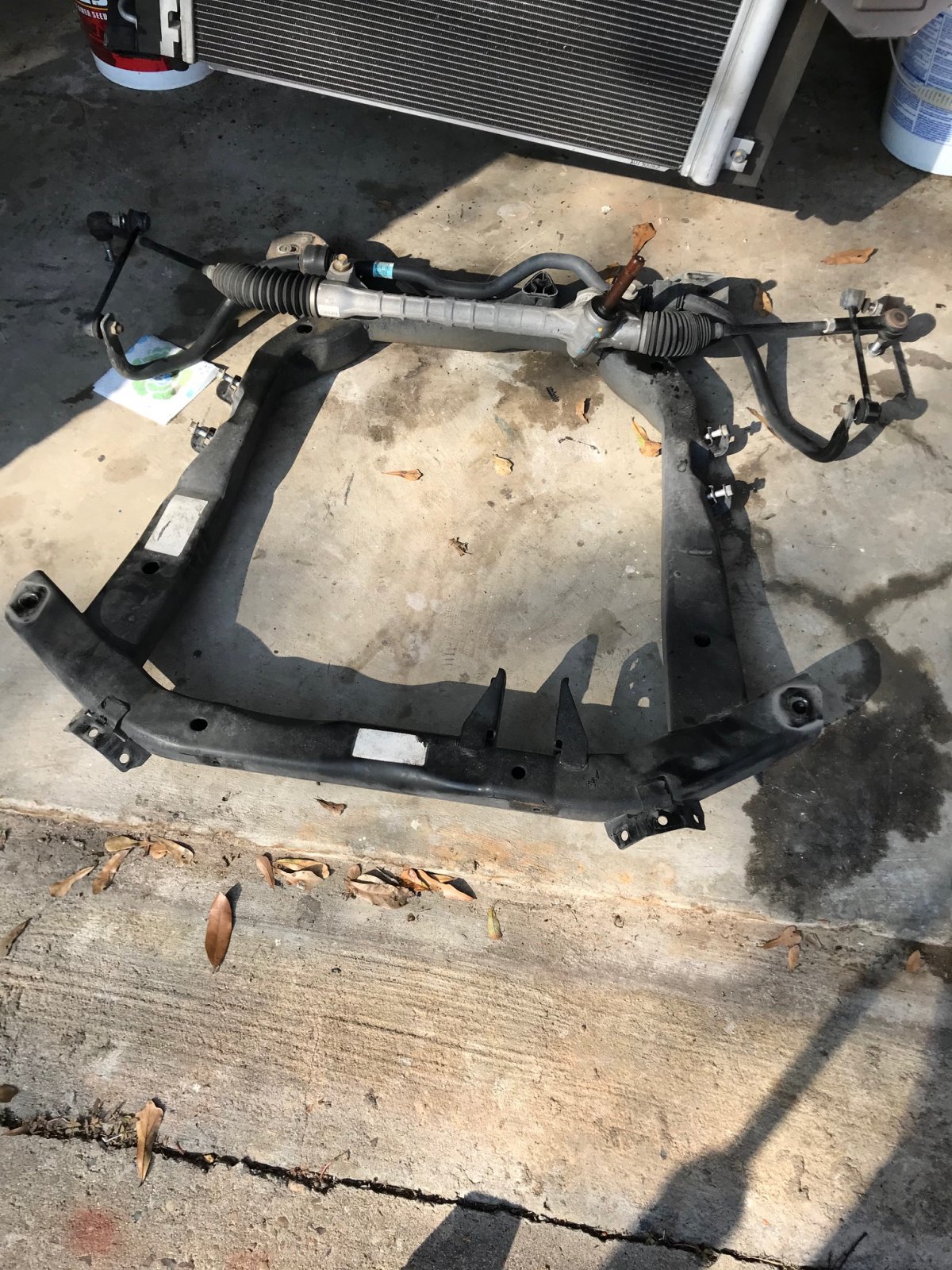

Milestone day. Subframe dropped. Hope engine tomorrow. Maybe dash too. If every thing works well....
T50 bit arrived so the seatbelts came out. Good grief those bolts were tight. Almost like they used thread locker. Messed up one of the Torx heads a little. Not sure how easy it is to find a replacement.
Murcielago311
Mine were already stripped out and had to cut both upper bolts.
A tip for anyone reading, heat them up first because they do have strong thread locker.
I haven't researched if those bolts get reused yet.
