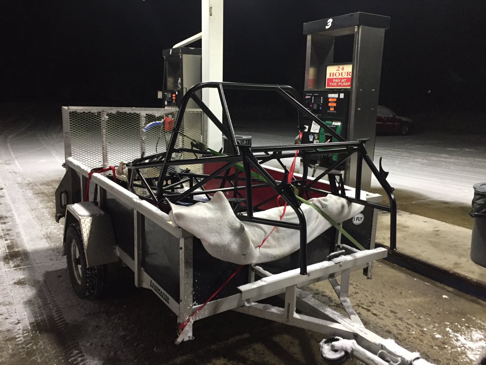

Hey all!
Long time listener, second time caller. I first got clued into the Goblin when Adam posted P1 or P2 on reddit a few years ago. I'm more into airplanes than cars, but I definitely like tinkering with all things mechanical. Finally moved into a house with a heated shop over the summer and came across a classified here offering a free pre-stripped donor. Perfect timing. So, now I've got stage 1 ready to go - just needed to start from video 10!
The motivation behind this build is actually a minimal-effort test to see if I want to take on larger builds (e.g. an airplane) at some point. It looks like most folks seem to take 200-300 hours at the outside, while the kind of airplane I'd want to build tacks a zero on to both of those numbers. So, yeah, quick test. And, bonus motivation, I get a fun car I can take out for ice cream (my greatest vice), autocross or even drag race for gits and shiggles, or try out a Cars and Coffee or something - never been to one of those.
I will be taking the lean approach to this build - scrounging for deals, taking my time, and hoping to keep a log of all the hours I'm putting in. So far I'm at 4h22m into the project.
Hoping to be done in time to drive it summer 2019, but we'll see.
IDRVSLO

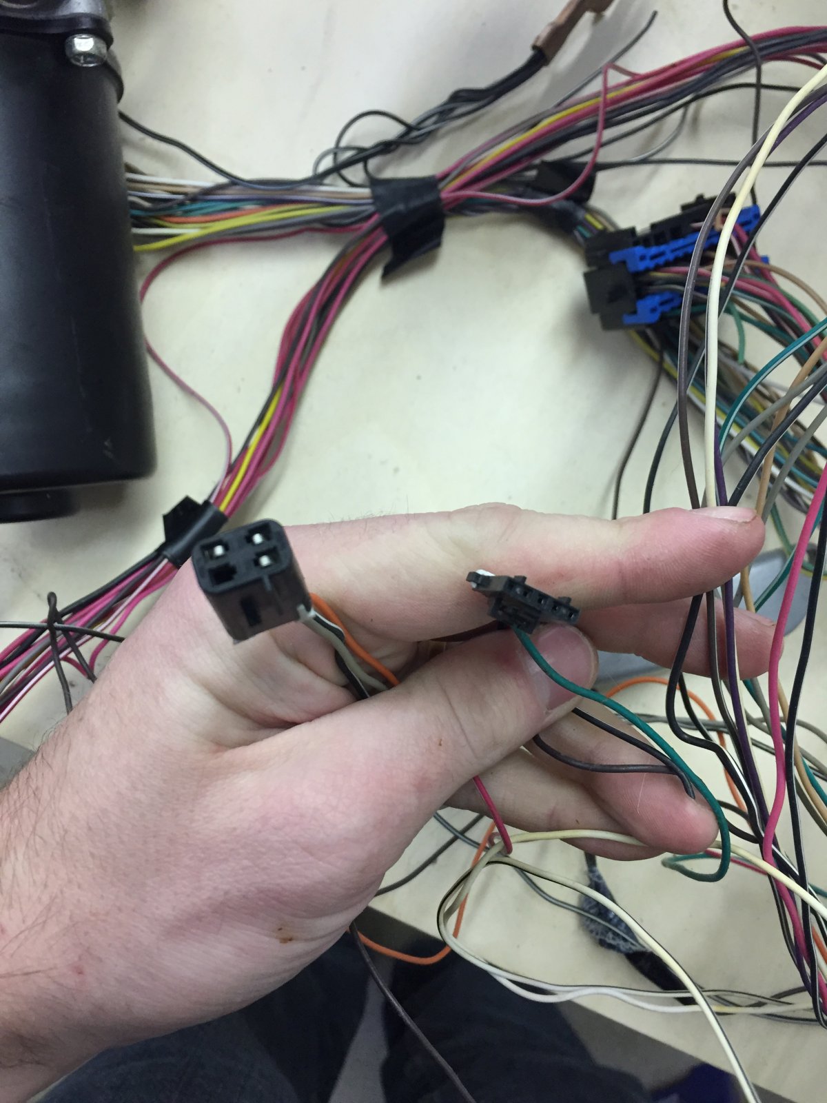

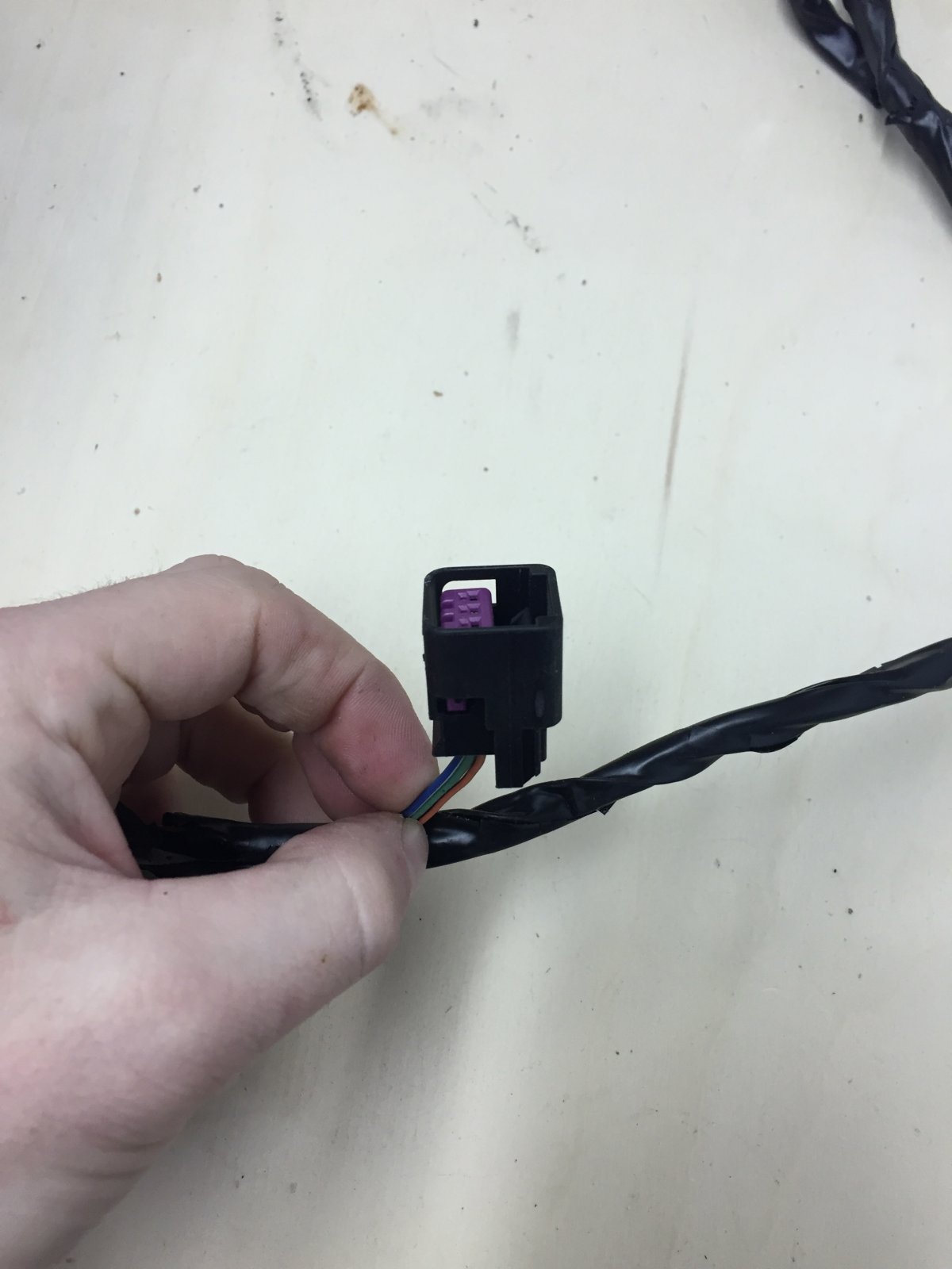

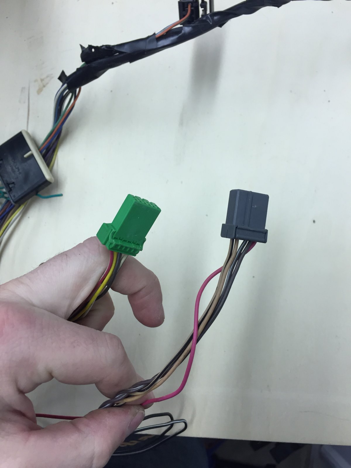

Finally got some time to slog through a bit more of the wiring harness, it's going well mostly but ran into an issue. Right at the beginning of build guide part 14, there's an instruction to tape "key fob receiver" wires for 18 inches. I cannot identify this plug for the life of me - it looks in the video like there are three leads - red, green, and black. I'm not seeing any 3-lead plug with these particular wires. Anyone know whether it might have just not been an option, or which of these plugs it might be?
Not having to disassemble my own donor has, so far, been great - but it's led to a few instances of head-scratching!
jpr

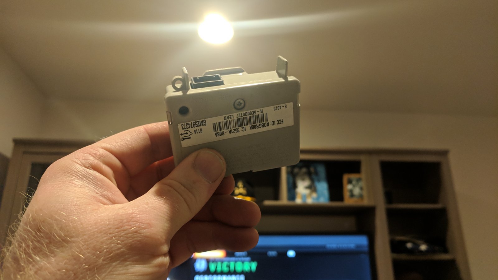

Thanks, I definitely have neither the plug nor the module. That's just the receiver for the door unlocker fob though, right? Probably the kind of thing a Goblin can do without, unless I'm missing something...
Yes, you can go without it. I'm using mine because it has TPMS, but if I remember right I think TPMS is only found on the newer models. I don't think yours will have that.

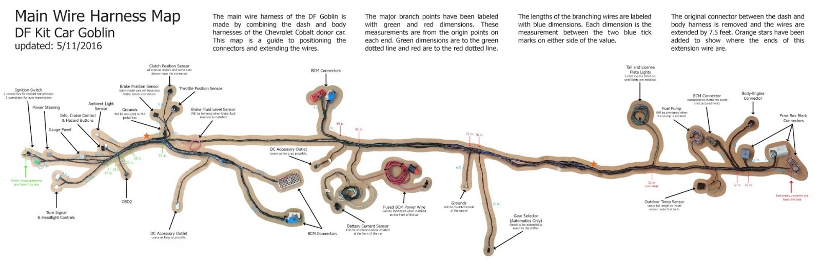

N
Also, if you can zoom in and see make out the words/images this was very helpful for me.... unfortunately i didnt run across it until after i was completed with the harness.
