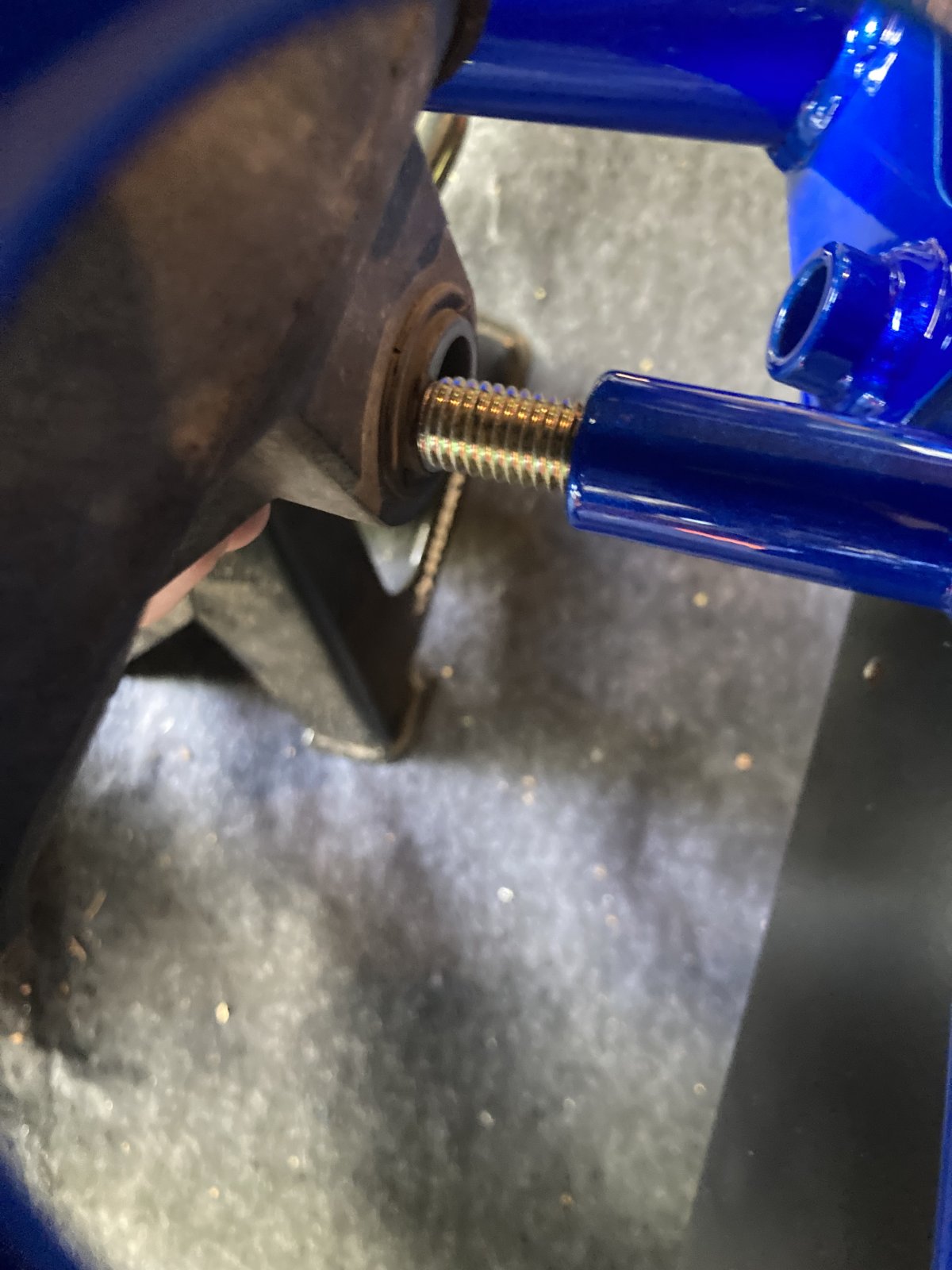

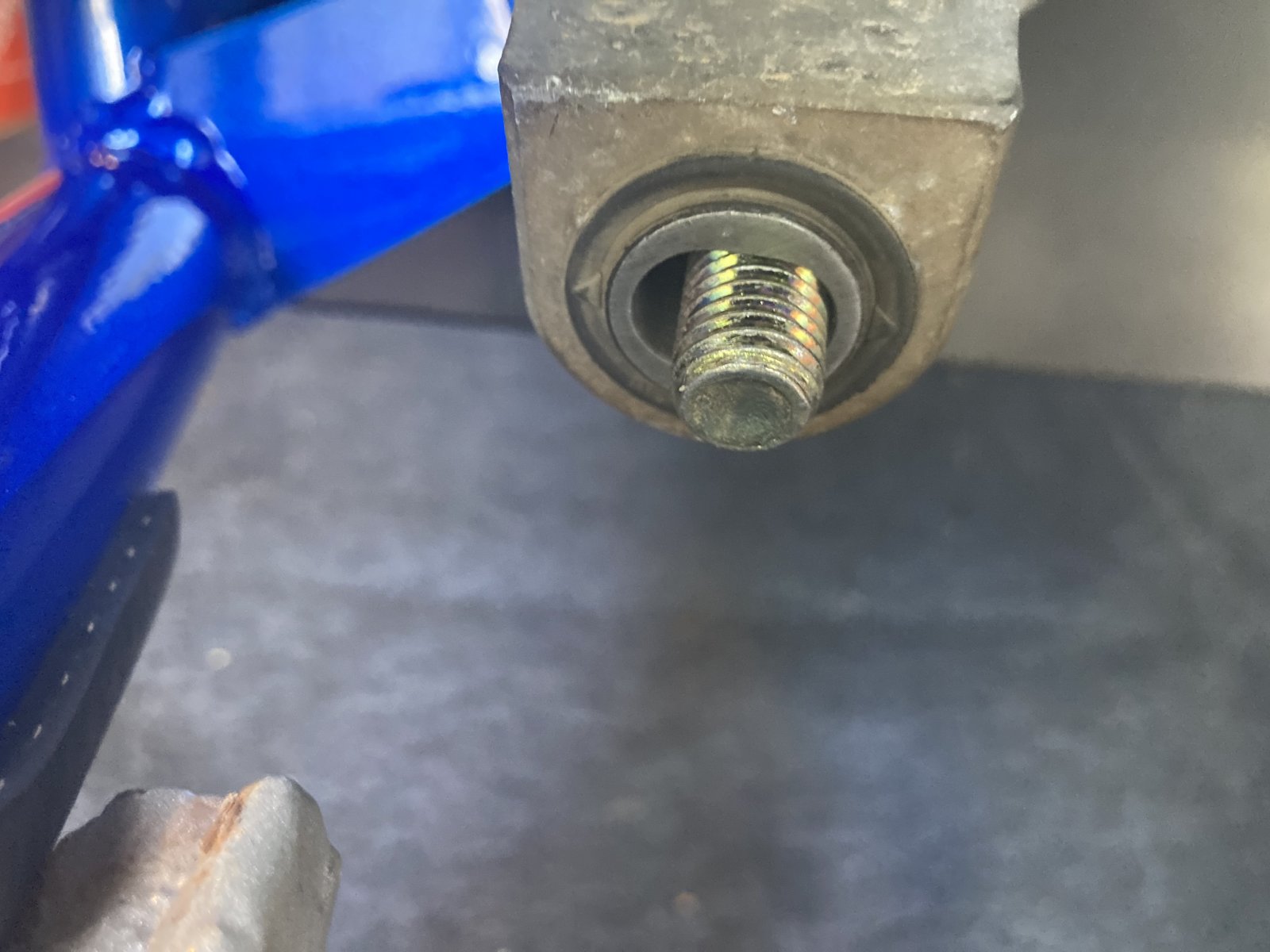

So I am trying to install the steering rack but there seems to be incorrect spacing for the steering rack holes.
They are too close together to fit both of the bolts in:
35821
35822
I can put the left side in but the right side will not fit and I can put the right side in and the left side wont fit. The photo shows one side in and the other side is off by a couple of millimeters. Not really sure what to do.
Not sure there's a good, quick answer for this one, first time this issue has been seen. Call DF and see if Lonny has an answer. I'm sure no one on the forum wants to lead you to a possible solution that could jeopardize your frame mounts or the integrity of the steering rack.
I have an idea, but contact Lonny directly first.
Brett
Definitely check with DF. Like the hairy one said, first time I have seen an issue like this report.
Wonder if you could put a ratch strap on the collar the bolt passes through and get enough flex to get the bolt in.
Since this is steering related, I would highly suggest contacting DF before modifying anything.
Brett

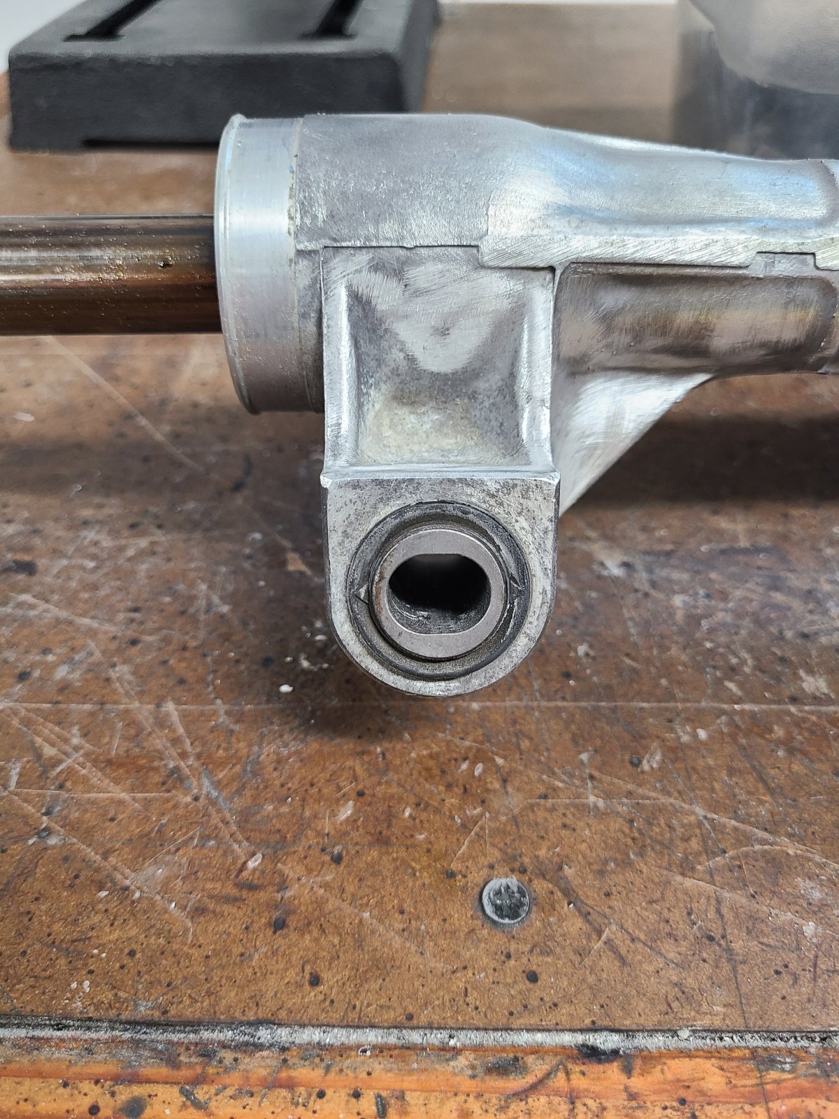

Does your rack has the slotted mount hole on the passenger side?
This should allow for some lateral movement if the frame mounts are slightly off.
My idea was to get a second slotted bushing and replace the round hole bushing.

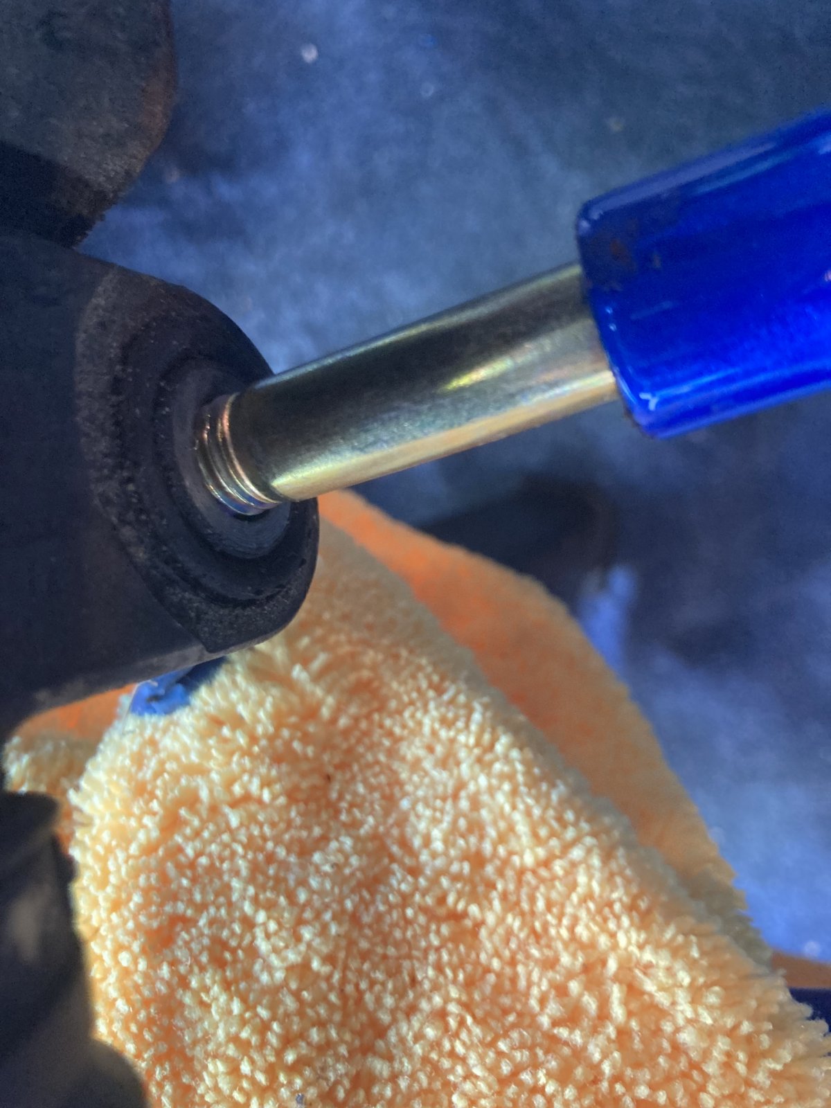

So a little update. I was able to flex it in place:
35824
It is extremely tight but it seems to be working and all. I had to use a mallet to hammer the bolts through. Now I have run into another issue where my steering shaft won't collapse and it also runs into the aluminum panel. Still not sure if I need to contact Lonny but if I find some time I probably will.

When you're welding stuff like this even with a jig those tight tolerance areas just have to be off by an 1/16th or a degree and you could run into issues like that. Add in variations in cobalt parts and even hardware and sometimes you just have to bring out the rubber mallet and massage it.
