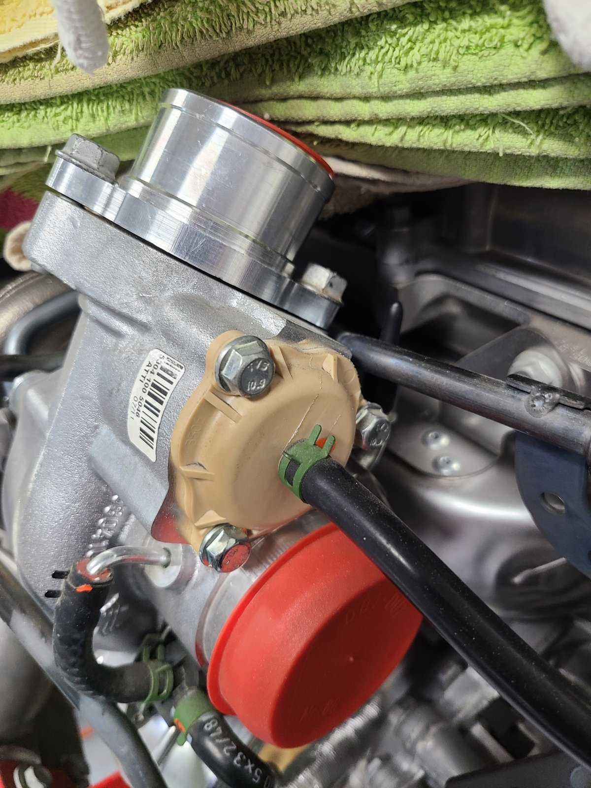

I'm looking for the LNF bypass valve cover diaphragm and spring. If anybody has one send me a price.
I have that one but don't have the right spring and could find a place that sells them. if you find the, let me know.This one?

Yes, that one.This one?
Holy crap, $156 for a piece of plastic!Found this on ebay, it's the only stock cover and spring kit I could find.

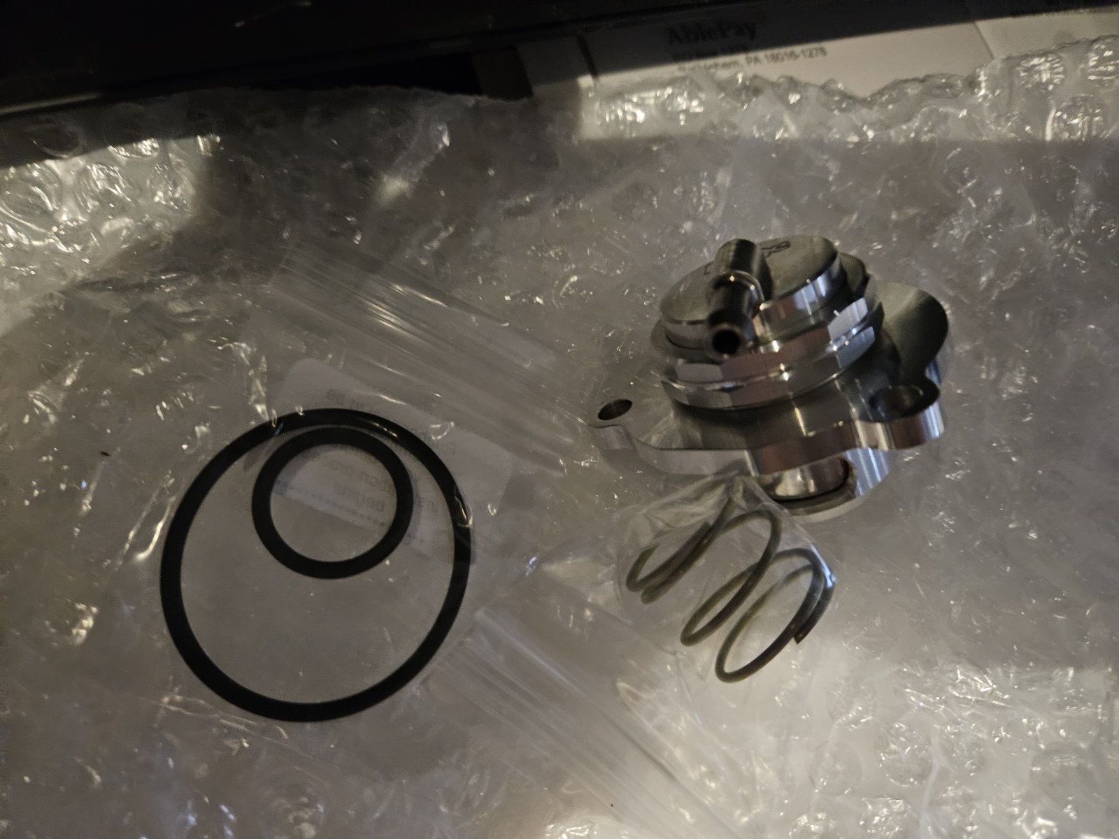

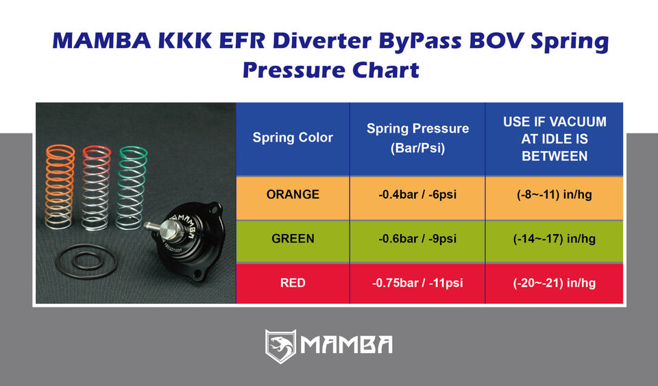

My Mamba valve stays closed causing turbo flutter. Based on the color of the spring and the research I did in the past, I have the 45lb spring.How do you know what spring you have?
10-4. I didn't know you had an aftermarket one. You could try reducing your waste gate duty cycle and torque to load table a lot and see what affect that has. I don't know if it will overcome a heavier spring though.My Mamba valve stays closed causing turbo flutter. Based on the color of the spring and the research I did in the past, I have the 45lb spring.
That would be awesome if you have it. Let me know.I put a forged motorsports one in my lnf. I'm pretty sure I still have the stock one in a box somewhere.
