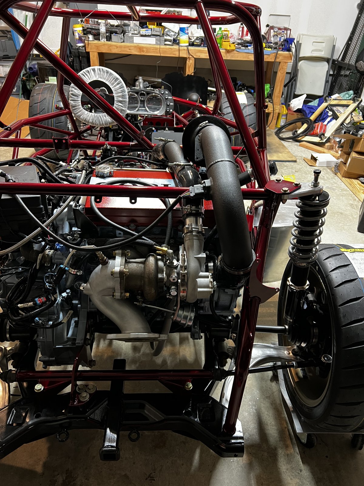

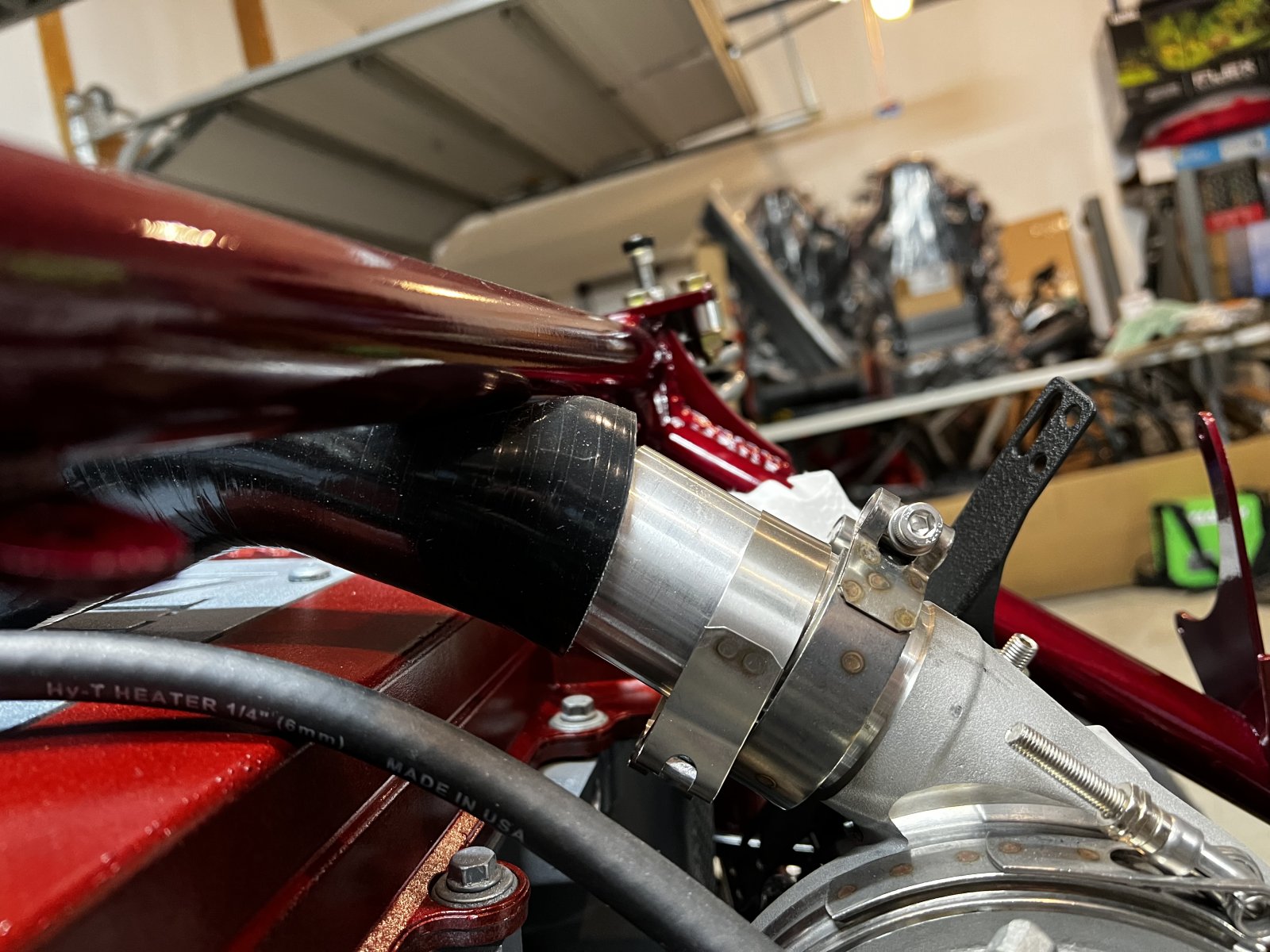

I did the LSJ-T swap with a z57 turbo. The charge side outlet was too long so I cut it down. I also had to clock the charge side housing so it angled under the cross member. More pics in my build log. This kit uses the LNF turbo manifold which is why I wanted to chime in.
before clocking:
After clocking:

@Indy Lonnie I have a 6758 with a bunch of pictures in my build thread. If you're doing all this work, I'd spring for the 6758 over the z54. I purchased mine used and it looks like it may have been an early version as there's a vband on the outlet like @r3drckt whereas now it looks welded as you mentioned. You can re-clock the compressor to achieve whichever angle works best for you using the vband you see in the pics above. I wouldn't go under the bar as it's pretty restrictive and just annoying to deal with.
