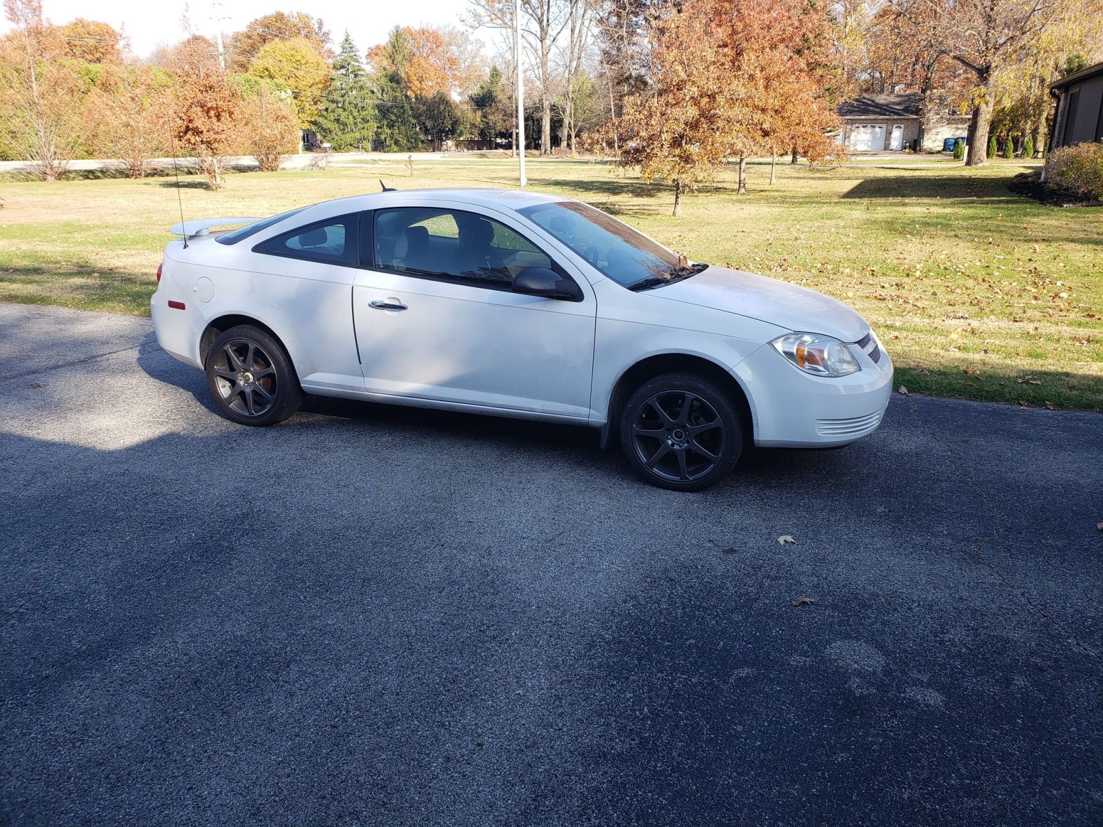

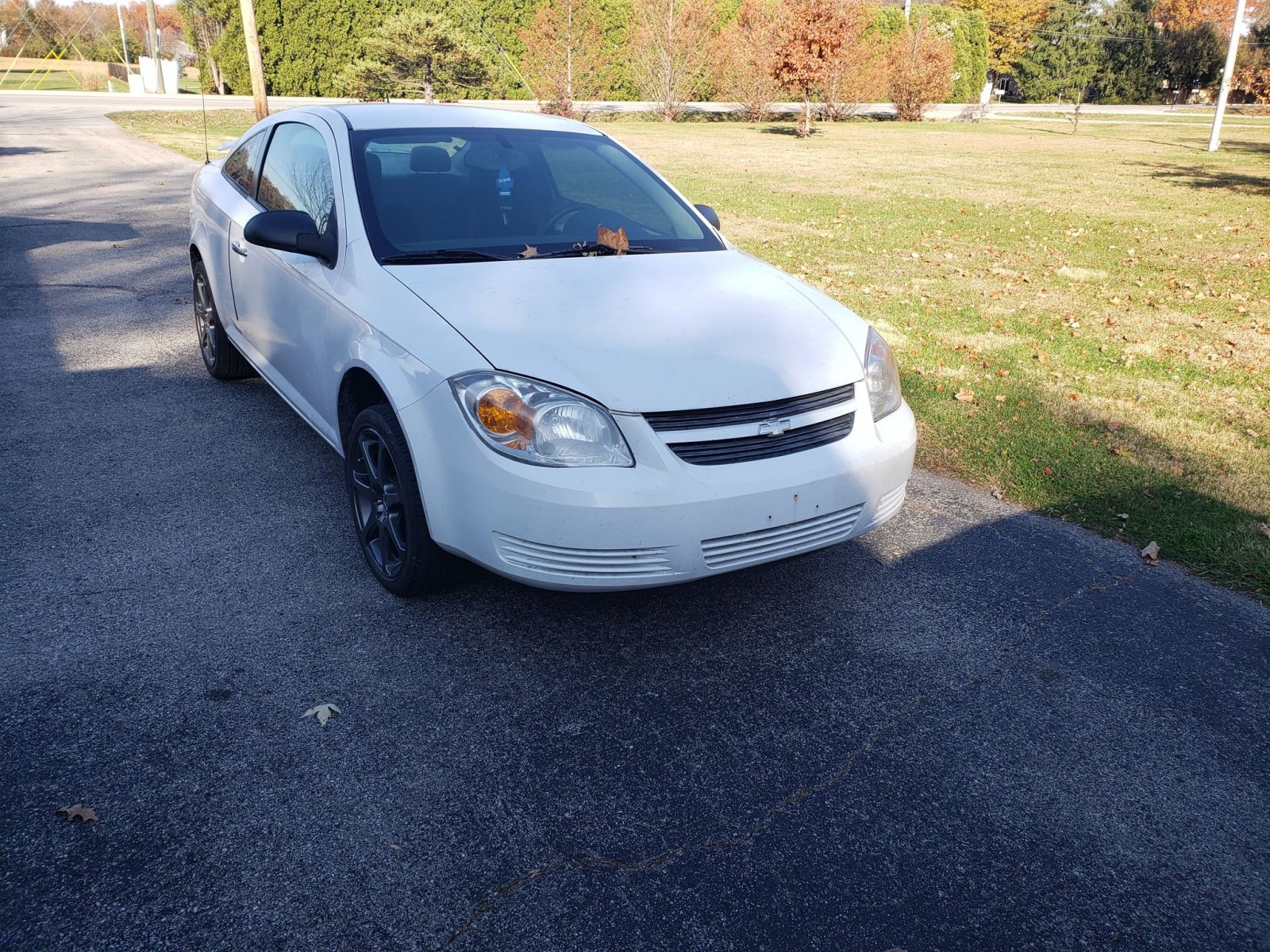

The bug has been inside me for years. I saw recent youtube videos on goblins after looking at other kits and fell in love with the look. I have been looking at a "project" for a while now and was going to wait a few as i'm looking at building a barn first. Welp... found a donor for a decent price and jumped on it... ordered my kit the next day :). I'm sure there will be lots of questions and a few angry yelling at bolts scenarios but im ssooooooo excited. Like a little kid with a new toy :)
Anyway here is the donor... 2010 LS with 147k miles on it. And so it begins.
