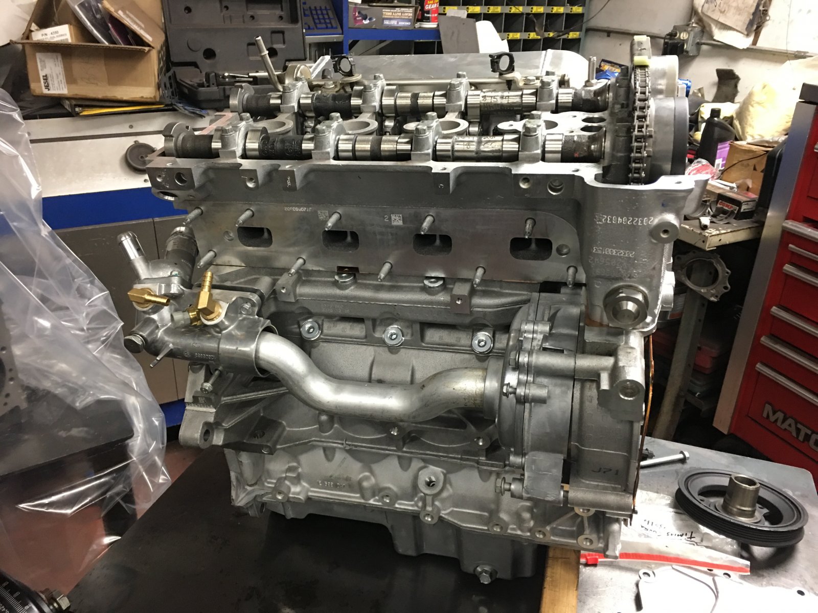

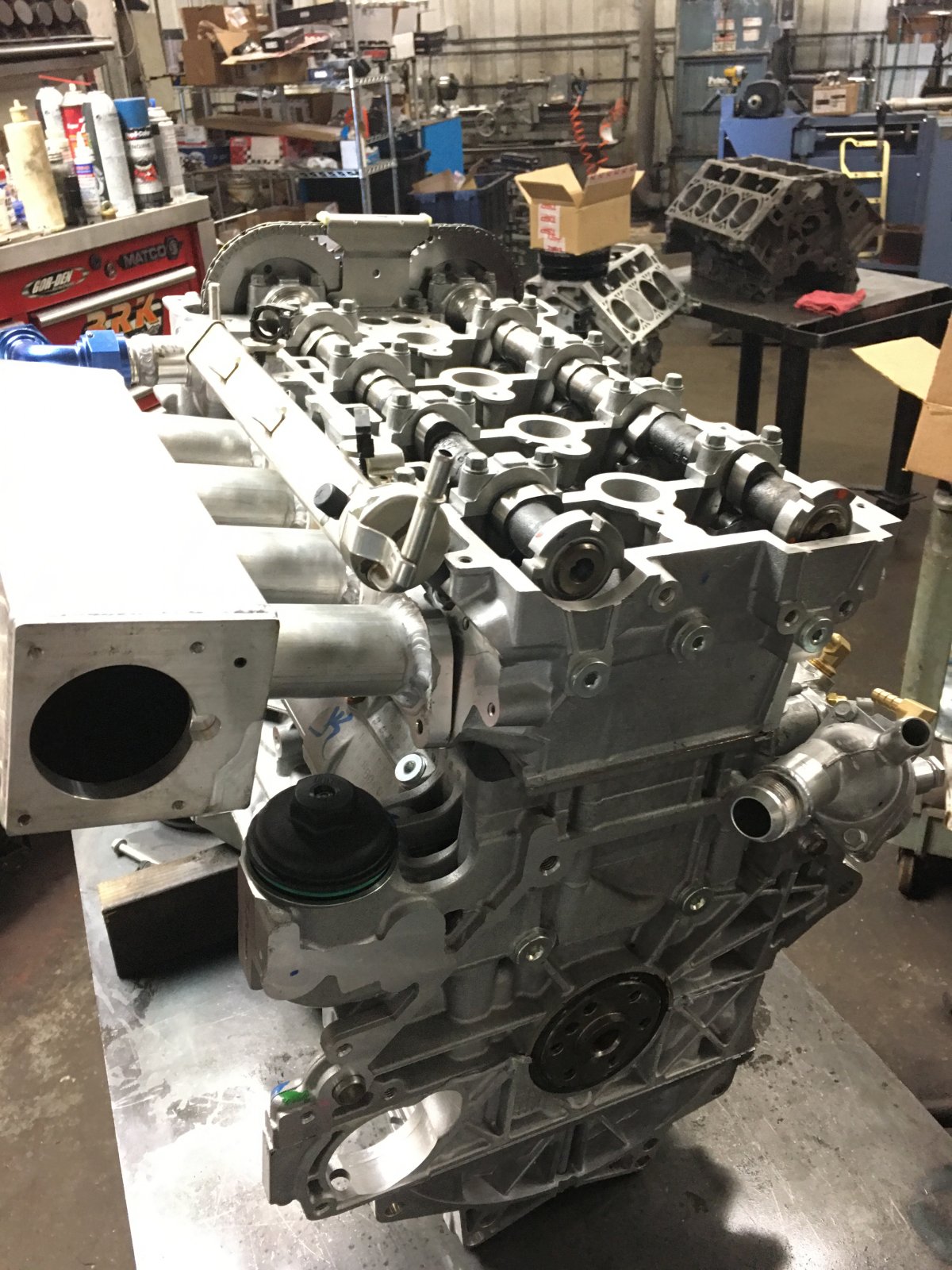

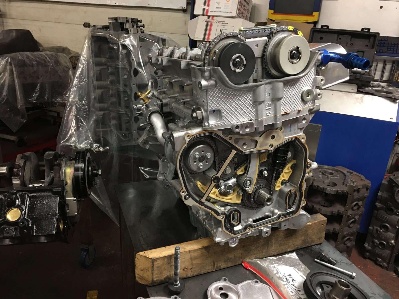

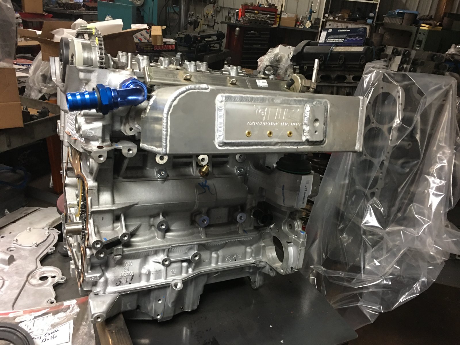

Good Morning,
I have been working on a little different route to upping the HP... Fully forged 2.4L with gen3 block and to start with a new BorgWarner turbocharger from an LNF (which can easily be upgraded) going to be running a completely stand alone harness for the engine and transmission.
THX,
Bruce

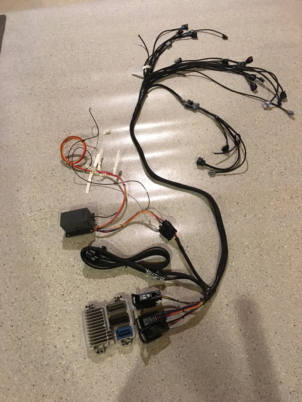

BAR-AIR
Good Evening,
I have been working with RDM Ecotecs... I’ll give more of an update as I get it up and running. So far the harness looks really good (Alpha Fab’s also looked good but never worked ). Good news is Rich actually returns my calls and answers questions. We are still working out a couple of the connectors (some differences but we are close).
THX,
Bruce
