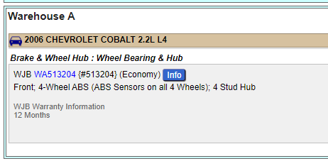

I found it. I have MOOG in the rear (donor front) and this piece of junk in the front. I cannot believe I didn't order a MOOG!!! It's out of warranty by the way. only two years on them.

You all have me talked into the Timkin, they are available on RockAuto, but my order was already placed. The MOOG has a 3 year warranty. The previous wheel bearings didn't.
