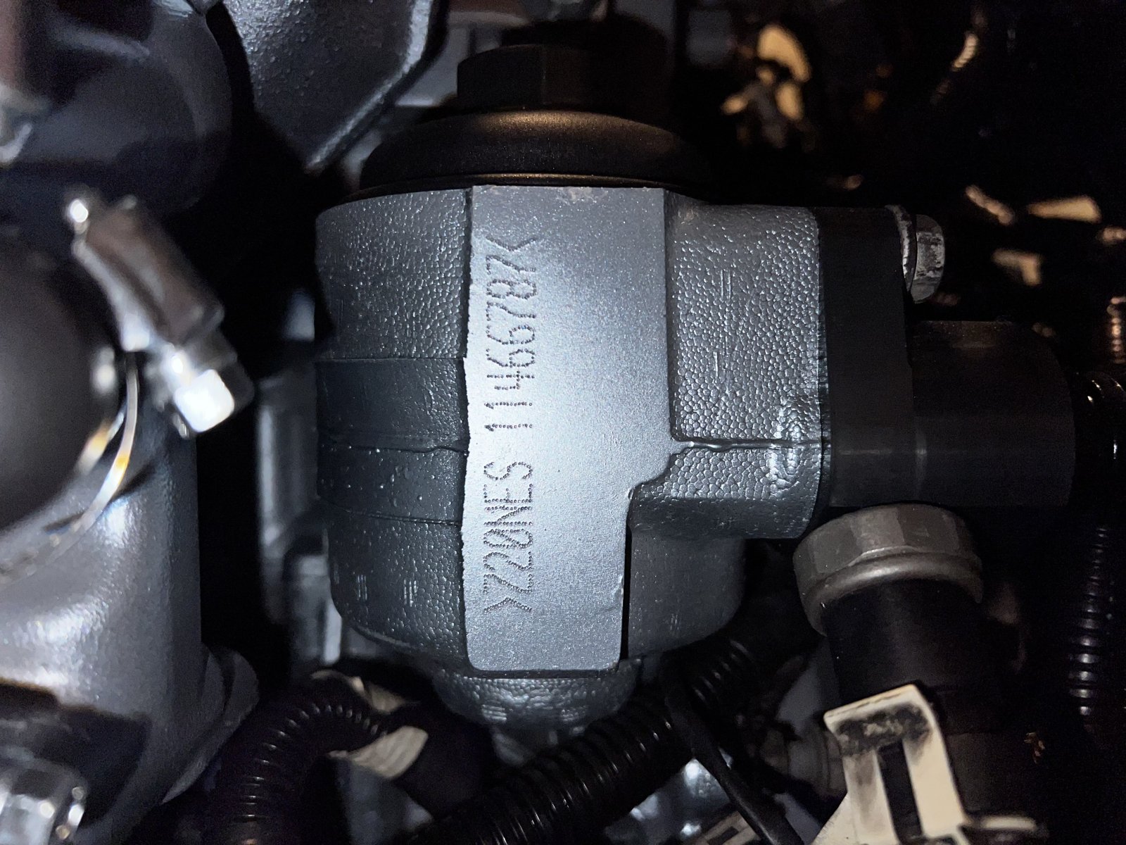

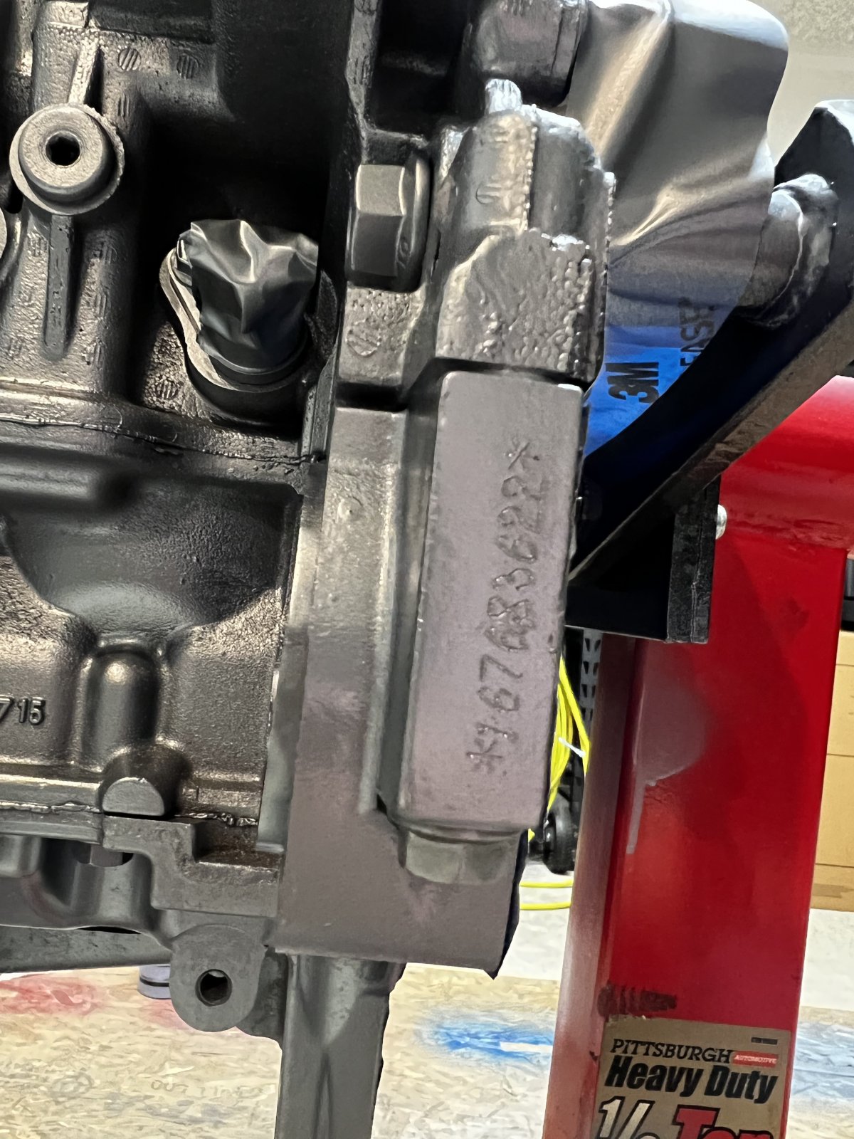

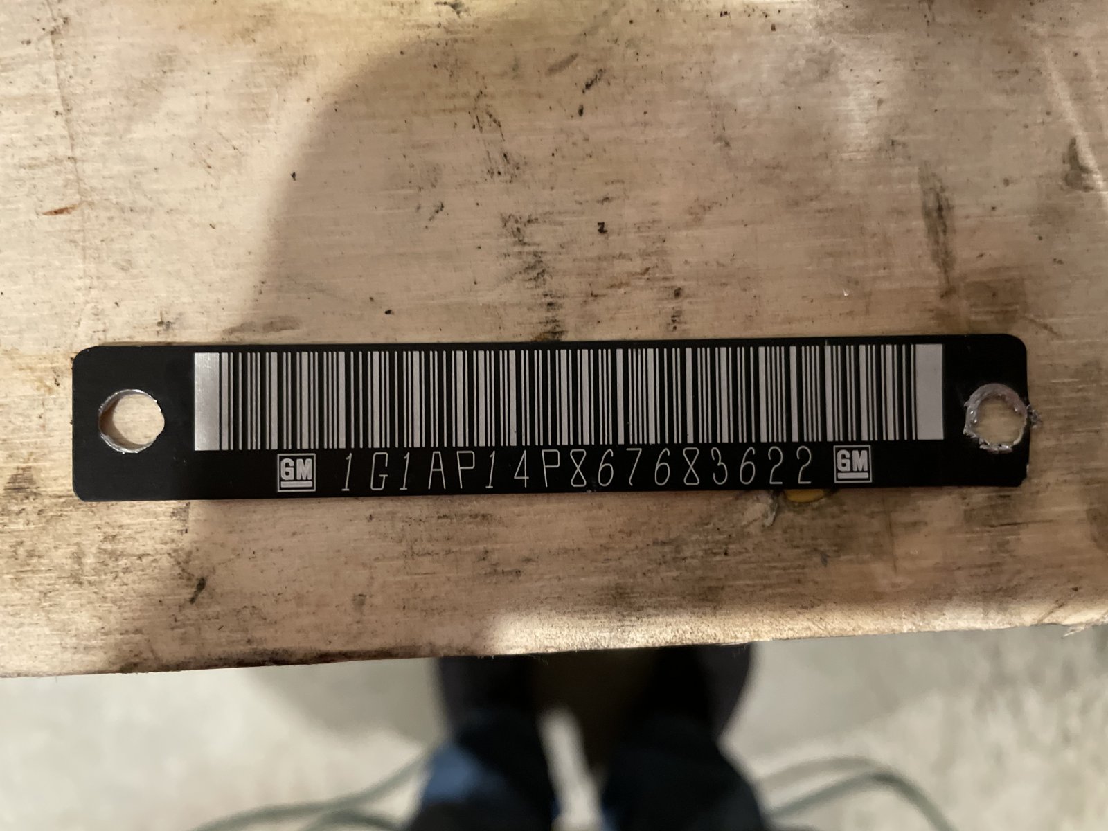

my vin plate from the donor and my vin on the engine block. Wasn’t on the oil filter housing, was on the side where the starter goes. The one on my oil filter housing is different than my vin.
you can see the one on my oil filter housing, and then where the vehicle matching vin is in reference to it below:
R
Like @Gtstorey said, engine serial number is on the side of the oil filter. The vehicle VIN will be on the starter mount of the engine block. Reference my pictures above.
They are different numbers and don’t appear to be related in any way
