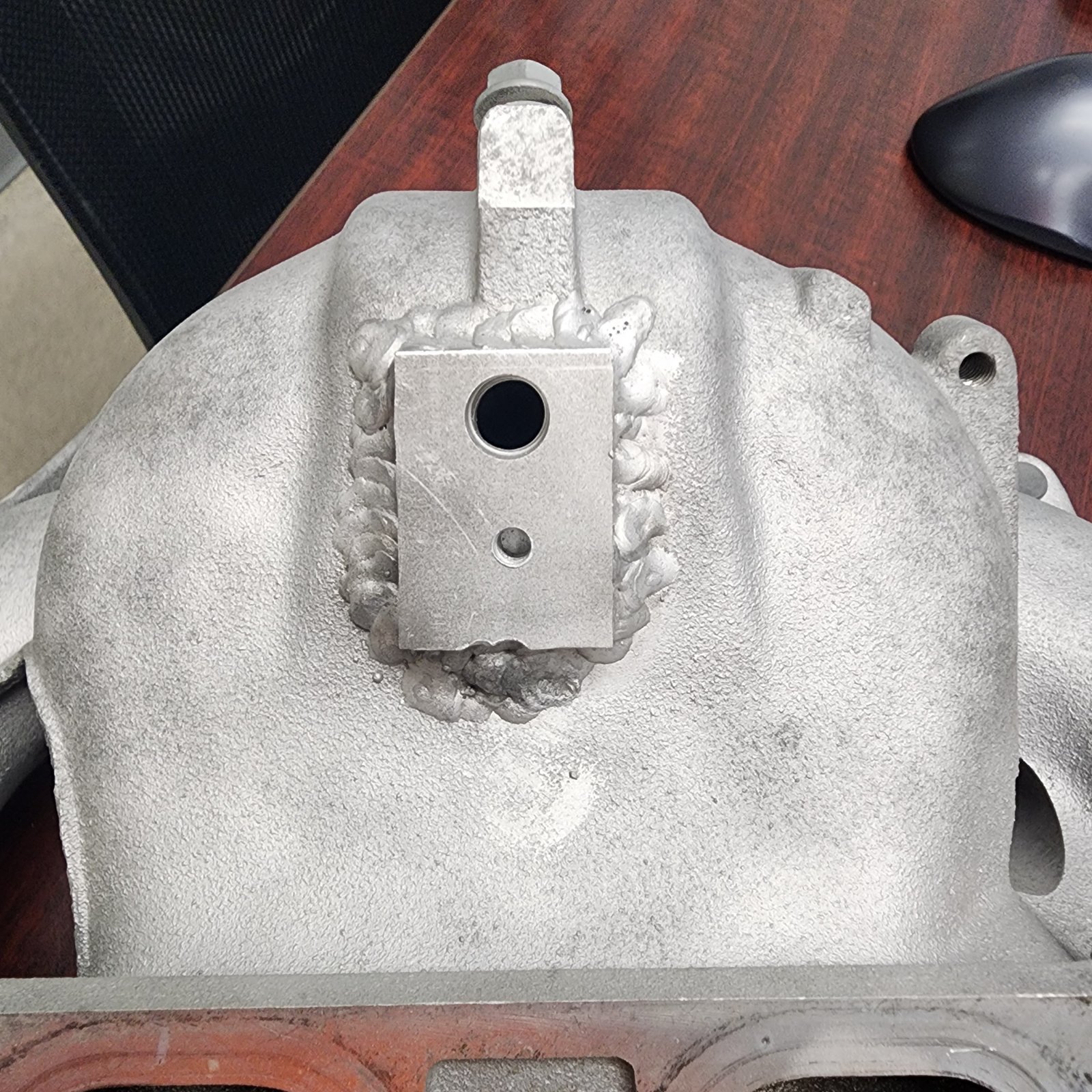

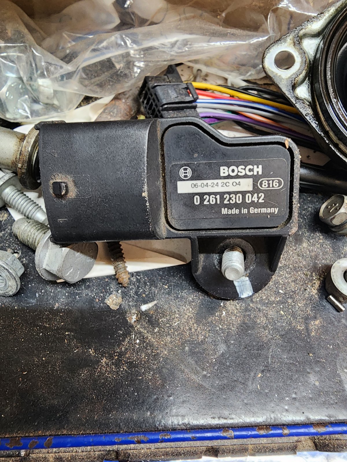

I'll have to check part number after work. As for fitment on to the new manifold you have to weld a piece of aluminum on the bottom of the Saab intake to make a place for the MAP sensor. Like so.
39091
Looks like I should have done a better job reading the info on the turbo kit. It doesn't say anything about changing the MAP sensor just that you keep the factory one.
