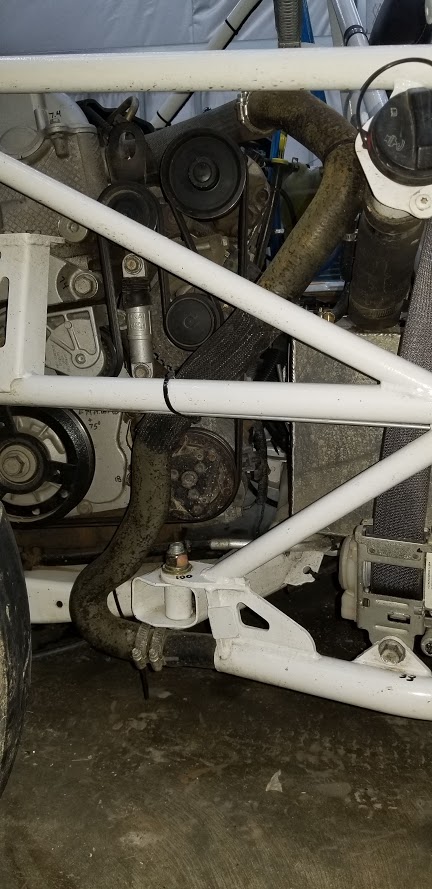

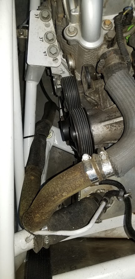

ccannx
It doesn't make it all the way to the top but it has all the right bends to get around the belts. It works really well but doesn't look as nice as the pipe. I believe someone mentioned using a swaging tool to make the pipe work.
The side and top view with the stock hose. I zip tied it to the frame and to the gas vent line to hold it away from the pulleys.
11229
11230
I got caught in the rain yesterday, and it left the hose looking brown and spotty. Doesn't usually look this bad.

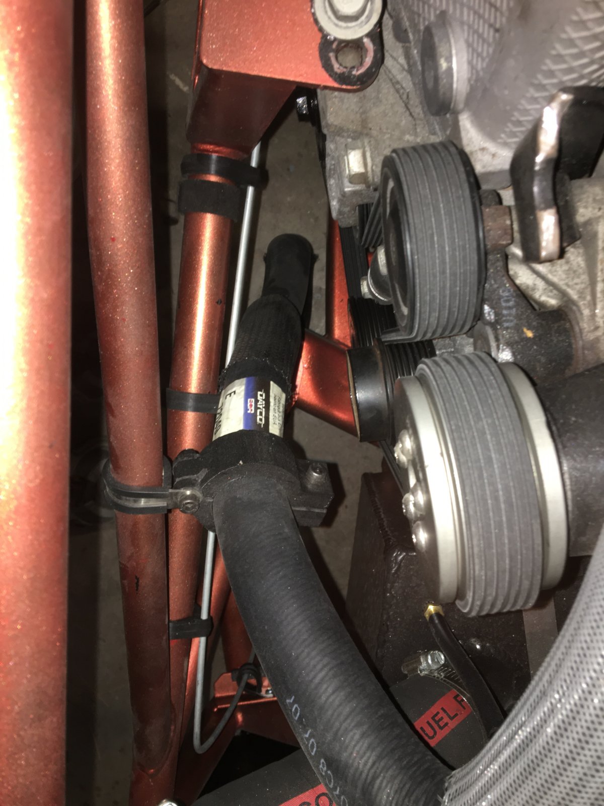

On an LSJ engine (in a Goblin kitcar) a coolant hose routed over top of the SC snout is a coolant hose "taking the long way around" ...
The way we did ours can be seen in this video. Zero kinking and it's been working great. It was made using hoses we received from DF in our stage-two kit.
The way we did ours can be seen in this video. It's been working great and it was made using hoses we received from DF in our stage-two kit.
That looks considerably shorter. Nice!

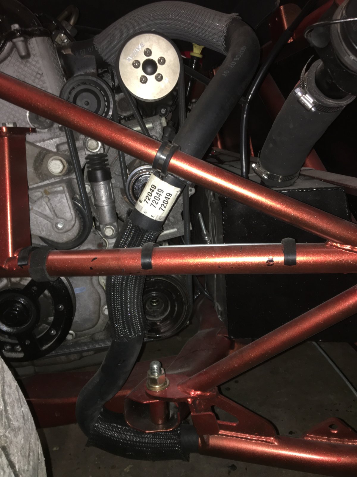

Here is what mine looks like. I used one of my 1.5 inch bar clamps around the hose and a 1 inch rubber clamp around the frame just for added security.
