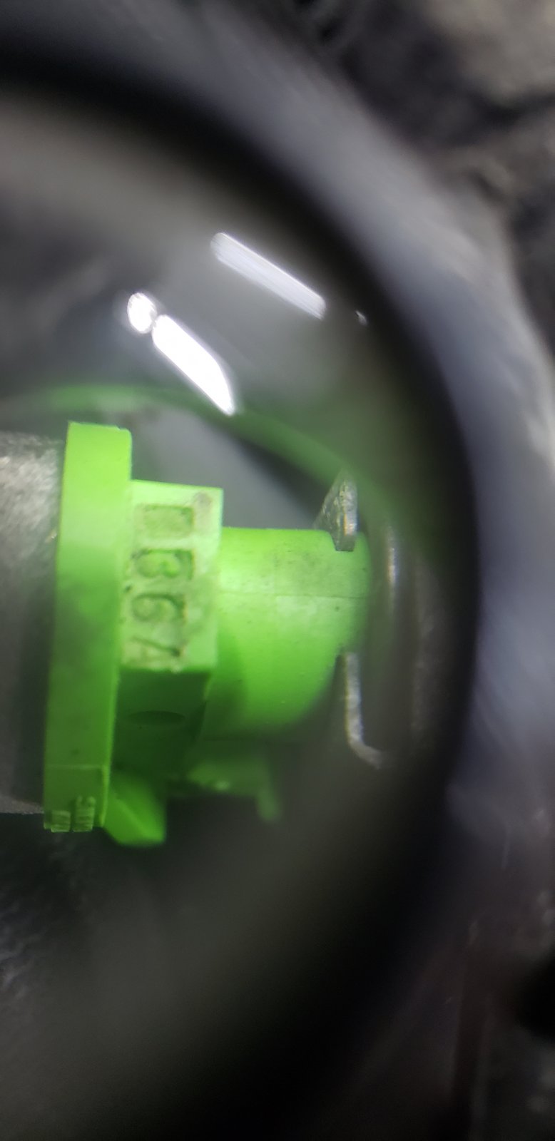

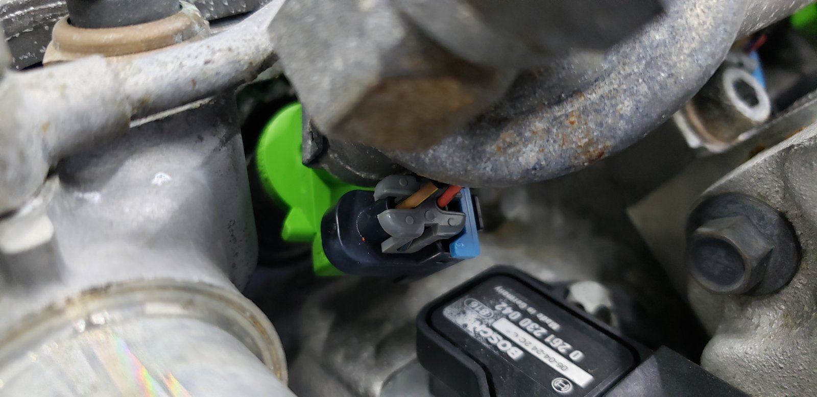

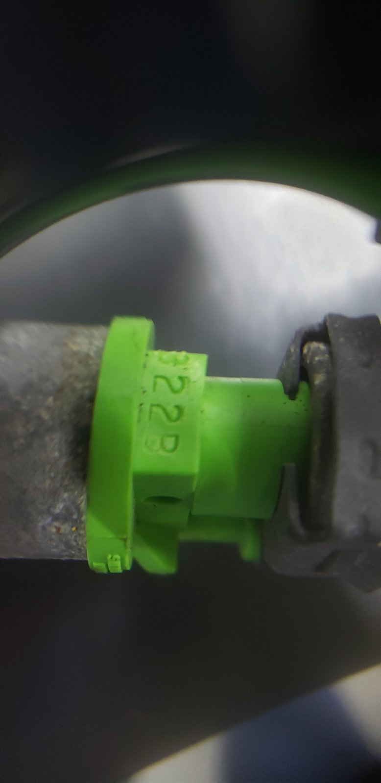

Can anyone identify these injectors? They look awfully clean and the wire harness looks newer than the rest of the engine bay wiring. I saw somewhere that some companies color code theirs.

The injectors are easy to remove. Can you see the number on the injector itself? It is a common performance part to swap in.
Those bright green injectors are the stock 32lb/hr injectors that are in my 06 LSJ.
Those injectors run 98% duty cycle at redline (6500 rpm), so they need to be upgraded to rev this engine higher.
I think later years got the black 42lb/hr injectors.
