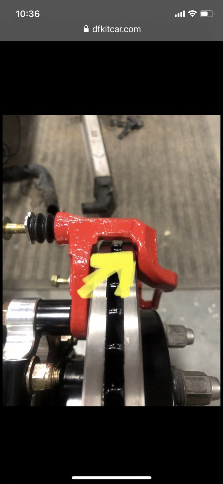

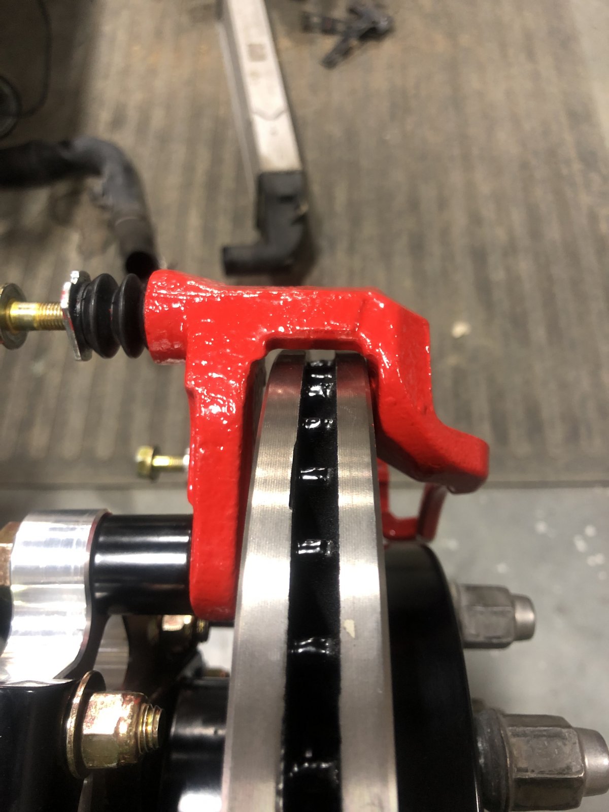

I’m installing the Front Bearing Hubs today. They definitely bolt right into place. However, the issue I’m having once I installed the calipers, the rotor is hitting an won’t spin freely.
TheNuker
I think 2 of the calipers have cutouts to clear the front rotors, if I recall on my SSTC build 2 calipers fit and 2 hit the front rotors.
so be sure to check that.
nuker
2.0 Turbo
Thanks for the reply.
Currently the rotor is hitting towards the outside.
The Rotor is from DF. The Bearing was Malibu non-ABS. Adding the plastic ring supplied from DF to the hub before installing Rotor made the issue worse. I can remove an compare to Donor unit tomorrow.

I just watched the DF video again an the plastic ring is for 4 lug wheels. I’m building a SS an wondering if the Brake Caliber is the same for Non SS an SS Versions?
TheNuker
As far as I remember the SS gets all 4 new brakes and they are basically 4 of the same caliper as the base model has on a cobalt. You should have 5 lug wheels, unless your building an SS/SC and switching to the base model 4 lug. Which you can't as easily do with a turbo car.
Nuker-
You can shim the caliper.
2.0 Turbo
I believe the bearings I purchased are defective.
i added the spacers an was able to have nice clearance. However, when I spin the wheel, the Rotor moves in an out 1/8 to 3/16”. Yikes!!
I removed the Rotor an spun the Bearing an I can see the wobble.
