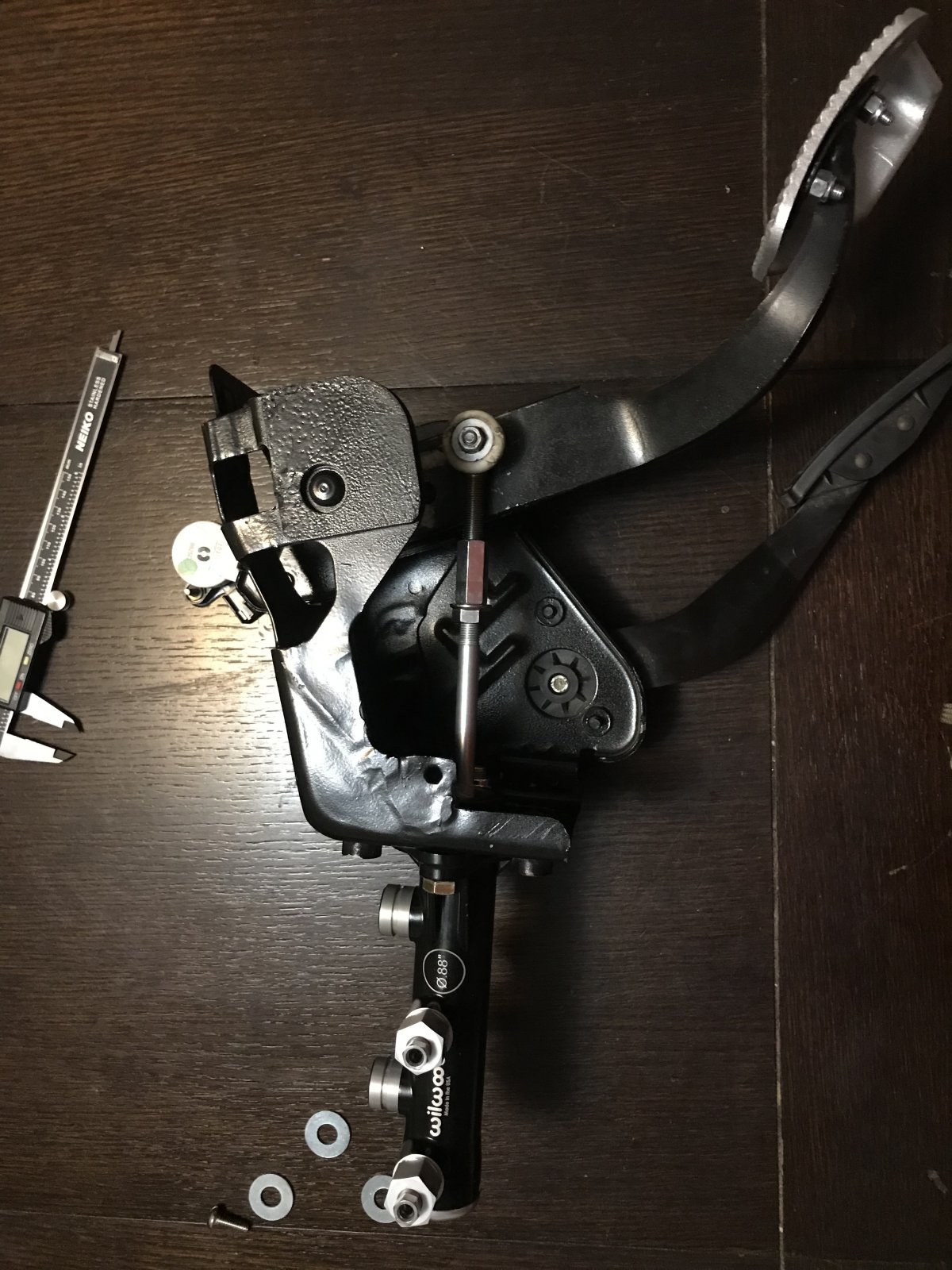

Wilwood makes an out of the box solution. It’s a remote fed tandem master cylinder. 7/8” is the smallest size and that’s what you want for mechanical brakes as it increases the psi at the caliper. Part number 260-14241-BK

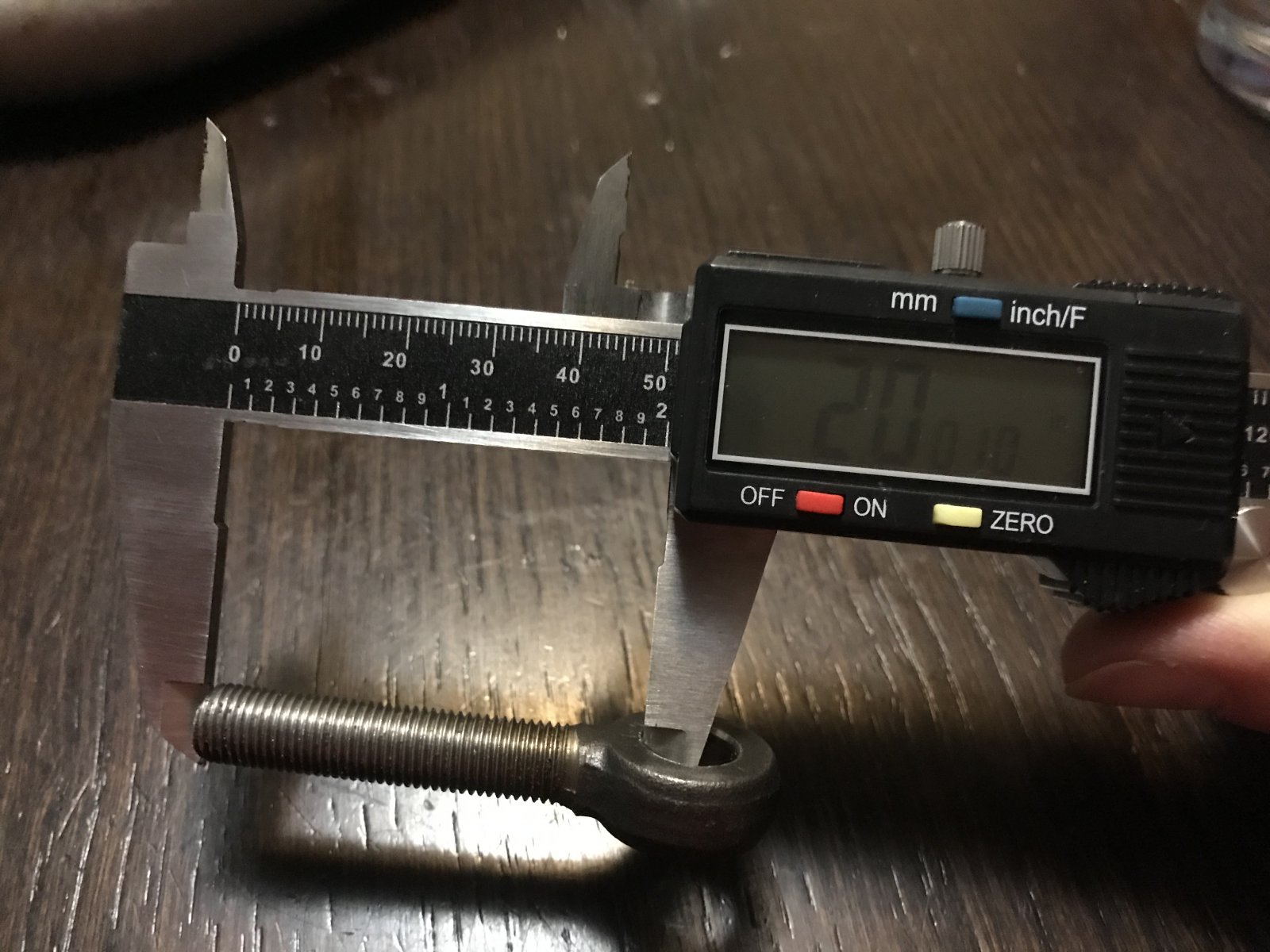

Next you’ll need a way to link the pedal to the master cylinder. The MC comes with a rod threaded 3/8-24. You’ll need a threaded coupler, 2 lock nuts, and a solid rod end. Now of course no one makes a direct fit rod end, I used McMaster-Carr PN 2434K51 which is the closest thing to the stock GM pushrod I could find. You’ll need to open the bore up from 3/8 to 7/16 to fit the pedal stud. Next you have to cut it down. My measurement was 2.00” from the inside edge of the bore and that’s for a stock configuration. After I make sure everything’s functioning I plan to cut it down significantly to bring the brake pedal next to the gas. But that involves modifying the brake potentiometer and I don’t want to deal with that just yet.
7761
Then it’s as simple as drilling two 3/8” holes in the brake pedal box, mounting the MC, and screwing it all together.
7763
The MC comes with standard 3/8-24 double flare fitting adapters. You’ll need to cut the old GM metric fittings off the front and rear hard lines and install standard 3/8-24 fittings. I got a dozen stainless fittings from amazon for about $8.
