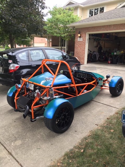

I went front: 15 x 7.5 ET 35 with 4x100 -205/50R15 tires and rear: 17x9 ET 40 with 5x114.3 - tires 255/40R17. I think the stance is perfect. The rear tire height is the exact same as my Cobalt (no speedo issues). I had Lonny drill the rear rotors and hubs. It is also what the Ariel Atom comes with... You will not need special pads or rotors. What comes with the kit is more than enough. I believe the front hubs are Honda. I got pads from Advanced Auto. Next to the top ceramic pads. The rear fenders are perfect, the front I think were designed for 16" 205 tires.
