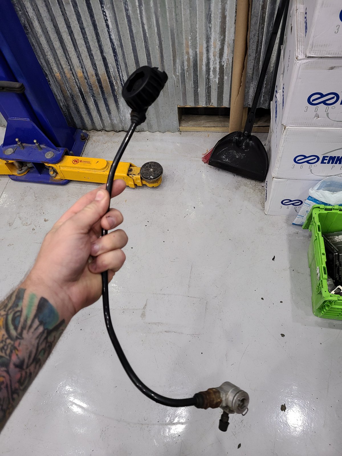

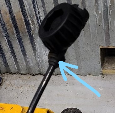

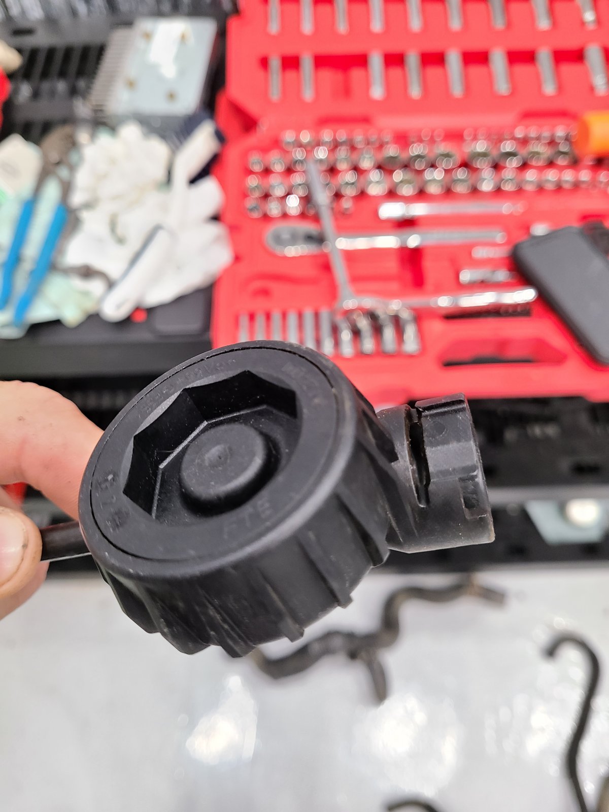

SO I believe this is my clutch line from the slave cyl to the nipple on the trans however it doesn't seem to have a clip to connect the slave cyl to the line. Does anyone know what that clip is called? Been looking everywhere. The original one was too rusted and is in pieces.

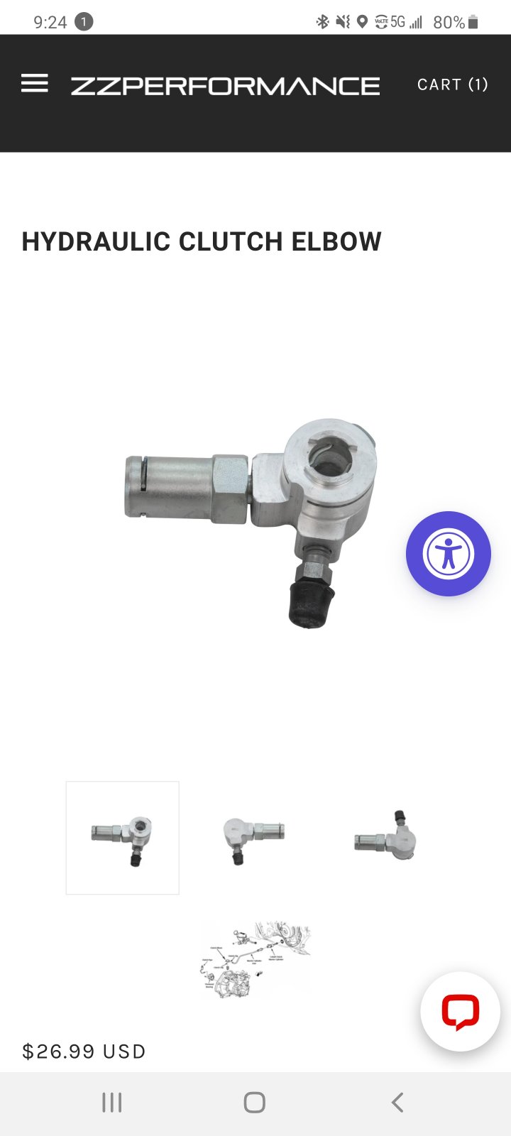

The Goblin has a new clutch line, so you only need the aluminum distribution block. The GM line and that plastic thing aren't needed. I bought a new GM distribution block from the chevy dealer, but you could probably bend one out of a paper clip wire.
Kenny123
Oh great to know! I was wondering if it came with new lines seeing as the clutch line is now routed to the rear but wasn't sure. I will look for that part number for the block now. Thanks dude!
