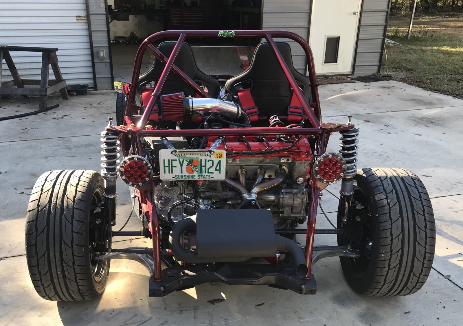

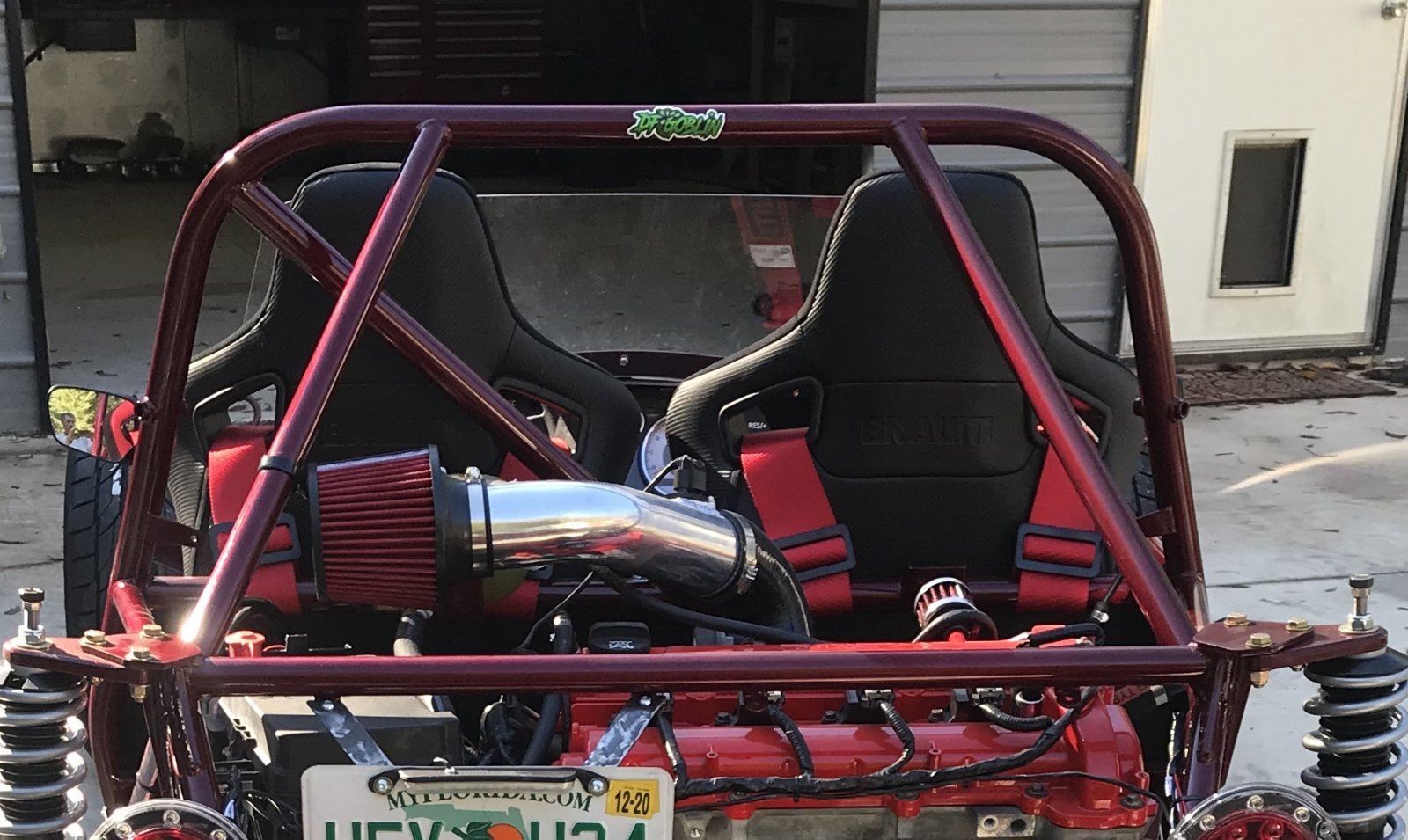

Tinkles
Among the things I had modified on my chassis was adding a harness bar. I forget the exact height it is at, but if you mock up your seats 1st you'll be able to see where it needs to be.
19534
PaulPerger
Saving this picture as reference... This is exactly how I want to do mine. Thank You Tinkles!
