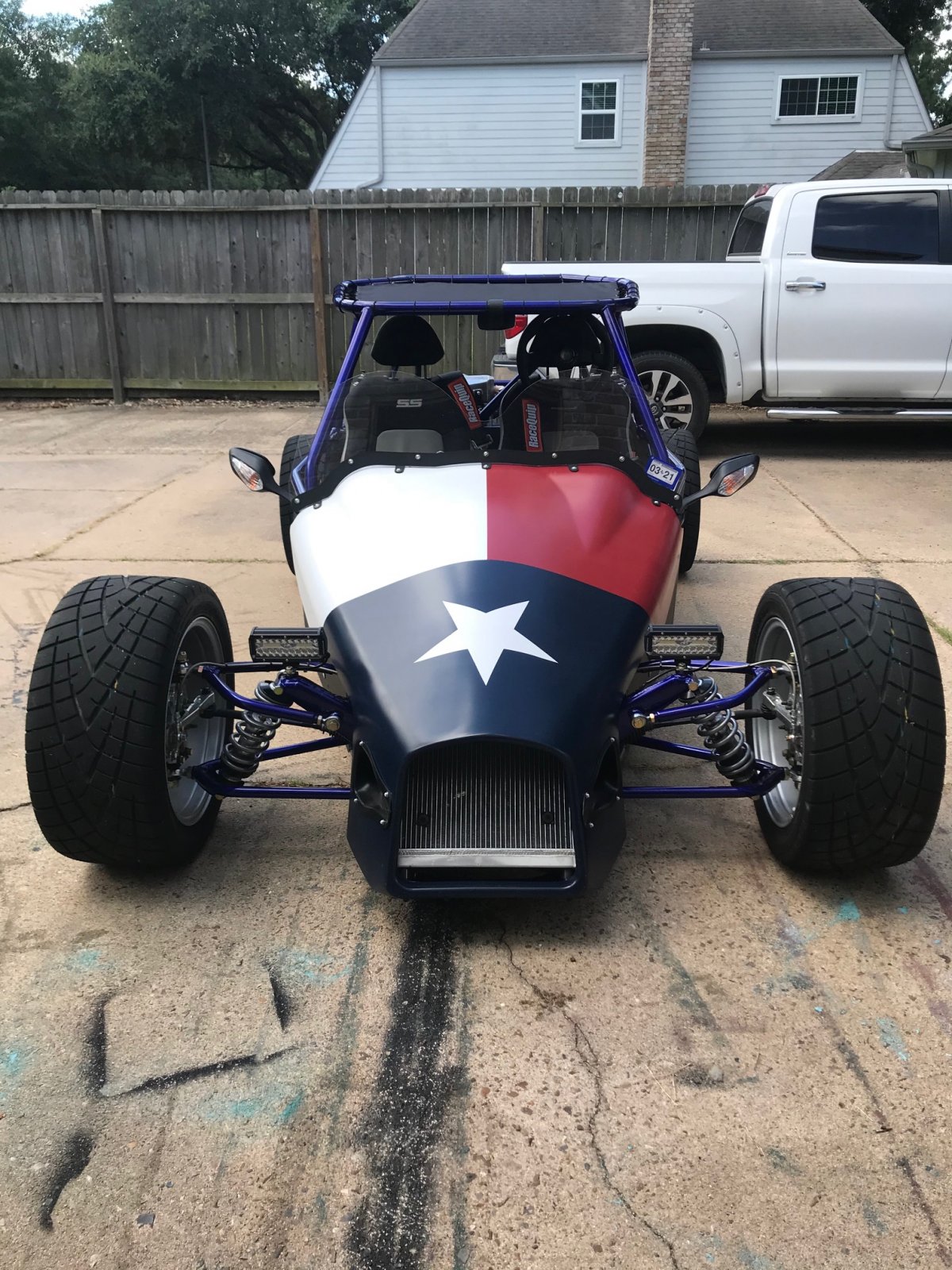

I’m looking into some custom lighting options but I want to draw it up on my computer to scale first. I need a clear, level, front end centered shot of a finished Goblin, with the camera at a few feet back and right about the level of the headlights.

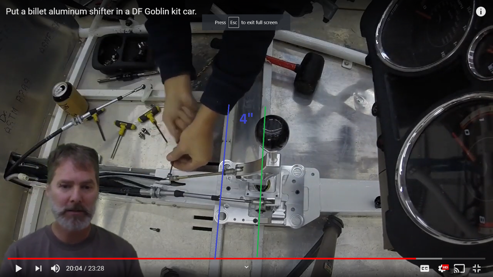

Also, I need to know approximately about how many degrees of angle the shifter is sitting at when engaged in 3rd gear. I know that does have some adjustment.

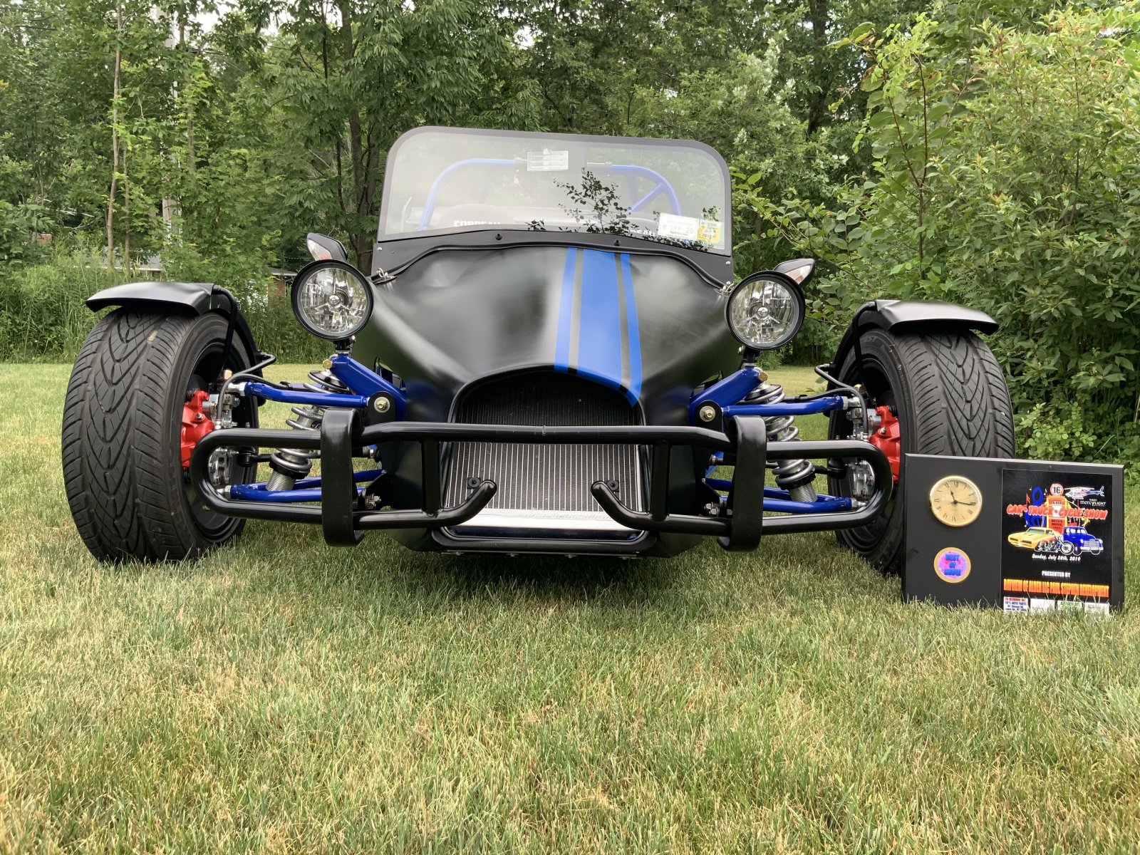

Good Afternoon,
Let me know if you need or want a different angle... 5 3/4” motorcycle headlights with actual DOT lenses...

My shifter in 3rd gear is roughly vertical. Originally I had neutral as vertical, but I found the shifter to be too far forward for my arm length, so I adjusted it towards me.
The RSX shifter I put in my Goblin is positioned at the same spot as the Cobalt shifter, with the center ball of the shifter (green line) 4" forward of the seat bar (blue line).
