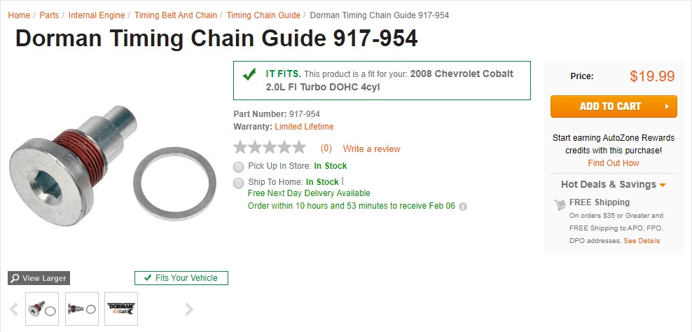

Speaking of "while you're at it...", also install one of these.
https://www.autozone.com/internal-e...man-timing-chain-guide-917-954/614853_0_37400
