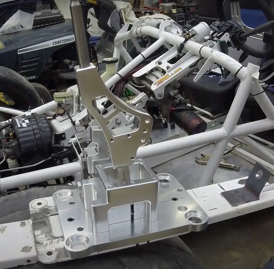

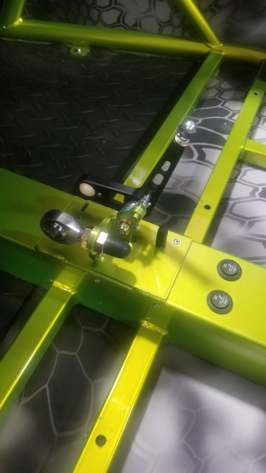

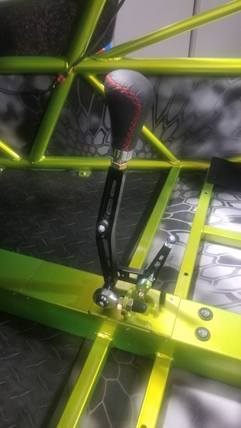

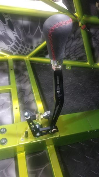

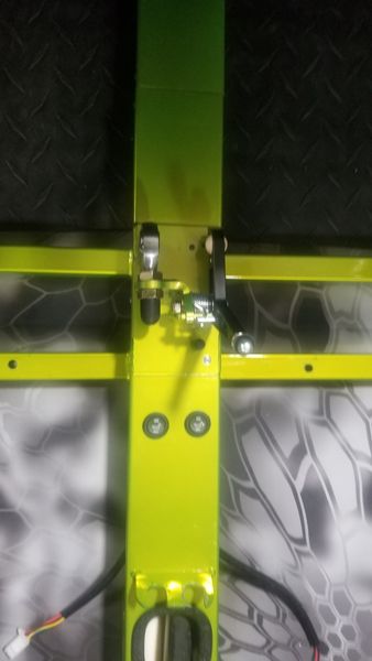

I am installing the first production D.F. Goblin Billet shifter in my Goblin. This shifter was designed by Lonnie specifically for the Goblin. Lonnie has been testing them in Adam's Goblin and the new Brandon Brown Goblin.....stay tuned for more pictures and reviews.
Happy to be the test dummy!
Thank to Lonnie and everyone at D. F. Goblin.
Oh those buttons on the tunnel cover? Ejector seats!!!.......Nah, just kidding I have heated seats those are for them....Its a pretty full tunnel with the intercooler lines, wiring harness, and the wiring bundle for the seats.

Hey, on the original shifter there is some side to side slop, like the entire base plate/mount/tunnel cap is moving. Since this is a new tunnel cap piece that the DF shifter is mounted on, do you notice any side to side play?
I haven't noticed any slop. Rather than the base rocking instead of the shifter like on the original Cobalt shifter setup, I feel like the DF upgraded shifter is just going into gear.
YoungGun
Good to hear. So the 3 piece tunnel cap that the DF shifter is attached to sounds like it's more solidly mounted onto the tunnel than the original shifter setup.
It's actually attached in the same way, it just has way less resistance to left/right movement. There's a centering spring on the new left/right linkage arm that seems very appropriately sized to do nothing more than center the main shifter arm left/right, offering no more resistance than is required. That's compared to the Cobalt shifter on top of the tunnel, where it seemed like everything about the shifter resisted movement in any direction
