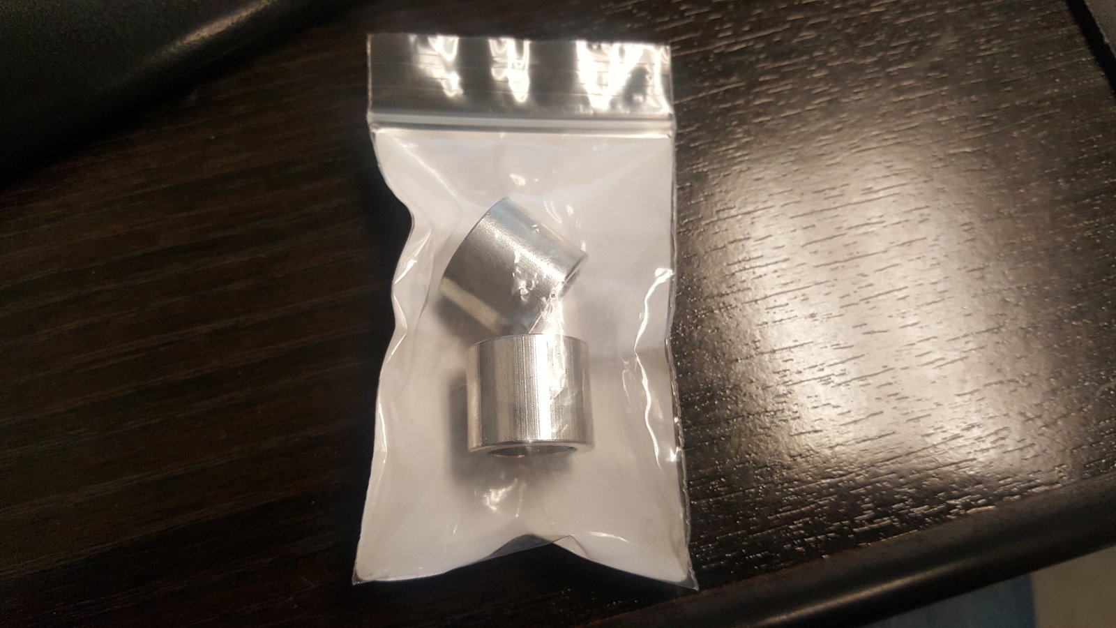

The SS kits now come with the following bag with two transmission mount spacers:
Base manual builds do not requires spacers. Automatic builds use three spacers.
The spacers will go between the chassis and the aluminum standoff that should already be bolted to your donor's transmission.
On the passenger side, all manual powertrains will use the rear set of holes. Automatics are the only builds that will use the front set.

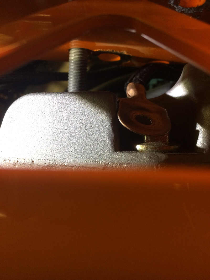

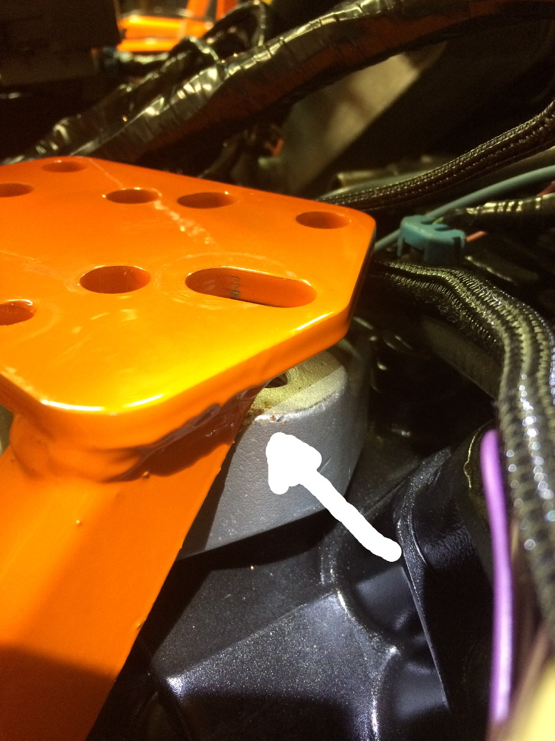

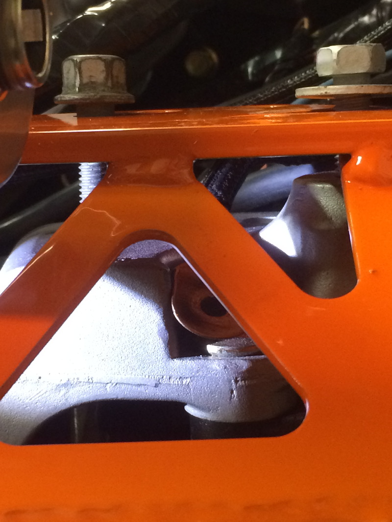

So we were trying to mount it up and I cannot for the life of me figure out the driver side. I have the two spacers and assumed they went in the front and middle position and the rear-most would lay flat against the plate. No such luck. The rear hole just will not fit without hitting the riser. I don't want to just cut and grind without finding out the correct way first.
Hits right here. If I slide it forward where it doesn't hit, then the other two holes don't line up.
I can't see below it to be for sure. I believe those are the same holes that I'm using but it just won't sit down on the transmission mount without hitting the riser.

I can get a pic from a different angle if you would like, I remember it being a little confusing first but in the end everything lined up just fine and didn't hit any part of the frame

No. I appreciate the thoughts. I will probably make a phone call to the trusted source. It's kind of at a standstill until I get this figured out. I don't mind modifying things but I don't want to jack with the engine alignment and be wrong.
You will need to clearance your frame and/or mount to allow those two surfaces to sit flat to each other with the bolts in.
Apparently there are different styles of that mount and yours is beefier in that area.
If you want to ship the mount to us we will clearance it and cover the cost of shipping it back.
Let me know if we can help.

I don't think so, mine was even broke and had to buy a new one. I could see how it would look like that at first glance though. if you zoom in on the pic I posted of the drivers side you can see one of the bolt downs for the mount

It didn't take a whole lot to grind off and then it fit well. I did have to push the two rear frame uprights apart to get the bolt holes to line up better which in the end worked out for the best. I measured the rear most subframe mounts and then measured the frame tubes they bolt to and they did need to move out just a bit to line up which made the engine mounts line up better also. Pretty happy with it now. I just wanted to make sure I wasn't doing anything wrong.
