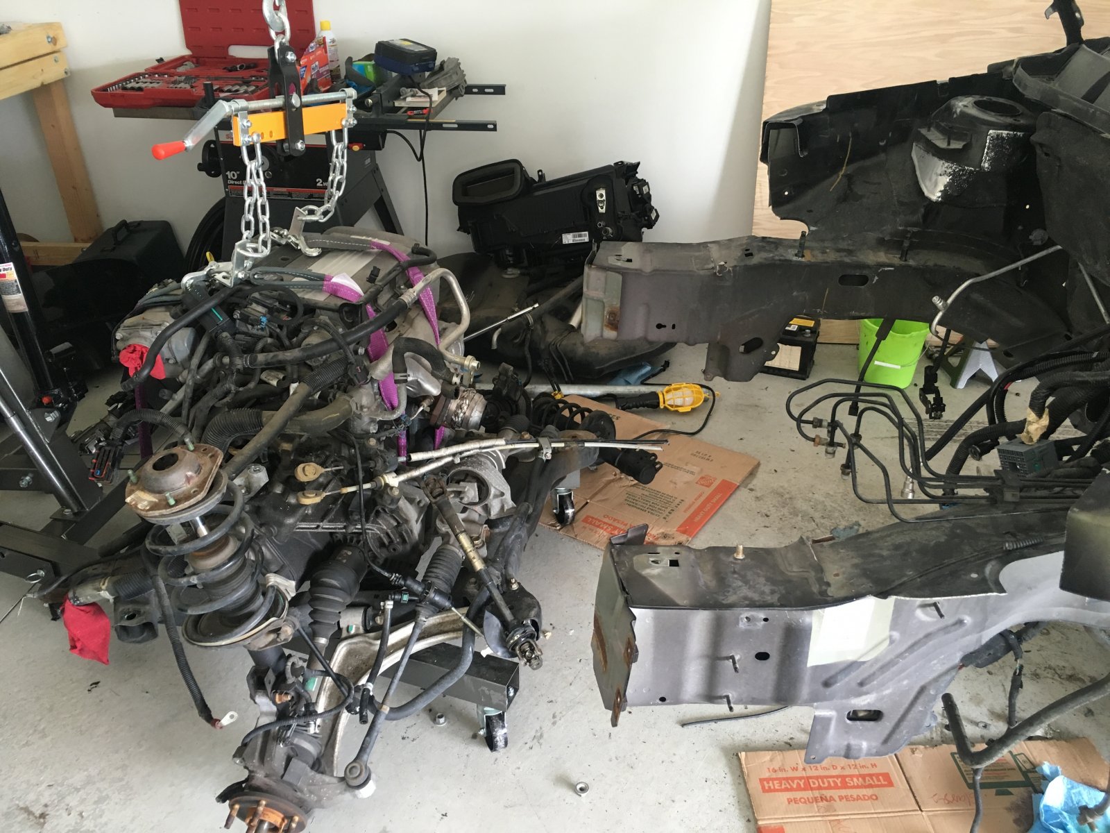

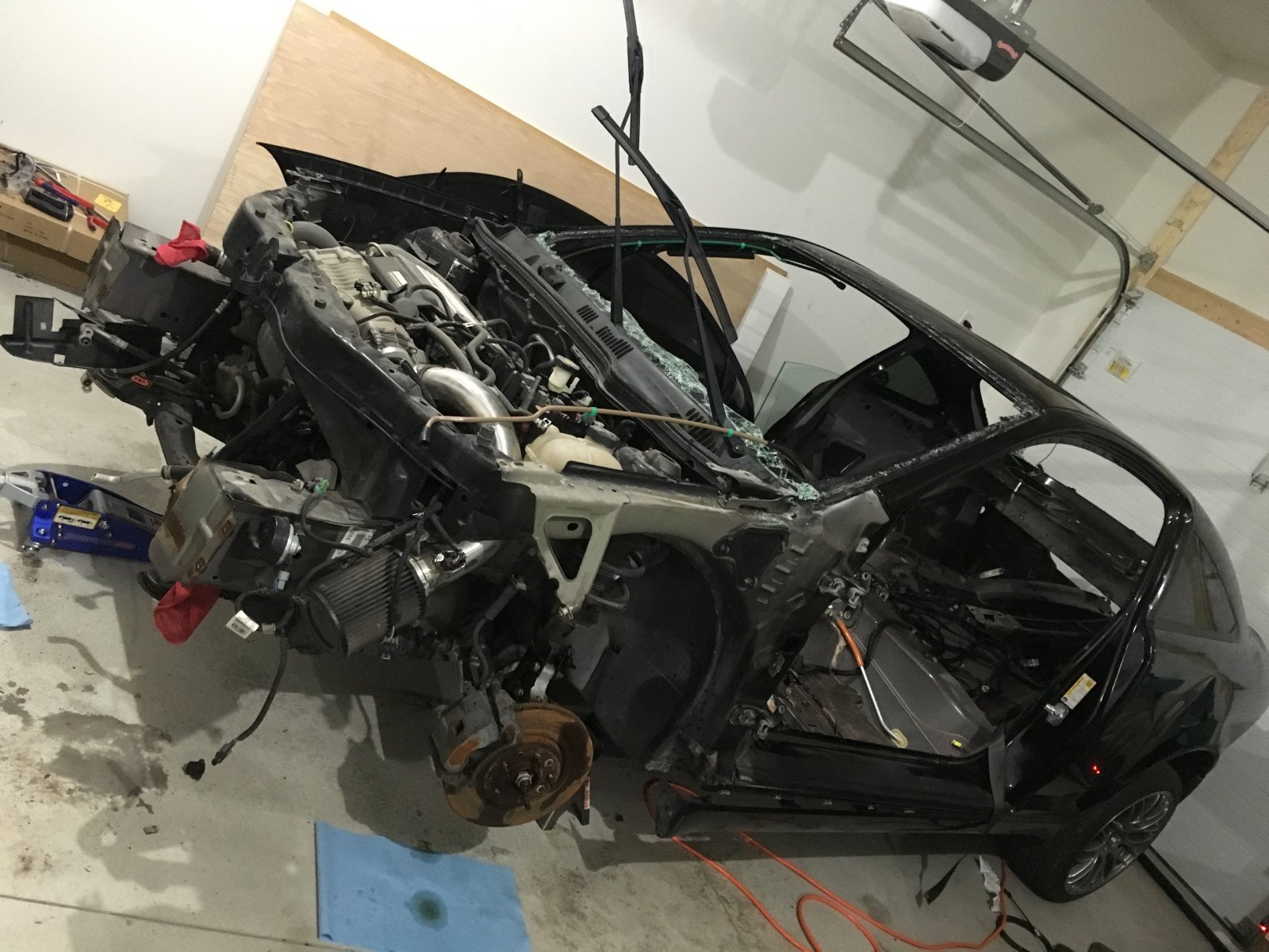

Hello everyone!
Donor is my garage and my little brother and I are starting to take it apart. Here are a few of the early shots from late last week. I'll upload some more current stripping shots later. No issues so far just working on figuring out how everyone comes apart.
I was really happy to see the passenger and both side curtain airbags are intact and in good shape!

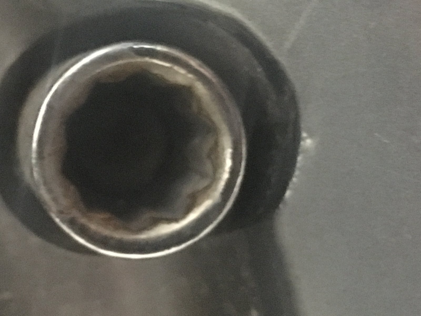

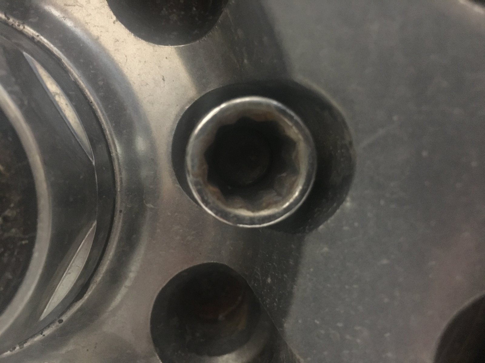

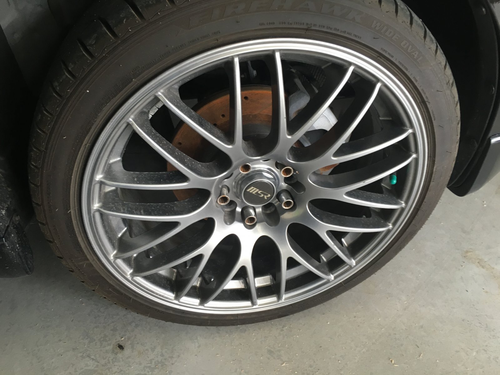

While we are at it can anyone help me identify these wheel locks? The previous owner put 5 on every wheel....
They look like tuner style lug nuts.
These look similar.
http://www.ezaccessory.com/Chrome_Acorn_Tuner_Lug_Nuts_p/2807.htm
TheNuker
Got it you were right, Think gosh for 1 day Amazon shipping!

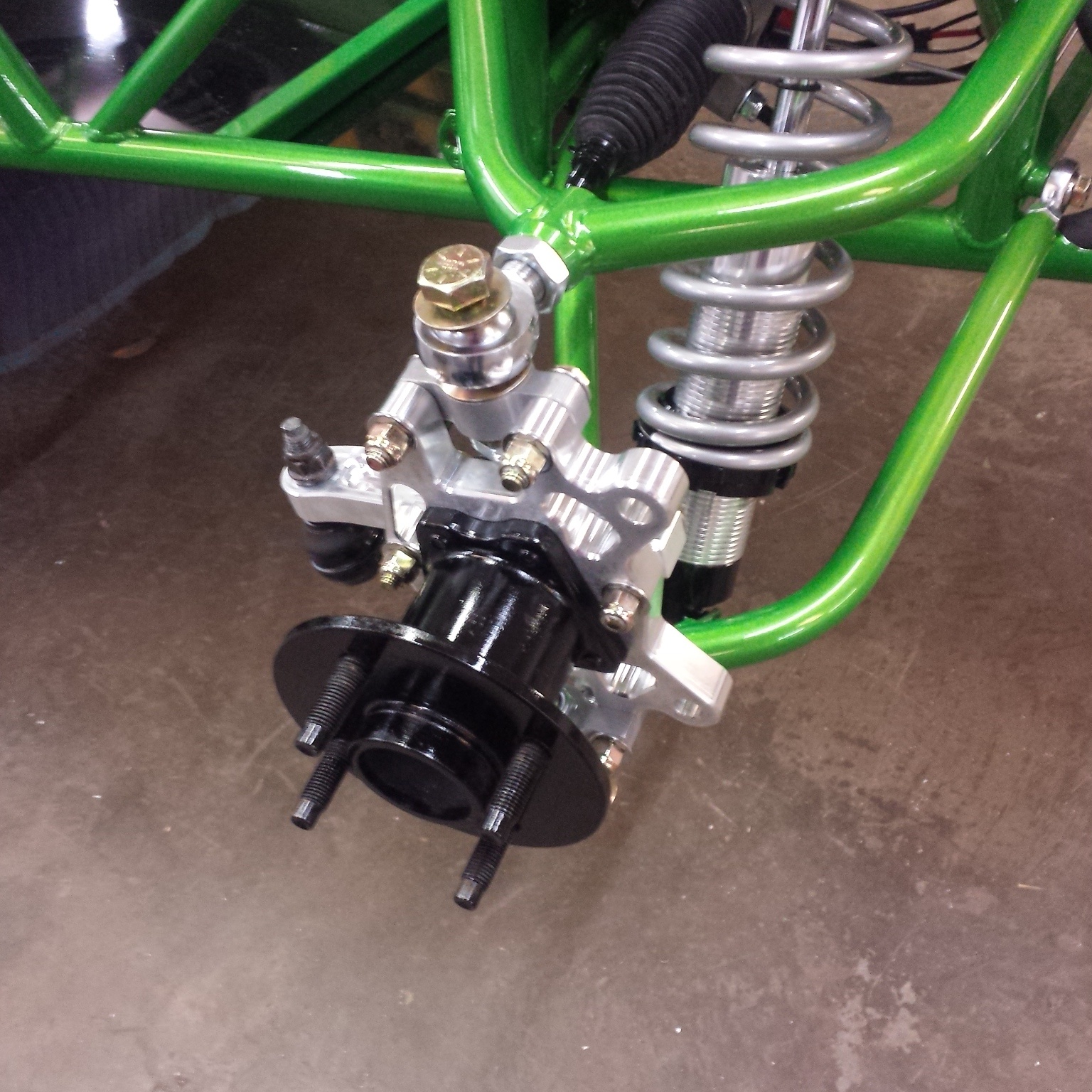

I have an 05SS/SC and the donor list said we needed to keep the rear wheel hubs. Pictures of the other goblins have custom front hubs, so why are we saving the rear hubs? Are you saving yours?
BAR-AIR
Good Evening,
The rear bearings are reused in the front of the car with the with the custom hubs supplied with the kit. Also the rear brake lines and some of the hardware can be reused. My donor had some corrosion so I didn't use anything from the rear of the donor (also made it easier to get it up on the flat bed.....) -bearings were relatively cheap and didn't want the ABS hardware anyway, I had single piece hydraulic hoses made for the front of the car.
BAR
The black bearing hub comes from the donor car. You need to keep the OEM nuts to bolt it up.
Everything else in the photo is supplied with your kit except for the steering rack, it also comes from your donor.

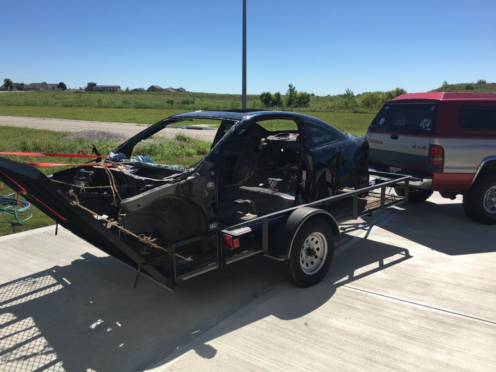

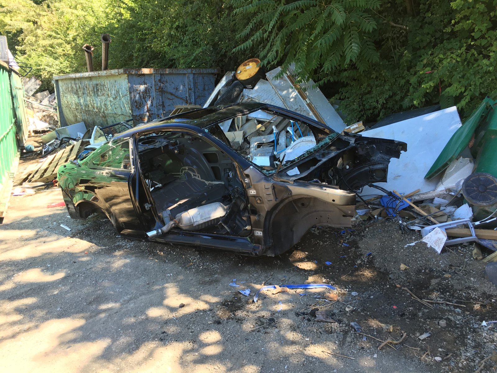

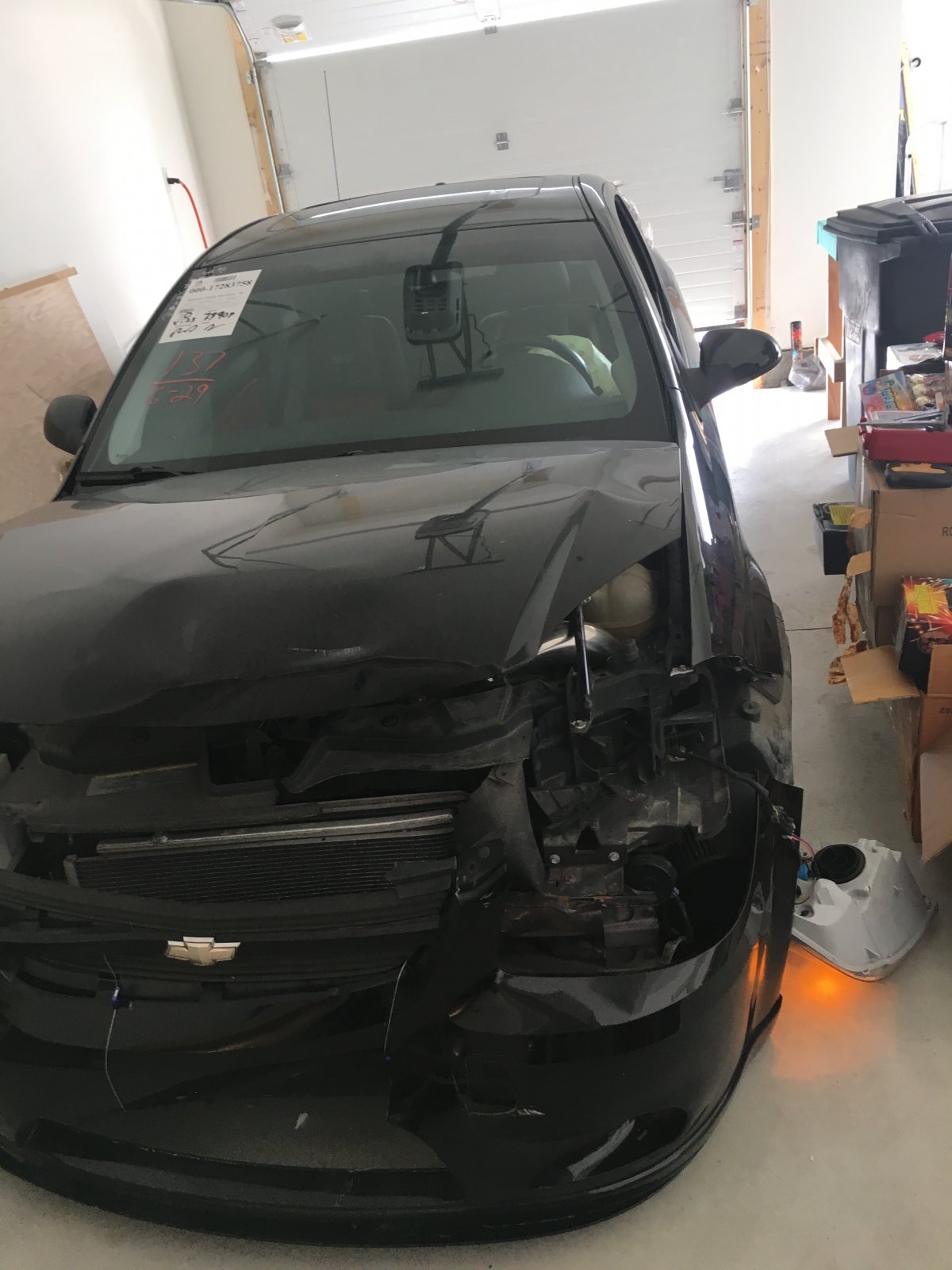

Car is finally gone! Glad to be able to start working on cleaning the engine and replace the gaskets and clutch etc....
That was a pain in the ass to get on the trailer! hahaha
