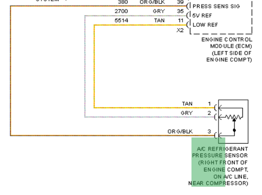

I also did some poking around. It's been so long since I did the wiring harness, I don't really remember what I did with the AC stuff. The car had AC, so the sensor was on the car at one point. I'll have to go look on lunch and see if the sensor plug is still on the harness or if I chopped it.
jirwin
Even if you chopped it off, the pins at the ECM should still be there and could be reconnected.
I assumed so as well. Found it in my wiring diagram... Just need to find it on the connector later.

Really the only disadvantage is you either have to keep the interface in the car attached to the signal wire, or tape off the signal wire when you remove it from the interface and remove the interface from the car. If you go straight to the ECM via the refrigerant pressure signal wire, you can remove the HP Tuners interface from the car whenever you want. But obviously that's a moot point if you don't have the pro interface.

I bought the AEM one linked above a few minutes ago. If it doesn't work I figure I'll just return it and go the AC route.
