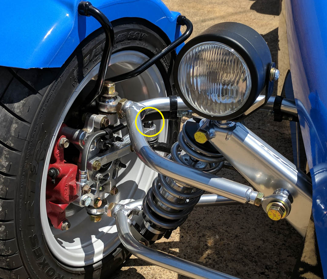

Need some advice. I was trying to reach 50ft/lbs and it went kind of loose before I ever reached the torque spec. Does anyone know what I did wrong and how to fix it? I was using the castle but and I hadn’t quite gotten to the point where I could insert the cotter pin before this happened.
So is your castle nut in the yellow circle?

If yes, then this ball joint shaft is tapered. Check that the billet aluminum piece has the taper going the correct direction for the steel ball joint shaft. It is possible to assemble the billet part upside down, or on the wrong side.
If your castle nut is inside this yellow circle

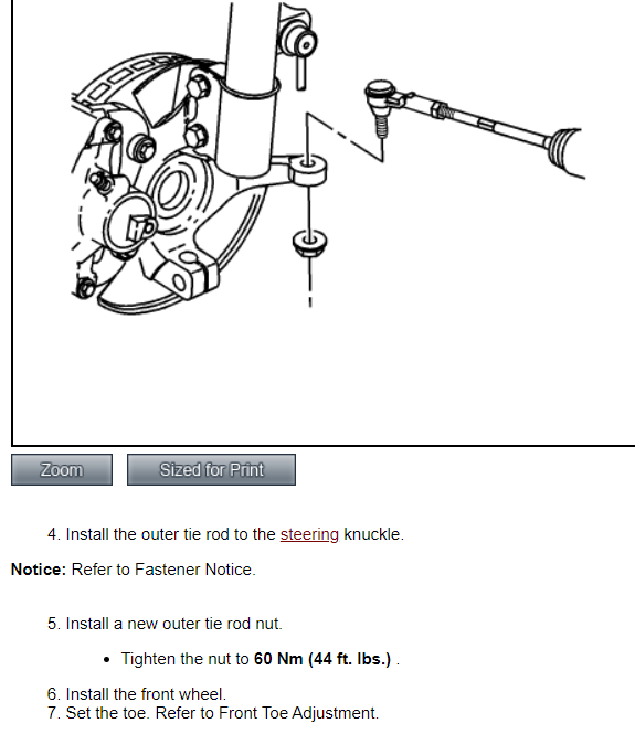

AllDataDIY says only 44 foot pounds, and that is for the cast iron Cobalt part.
The billet aluminum Goblin part might not even need that much torque.

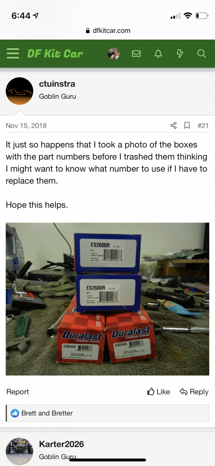

I had this same issue with the DF supplied ends and replace them with ends from Napa. The nuts kept stripping out. I believe that DF now includes better nuts.

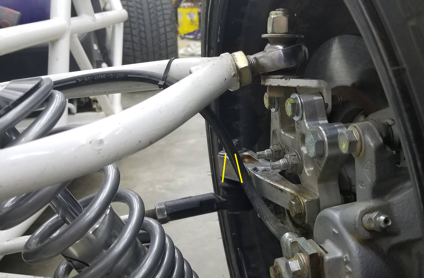

Had to grind off the castle nut because the threads stripped. I will have to use a tap/die set to rework the threads. I had the tapered end down for the steering arm. Is that the right way?
The smaller end of the taper goes towards the nut, which is actually on top.

Here I have exaggerated yellow lines showing the hidden tapered shaft.
