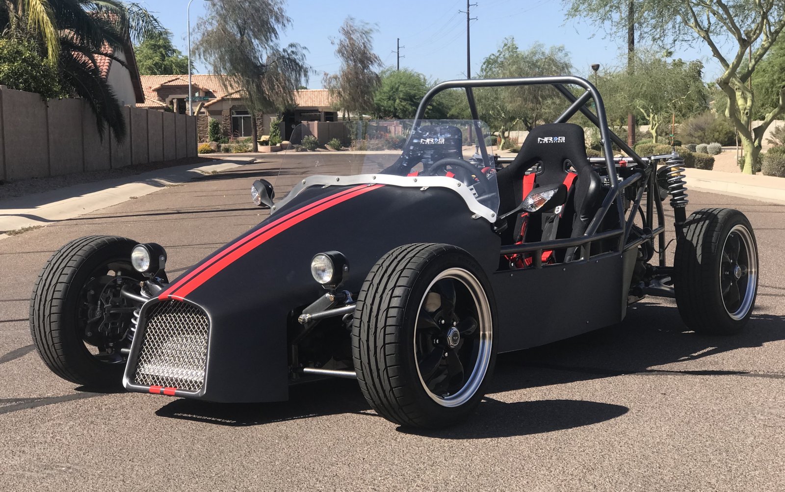

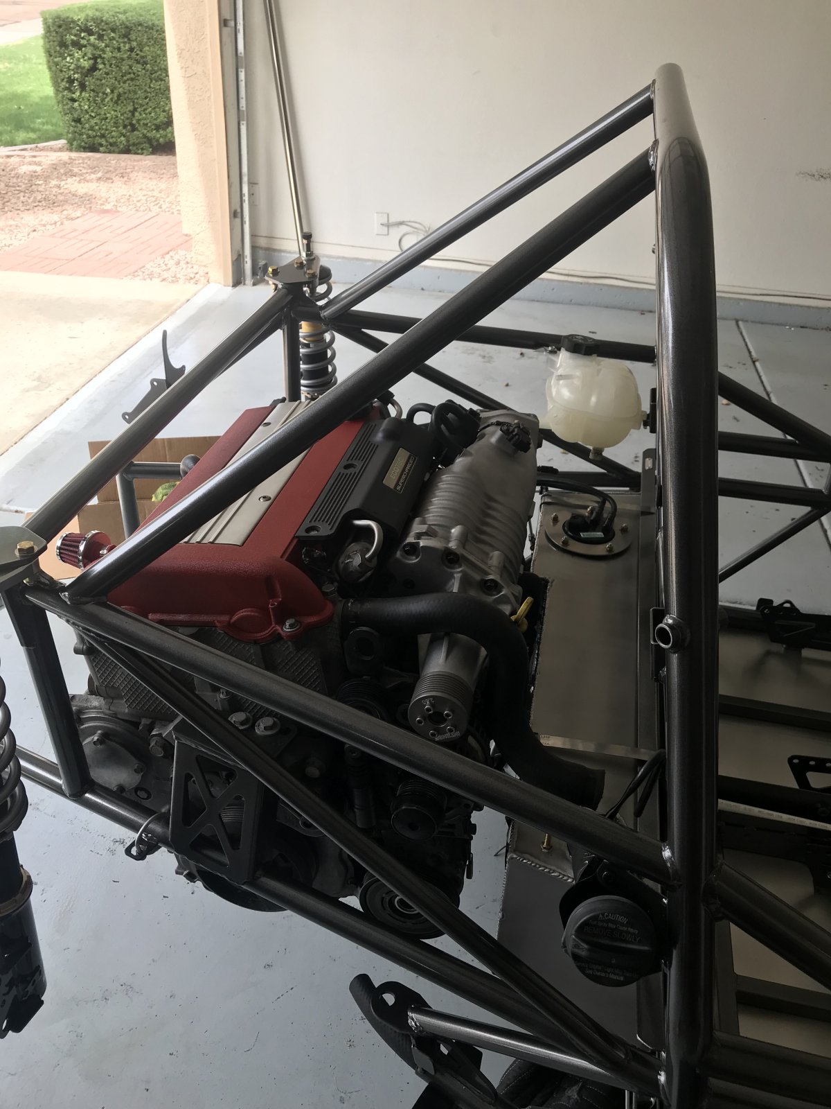

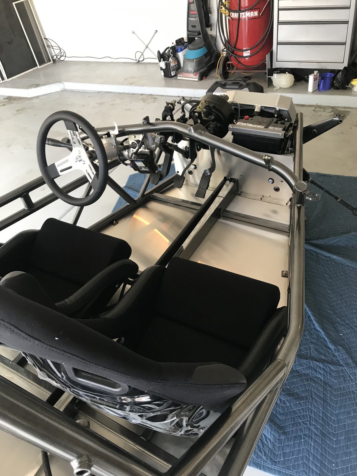

I left mine unpainted, and wiped it down with some ProtectaClear meant for uncoated metals. I did this with all of the aluminum panels on my car. I wanted a raw metal finish to most of it. Love it. It’s kind of a theme carried throughout the build. The car is also wrapped in a brushed metal finish vinyl.
askiles
Some pics...

Great looking car you've got there, Andy.
We also are leaving our sheet-aluminum items unpainted but the tank will be black (textured).

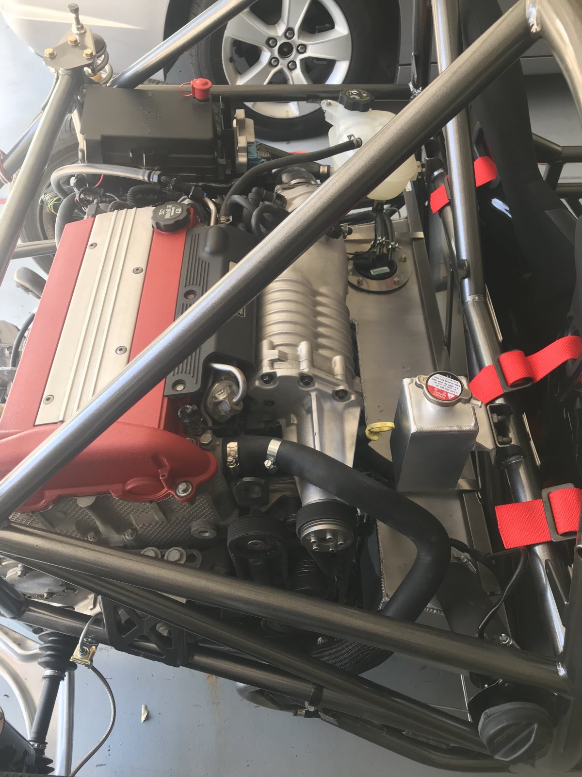

Am wondering how you did the routing of the coolant lines for your supercharger. My plans had included using the fitting with the filler cap (i.e., the fitting from the donor) in its stock location (i.e., attached to the sc snout) but am now realizing, after looking at one of your pics, that there's insufficient room for that.
I have the ZZP dual pass side plate so the routing is a little like spaghetti, but came out pretty good. I used as little hose as possible and short run, then I ran the hose to a small aluminum reservoir that I had my shop make up. You can see it in this pic...

Pics I've subsequently viewed indicate that there may be enough space for the above-mentioned fitting (which others call a sight glass) to be squeezed in after all. If true, our car's cooler plumbing will look a lot like what came off the donor. That is, until it connects to the DF-provided lines that run forward in the tunnel. No nice reservoir like yours but, here's hoping, good enough for now. Thanks!
